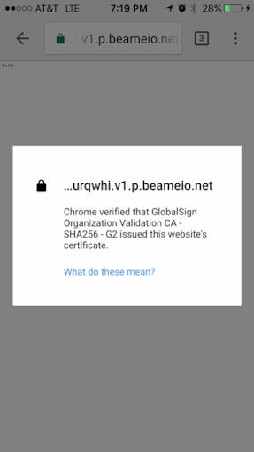

1Step 1Installing Raspberry Pi
To install the Raspberry Pi, you first need to download and install NodeJS (6.9.*). To do this, you will need to get SSH access to the Raspberry Pi and get the Pi on the network. We will not cover this here, but you can follow here.
ssh pi@myip curl -sL https://deb.nodesource.com/setup_6.x | sudo -E bash - sudo apt-get install nodejs node --version pi@raspberrypi:~ $ node --version v6.9.2 -
2Step 2Installing Beame.io
Then proceed to install
beame-insta-sslpi@raspberrypi:~ $Initially, it is easiest to receive your first set of credentials directly on the raspberry using an
authtoken from Beame.io.You can also generate these tokens yourself and authorize your own certs with
beame-sdkWe will cover this in the next tutorial, as well. If you will be using Beame.io in any serious fashion, you will want the root credentials to be somewhere else other than on the Raspberry, but, for now, this is the quickest and easiest way.
3Step 3Getting Your First Token
To get your first token, you need to go here and prove that you are not a bot. You will receive your token in the email:
# beame-insta-ssl create 'token from email'# beame-insta-ssl tunnel 8008 httpStarting tunnel https://qwertyuio.asdfghjkl.v1.d.beameio.net -> http://localhost:8008
4Step 4
At this point, all we need to do is put together a little project that does something. We will follow this example with an LED. To do this, we need to put together a little node.js service attached.
In this particular example, I have not created a webpage but rather just parsed the URL for the on/off.
~ 523 > curl https://cgqjqvahrdurqwhi.v1.p.beameio.net/on -v * Trying 52.57.114.229... * TCP_NODELAY set * Connected to cgqjqvahrdurqwhi.v1.p.beameio.net (52.57.114.229) port 443 (#0) * TLS 1.2 connection using TLS_ECDHE_RSA_WITH_AES_128_GCM_SHA256 * Server certificate: cgqjqvahrdurqwhi.v1.p.beameio.net * Server certificate: GlobalSign Organization Validation CA - SHA256 - G2 * Server certificate: GlobalSign Root CA > GET /on HTTP/1.1 > Host: cgqjqvahrdurqwhi.v1.p.beameio.net > User-Agent: curl/7.51.0 > Accept: */* > < HTTP/1.1 200 OK < content-type: text/html < date: Tue, 03 Jan 2017 00:16:17 GMT < connection: close < transfer-encoding: chunked < * Curl_http_done: called premature == 0 * Closing connection 0 curl https://cgqjqvahrdurqwhi.v1.p.beameio.net/off -v * Trying 52.57.114.229... * TCP_NODELAY set * Connected to cgqjqvahrdurqwhi.v1.p.beameio.net (52.57.114.229) port 443 (#0) * TLS 1.2 connection using TLS_ECDHE_RSA_WITH_AES_128_GCM_SHA256 * Server certificate: cgqjqvahrdurqwhi.v1.p.beameio.net * Server certificate: GlobalSign Organization Validation CA - SHA256 - G2 * Server certificate: GlobalSign Root CA > GET /off HTTP/1.1 > Host: cgqjqvahrdurqwhi.v1.p.beameio.net > User-Agent: curl/7.51.0 > Accept: */* > < HTTP/1.1 200 OK < content-type: text/html < date: Tue, 03 Jan 2017 00:16:45 GMT < connection: close < transfer-encoding: chunked < * Curl_http_done: called premature == 0* Closing connection 0
6Step 6Whats next?
Authorize the creation of your own SSL certificates and their deployment. The beta of the Beame.io mobile app allows your Raspberry to recognize the client certs or possession thereof. If you have any questions, please contact us at our Github page through the issues section!
Sophia Tupolev
Become a Hackaday.io Member
