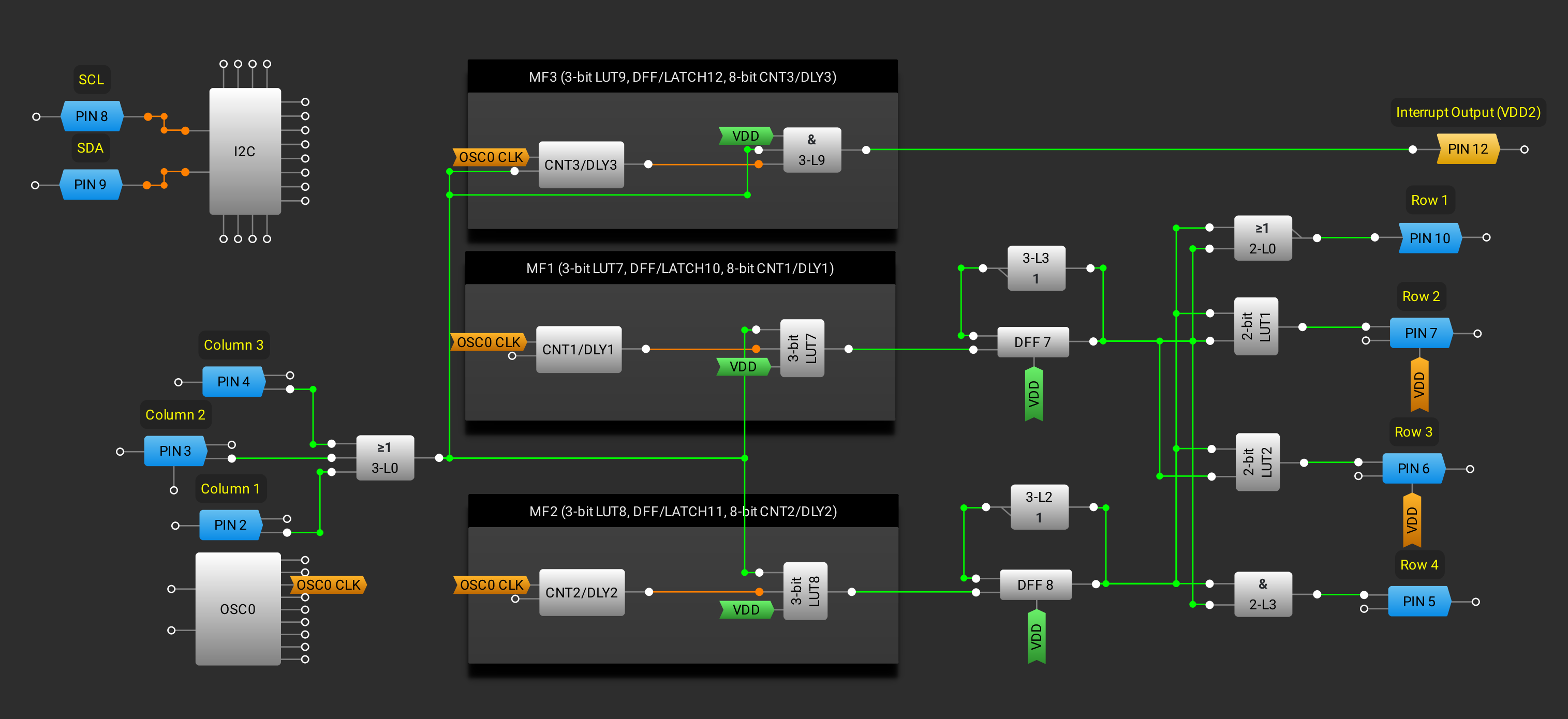

    After thinking a bit ahead a 1.8 Volt MCU is the way to go, that is why I've decided to separate the gate-driver and keypad scanning. This way I can add the power on reset for the gate-driver and also add the handset switch which will cut the opto-coupler pwm outputs to the h-bridge effectively cutting the bell ringing. Of course it has to be fixed in code as well.
    The VDD2 of the SLG46826 can do 1.8 volts, using this to my advantage I could run the mcu at 1.8 volts. Use VDD2 pins for connecting to the MCU. Reducing the need of level-shifters to just one I2C level-shifter.

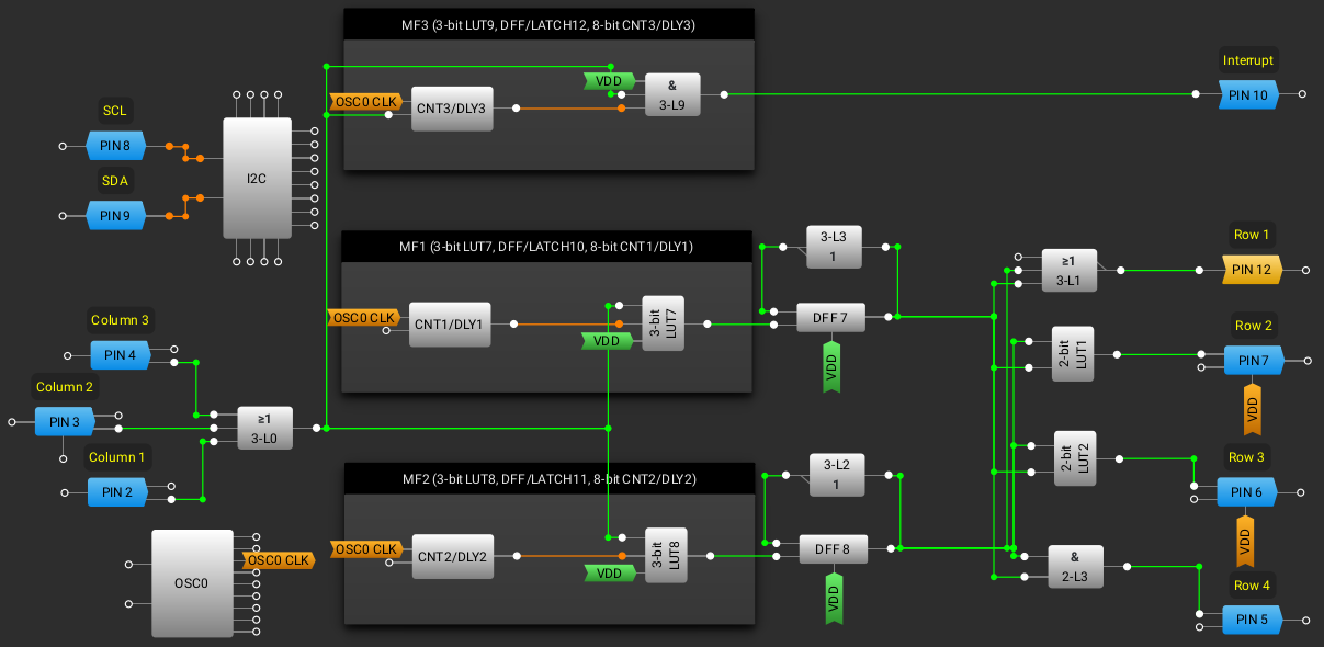

    Keypad scanning greenpak now looks like this. VDD2 pins are yellow.
    Interrupt pin from the keypad scanning could be set to 1.8 Volts, the row and columns could be 3.3 volts.

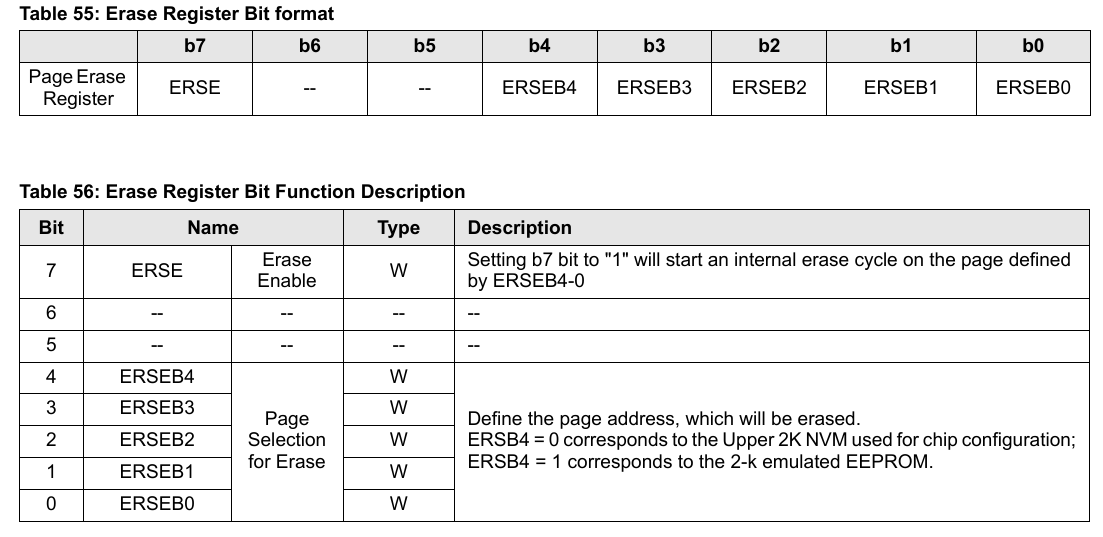

    There are many ways I could just keep going with my project, use an additional SLG46826V module or just skip the OVLO but I want to find out why I can not write the first byte.

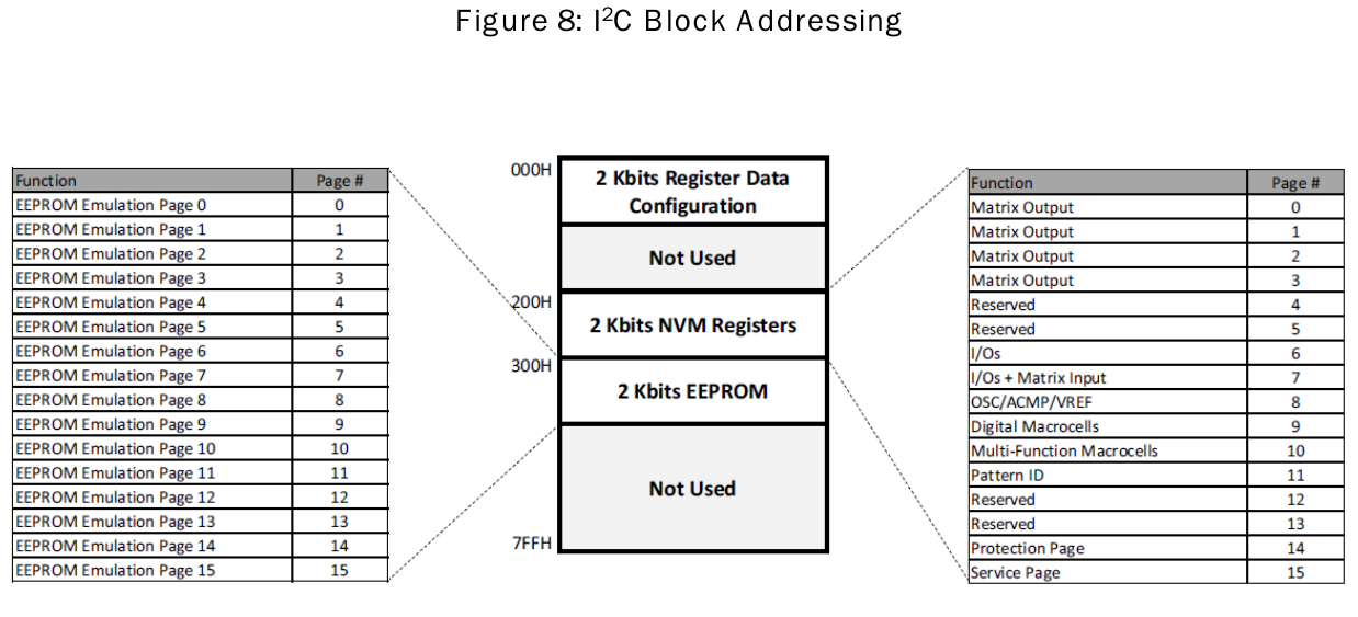

    Like before I can not write the first byte of the SLG46826V greenPAK module.
    Now why doesn't it work?
    The LDO supplies stable power to the greenPAK and the decoupling caps are close to both VDD's. I noticed that there are small tiny decoupling caps on both VDD's on the module itself. Thus my extra caps are really not needed.
    Datasheet says "The VDD pin requires a voltage ranging from 2.5 V to 5.5 V for Programming and Erase operations." I read 3.28 Volts.
    It's only the first byte, I before tested to write all pages backwards same problem.
    I tried flashing the NVRAM as well and did an hard reset, didn't work. Since the LUT has not be set up I have no interrupt at all.

    I looked at the programmer and noticed that I had a 0.01uF decoupling cap for the mcp2221A so I switched that to an 0.1uF. Just to make sure there is no issue there.
    I soldered a new slg46826V module and I have the same problem with that one, first byte can not be written to.
    I'm pretty sure that it is a problem with my programmming. But I wrote the pages backwards and I had the same problem. There is perhaps a problem when setting the page address for page 0x00.
    I'll refactor the greenPAK tool code and make a cli interface for it. Hopefully going through the code I might find the problem at least I will have a more easy to use programming software.

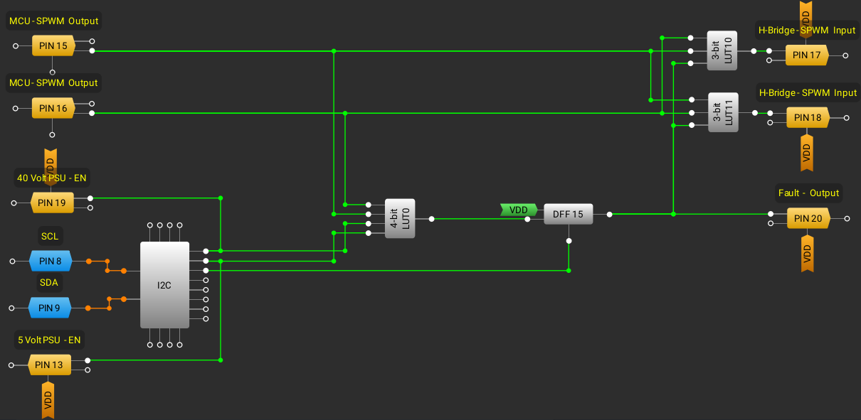

    Here is the new greenPAK design. I were able to get the check for over-voltage in there as well.
    Like before it is not possible for both sPWM channels to be on at the same time. This would also latch the fault DFF. If a fault is latched the sPWM outputs can not drive the gates again until the fault is cleared.
    Under or over voltage also latches a fault using the ACMP's to measure the voltage. Both ACMP's are powered by the same signal that enables the 5 Volt rail. The outputs of both ACMP's can be ignored using a I2C register. This is neccessary to not get a fault when turning on or off 40 Volt PSU. During power up/down the outputs will be filtered out using the LUT when the register is set.
    The 5 volt EN signal is turned on, it also power the ACMP's, then turn on the 40 Volt PSU, check the UVLO ACMP that power has been established, then clear the acmp signal ignore and it should be ready for sPWM.
    To free up the pin needed for the voltage sense, I made the fault interrupt share the keypad matrix interrupt pin. This also have to be addressed in programming by using I2C to check if it's a Fault that triggered it or not.
    Using a macrocell with a DFF that has both nRESET and nSET for the fault latch. I can trigger a fault at anytime via the Virtual I2C register. It could be used for testing so I put it in there.

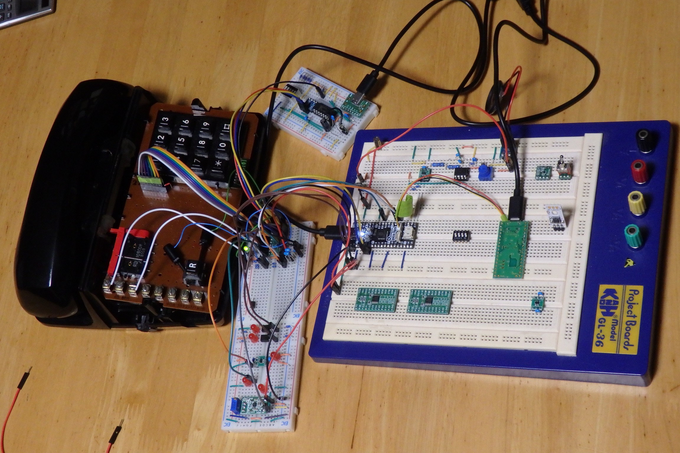

    I've decided to skip the reading of the voltage from the 40 Volt PSU and use that pin as a fault output for the H-Bridge control. Now all the pins of the GreenPAK(SLG46826V) are in use. I'm now using a virtual input register in the GreenPAK to control the 40 Volt PSU and the MCU pin originally intended for this purpose has become the fault interrupt input.
    I connected it all up and it looks like this. The added test circuit breadboard with the LED's and lots of wires.
    The TPS module is set at 5 volt to power the H-Bridge and 40V PSU.
    Opto-couplers with 1k pulls ups are powered from the TPS module. They are controlled by the greenPAK.
    The load switch will be a stand in for the 40V PSU with a LED.
    Before I mentioned I would use a load switch for the H-bridge but since there is nothing to power there except for the pull ups, I've decided to use the EN pin on the TPS module instead. It's EN is sinked to ground by the GreenPAK to turn it off.

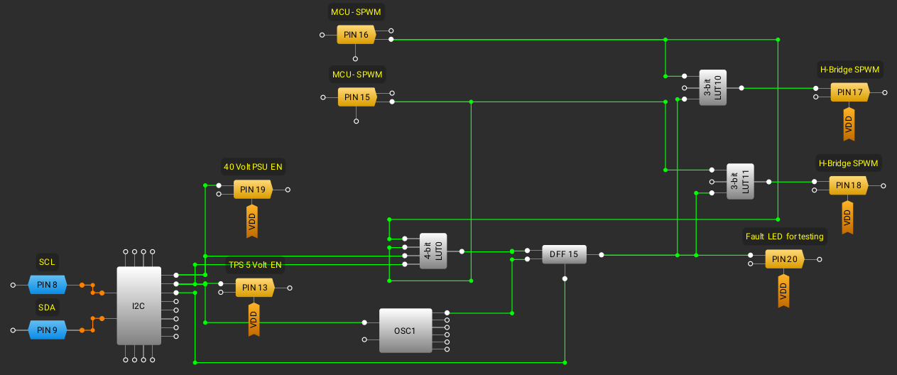

    Here is what the H-Bridge gate driver GreenPAK design now looks like.
    First the two 3-bit LUT's takes the MCU SPWM signals inverts the signals and outputs them to the H-Bridge gates. They also make sure that both signals can not be on at the same time. The fault signal is also sent taken into account as an extra safety, if a fault has been latched it can not drive the gates.
    The 4-bit LUT takes both MCU SPWM signals, TPS EN signal and the 40 Volt PSU signal. This makes it not possible to drive the gates without the 40 Volt PSU on. A DFF is connected to the output and if it's HIGH it will latch until cleared using the I2C controlled register.
    I noticed that the LED's I used have inbuilt resistors(for 5volts) on the positive side(anode), with the 1K pull up acts as a voltage divider. Using these kind of LED's for breadboarding should probably be avoided, when they make a voltage divider when you don't want one.
    Programming the new functionality. I've decided to make a general read_virtual_input_register and write_virtual_input_register. So it's easy to use these registers, there is 8 in total.
    I added the new simulate call state and some other code to make that work. I had to debug some code and fix some issues. Commands for resetting the fault condition and simulate a call have been added. I also added so I can access all the virtual input registers as well for testing.
    At first it didn't work like it should and it was because I had configured the 4-bit LUT the wrong way. Since I used this test circuit and not the live H-Bridge, no magic smoke event occured. After I reconfigured the 4-Bit LUT it started working as it should.
    I tested all the logic of the 4-Bit LUT and Injected 3.3 volts on each of the sPWM signals from the MCU to test the shoot-through protection. The H-Bridge gate driver works like it should and should protect the H-Bridge from blowing up.

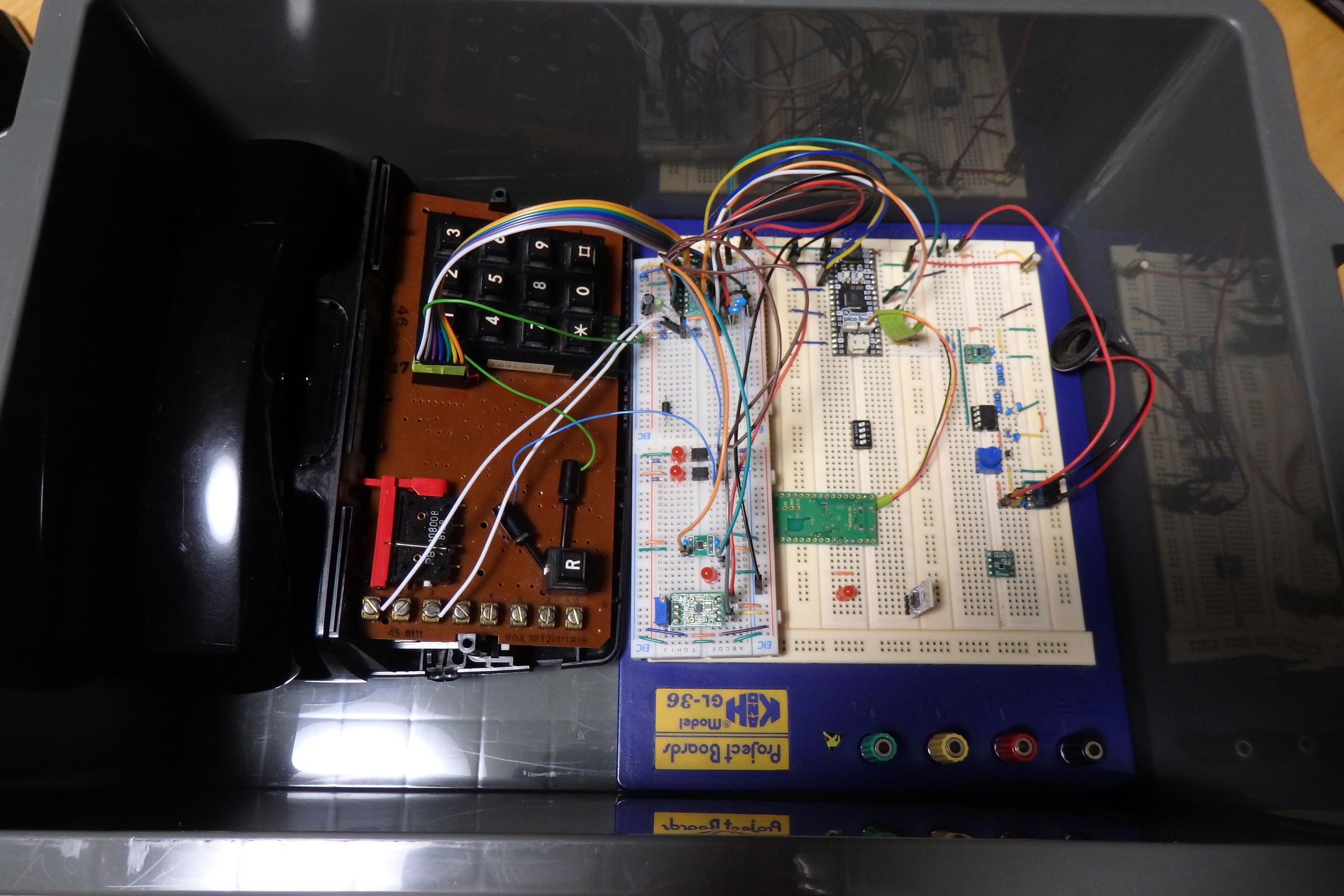

    To implement my H-Bridge gate driver in the GreenPAK I have to have a test circuit. I've decided to wire it up on a small breadboard.
    A 5 Volt PSU will power the 40 Volt PSU and H-Bridge opto-coupler pull-ups. A load-switch will turn on a LED and is a stand in for the 40 Volt PSU. The will opto-couplers are connected to LED's as well. I will be using a pin as output for the fault and it will turn on a LED.
    Here is the design for the gate-control in the GreenPAK.
    Here is how this should work. The 4-bit LUT checks the output signals, 5 Volt supply EN and 40 Volt PSU EN.
    It outputs a 1 if both SPWM channels are on at the same time, it also checks that the 40Volt PSU has been turned on and that the 5 Volt supply is also on. The 40 Volt PSU can not be turned on before the 5 Volt PSU this will also register a fault.
    It's latched by the DFF until reset by the MCU via one of the I2C virtual output registers.
    The SPWM LUT's inverts the logic and if it has a fault signal locks both channels so they make sure that the H-Bridge is off.
    The PSU's are also controlled by the MCU via the I2C virtual output registers.
    Now to test this design I have to wire up the test board and do some programming.
    I'm going to make used of the command mode of the phone. Fault reset command, would reset the DFF if a fault has occured. Bell ringer test command, when this command is activated and the handset placed back on, a timer starts and executes a simulated call by ringing the bells until the handset is picked up.
    With a test circuit there is no risk of something blowing up, while implementing the new Bell Ringer control.

    I suspected that the document "In-System Programming Guide for SLG46824/6/7-A", that specifies some whole pages as reserved is wrong. Looking through the register definition in the datasheet there are some configuration that exist in the excluded pages 4 and 12. Perhaps that table was just for the SLG46824?
    Including page 4 and 12 in the erase command fixed the problem and I could flash it properly.

    The GreenPAK keypad scanning design with the new pinout looks like this.
    The columns share the same LUT and to keep it simple and just one I2C read to get the key pressed. I'm reading 3 bytes. Byte 0x74, Byte 0x75 and Byte 0x76. These contains the matrix inputs and LUT outputs used.
    These are used to determine which key was pressed. Since I don't change the pinout often. I'm just going to update the code with the new pinout, it's just simpler. I updated the bitmask with the new setup for the column pins, for the rows I were reading the LUTs already so nothing have changed here. It now works again. I've flashed the new design onto the GreenPAK.
    My erase command doesn't seem to properly erase the device. The new code and pinout works if I write directly to the registers.
    If I use my NVRAM erase, flash and then reset the device it doesn't work. I'm guess my erase command does not erase all of the NVRAM properly. I have to go through and get the NVRAM erase to work properly. I have to write some debug features to read and compare the NVRAM and registers.
    So it wasn't a problem with the schmitt triggers, so I put them back on the column inputs and tested it. It works perfectly and might even be more robust with the schmitt triggers on the column inputs.

    With the now blank GreenPAK I decided to flash my new design. I powered everything up and it didn't work. I check the debug messages and interrupt from the GreenPAK didn't latch.
    I remembered that I had added schmitt triggers on the column inputs, so I removed them again. Back to flashing, now I erased and accidentally flashed the old project file again. That was wasteful. I should have written to the registers instead to test.
    I wrote the new design to the registers and the interrupt was working again. However when I pressed the keys, it's not playing back the correct key tones. Why?
    Well, I forgot about the way it works, the GreenPAK sends an interrupt when a key is pressed. The MCU gets this and reads which key is being pressed through reading the registers of the GreenPAK over I2C. Instead of reading the LUT's I set it up to read the pins. Now this was a bad choice as the pinout has changed.
    I have to rewrite the code for this. I'm going to have it read the LUTS directly instead. Time to read the datasheet again.
