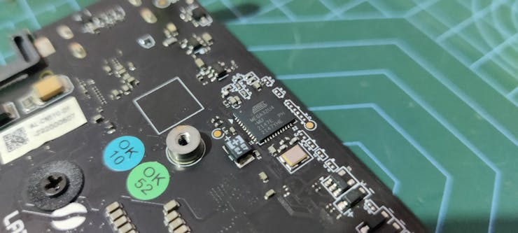

Greetings everyone and welcome back, This little project demonstrates how to use the onboard Atmega32U microcontroller of the LattePanda 3 Delta to create projects and operate various sensors, modules, electronics components, ETC.
Here, we are using the LattePanda 3 Delta, which has an onboard Atmega32U similar to those found in the Arduino Leonardo and Mini. The user can attach jumper wires to the controller's IO Pins by using the right female header pin connector that is provided.
In order to simplify things and keep things neat, we created a special breakout board that sits over the Latte Panda header pins and breaks down all of the I/O pins. With this board, we can power a wide range of electronics, including sensors, LEDs, resistors, and mosfets.
This project is about the construction process of the breakout board and how we can use the onboard Atmega32U microcontroller of the Latte Panda.

Now comes the main part: An Atmega32U processor, the same microcontroller found in the Arduino Leonardo and Arduino Micro development board, is another distinctive feature of the Lattepanda 3 Delta. Here, we may upload code into the Atmega32U to directly control it using the Arduino IDE.
Using the included female header pins, the user can attach modules, LEDs, and various electronics to the setup.
