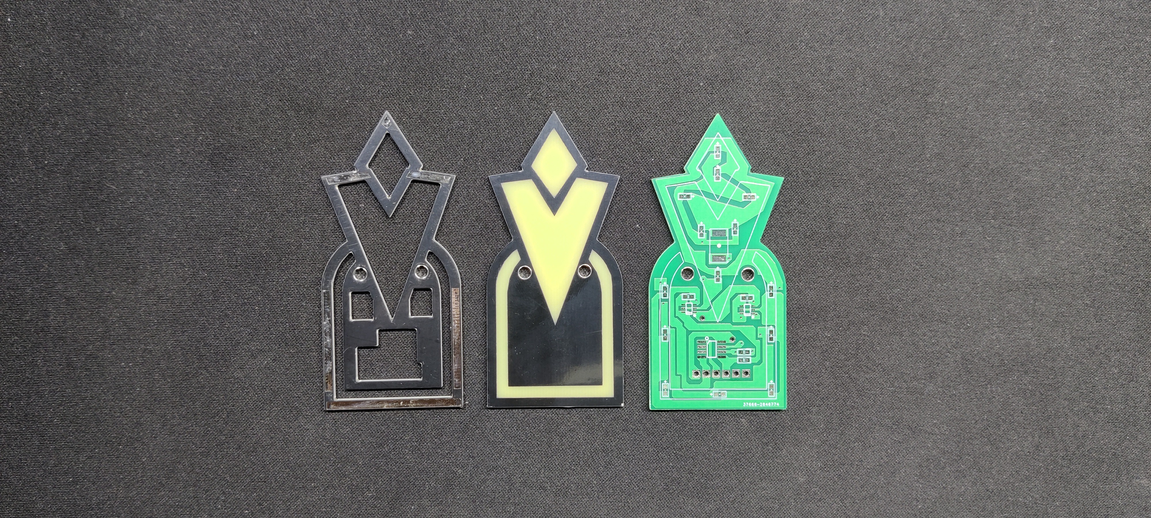

Here, the entire marker body has been constructed from PCB layers. Three separate PCB layers make up this project: the diffuser layer is on top, the middle layer adds height, and the bottom layer contains the component.
LEDs have been added to the bottom layer, and their glow is visible through the top layer because the solder mask top and bottom of the top layer have been opened from the area directly in front of the LEDs, allowing light to pass through the FR4 material of the PCB.

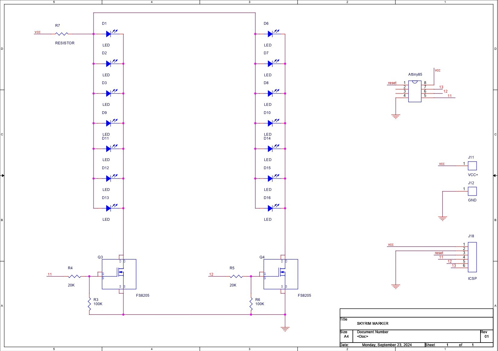

PCB Design: Schematic
The first step in this project is to put together a schematic for the base layer,, which is an Attiny13A connected to two 8205S Mosfet IC Setups via 20K resistors, each of which is connected to the D0 and D1 I/O Pins of the Attiny13A.
Here, the mosfets are configured in "Mosfet as Switch" Setup.
In order to keep the gate pulled down when the MCU is not receiving any signals, we have also put two 100k resistors between the mosfet's gate and GND.
Seven LEDs have been added in parallel to each mosfet IC setup. The anode of each LED is connected to the setup's VCC via a 3R3 load resistor. All LED cathodes are connected to the transistor's drain.
We also added a CON6 terminal, which will be used as an ISP programmer for flashing the ATtiny13A with our previously built Arduino as ISP programmer.
We have added the ATtiny SPI pins, MISO, MOSI, and SCK, to the CON6 terminal along with the reset, VCC, and GND pins.

We created the top and mid layers, which are devoid of any components or traces, once the bottom layer was finalized.
Reusing the Skyrim Quest marker image from the bottom layer board, we first prepare the Mid Layer board, which had multiple slots and openings.
The board slot layer was used to completely open the white area in the image, which is where the LEDs will be placed.
A few slots have been added to the middle, where the microcontroller, resistors, and Mosfet IC are located, so that the Mid Layer board can be positioned on top of the bottom layer without coming into contact with the components.
On the top board, we added solder mask openings in both the top and bottom layers, which will allow the light to pass through the FR4 material.

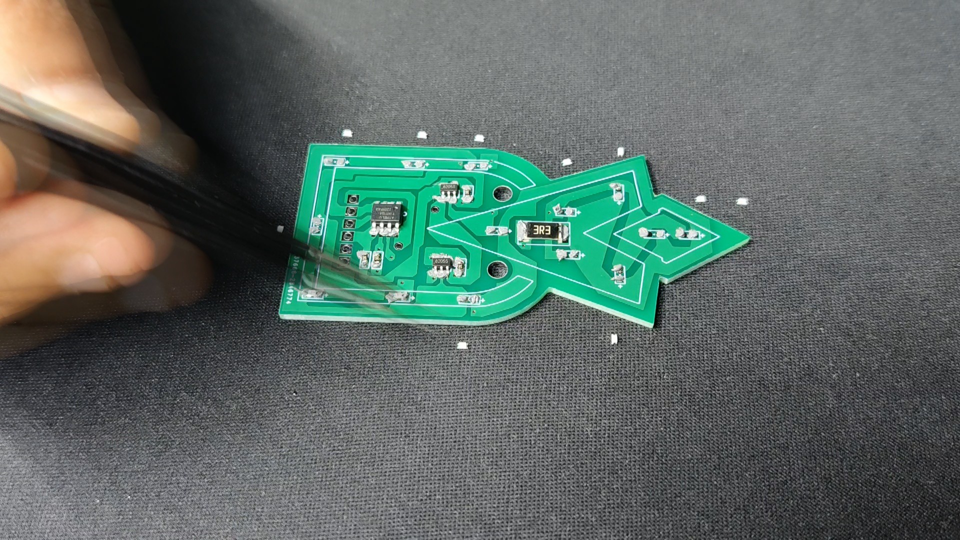

    • We started the PCB assembly process by applying solder paste to each component pad using a solder paste dispenser.
    • Next, we use an ESD Tweezer to pick and position each component one at a time in its proper location.
    • After that, we set the board on the reflow hotplate, which increases the temperature of the PCB from below to the point at which the solder paste melts. At that point, all of the components are connected to their pads.
    • We use a multimeter in diode checking mode, to check if the LEDs are connected to their pads correctly. We connect the positive probe to the LED's anode and the negative probe to the LED's cathode. This causes all of the LEDs that are connected in parallel to light up, indicating that the connections are correct.

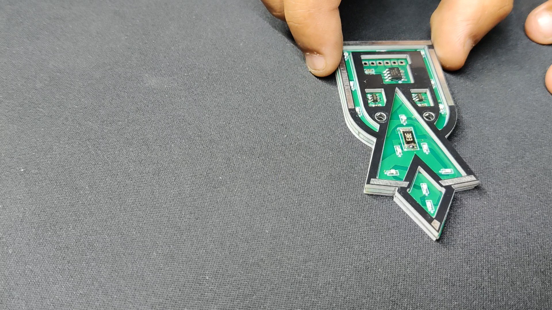

    LAYER Assembly Process

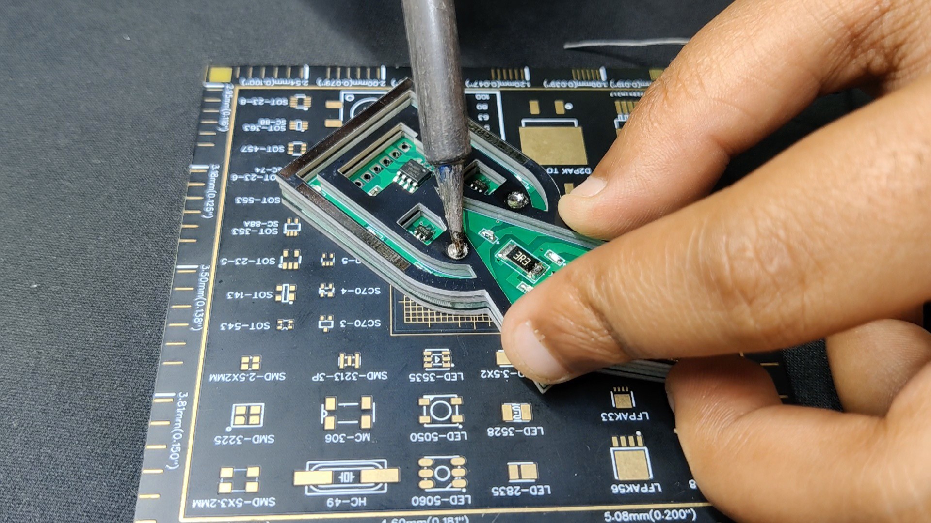

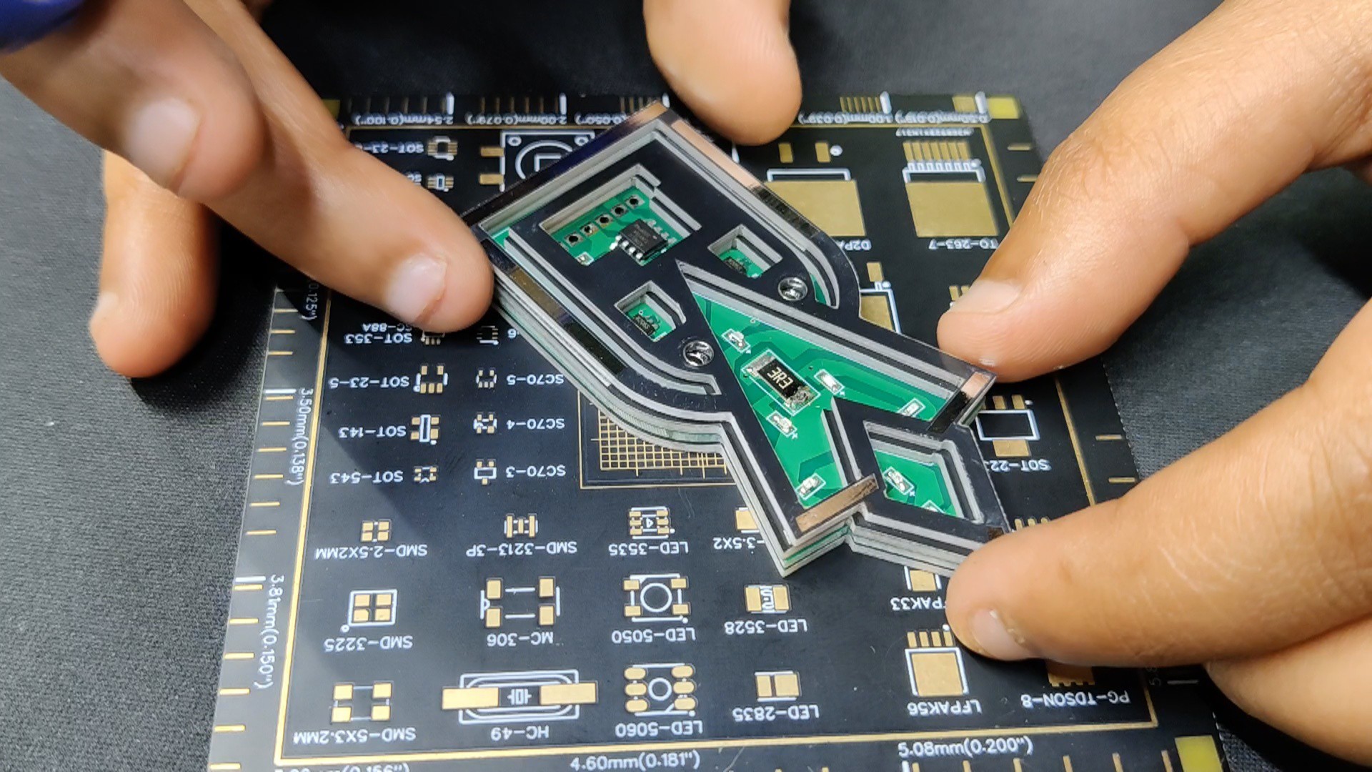

    • The layer assembly process now starts, with the bottom layer board being positioned on top of the middle layer board and another middle layer board being positioned on top of the bottom layer board.
    • Then, using a soldering iron to melt solder wire inside the mounting holes to fuse three layers together, this sandwich layer is put together.
    • We added another mid layer to the top side of the setup to give it a slight height so that the LEDs would diffuse properly. We then used solder wire to lock it in place on the mounting holes. Our current thick sandwitch PCB setup is made up of three separation layers, which make up the mid layer, and an electrical layer, which is the bottom layer.
    • The top layer was then added, and it was positioned using the mounting holes. We used a soldering iron and solder wire to attach the top layer to the other layers, securing them in place.

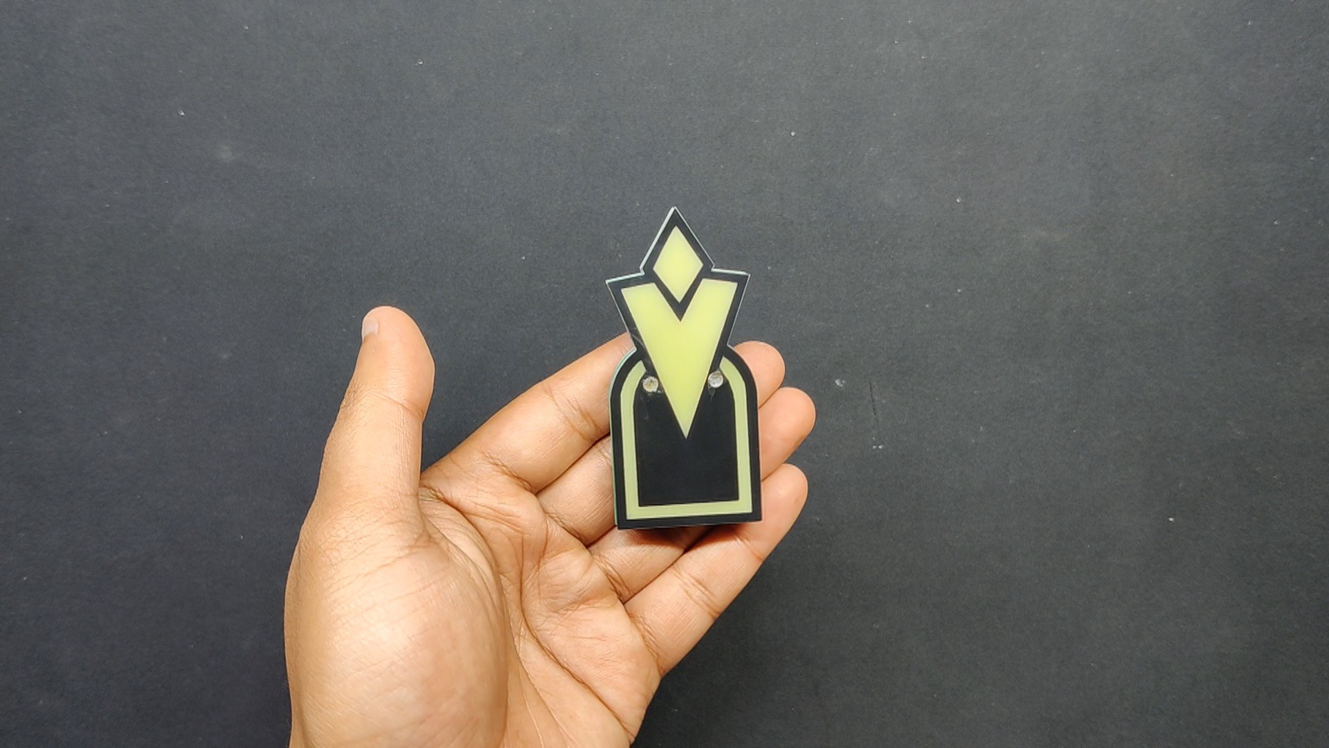

    Assembly is now complete.

Phil Weasel wrote 09/25/2024 at 06:50 point
Never occured to me i could just use a solder spot to hold the layers together instead of screws ..... nice idea.
