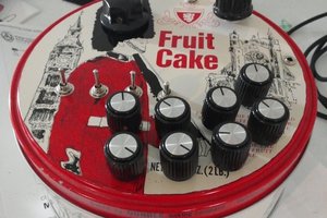

Modifications to Cardboard Radio Board
The Cardboard Radio RF board comes pre-assembled and has two potentiometers mounted on it, the volume control and the tuning control. I removed the volume control so that I could mount it on the front panel. I decided to leave the tuning control on this board for now and make it accessible from the back, because I don't want to make it too easy for my mother to accidentally disturb the tuning. I ended up remounting it the other way around, though, because it turned out to be more convenient to have the shaft pointing out of the other side. I may make some changes to the tuning system in the future.
I took the audio output from the pad where the top end of the volume control was connected. The exising audio amplifier on the board is not used.
The red wire is bridging a ground connection that was previously completed by the removed volume control.
Power Supply
There's nothing very remarkable about the power supply. It provides +/- 20V for the power amplifier and +5V for the RF board.
The reason the 5V regulator is fed from a separate rectifier is that I was getting a pop from the loudspeaker a second or two after powering off with the volume turned down, and I found it could be prevented by ensuring that the power amplifier remained powered while the RF board was shutting down. Giving the 5V its own feed from the transformer allowed me to ensure that it ramped down first during power-off.
The capacitor across the power switch is another measure to prevent noises when powering on or off.
