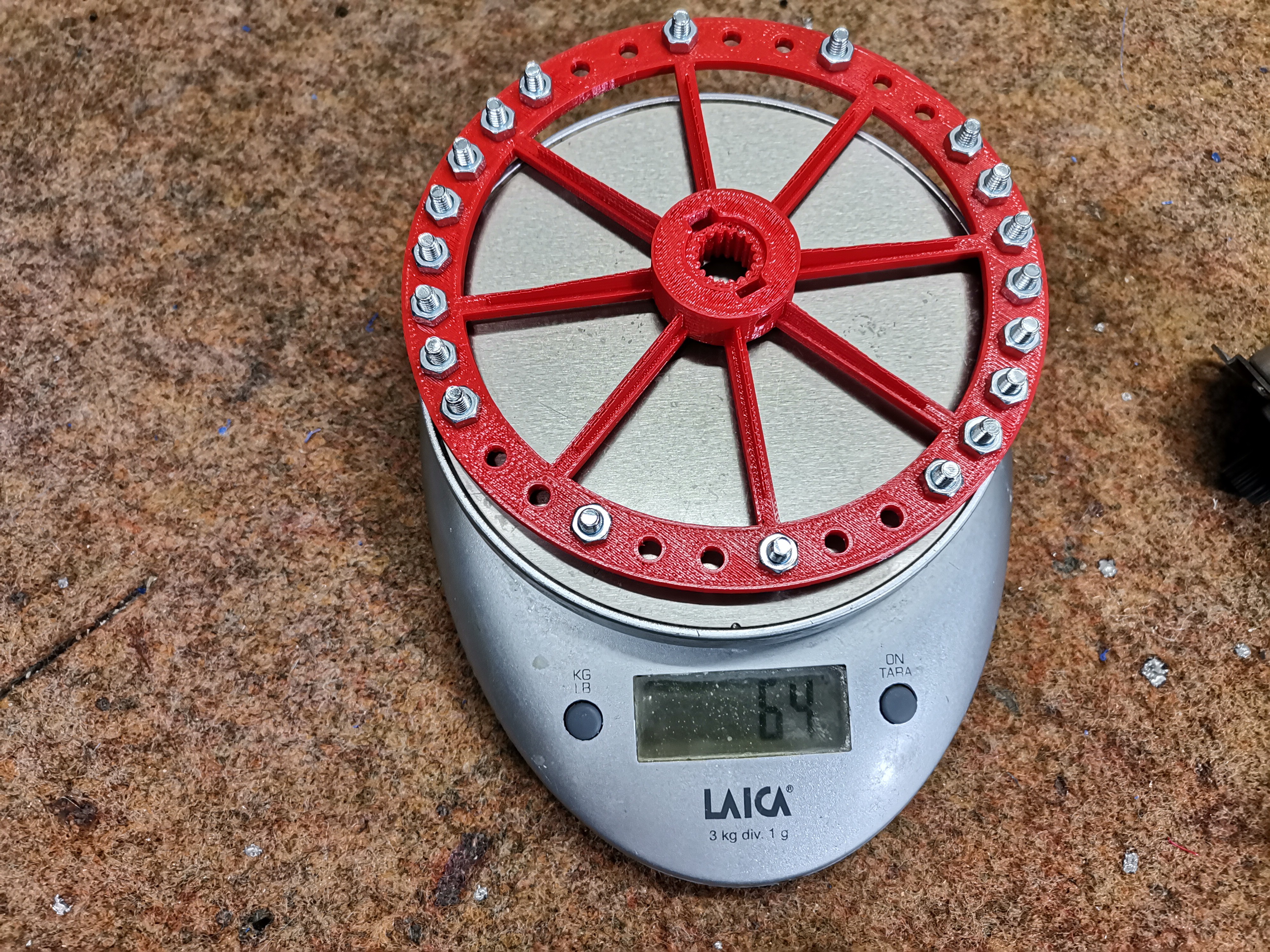

Nuts and bolts are added to the wheel in order to increase its weight, thus increasing the impact of the rotation on the whole device.
