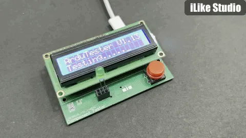

Component tester is an essential tool for electronics component value measurement. Here we have one DIY version using Arduino’s chip made by many other hobbyists in the past. Today we will build one version with a better PCB design keeping a minimal version in mind with a combination of SMT and TH components. The code is open source and can be found on the web, some modifications are made to make it work with a 16x2 LCD panel. Moreover the input output pinout has an external PCB resistor divider which is used to interpret the values by ADC by enabling its automatic component detection. Using a suitable resistor divider network ensures accurate value of most of the components.
The function for different component measurement and detection is given in the code section; separate header files can be seen in the Arduino code library for each component in order to calibrate it properly according to your own circuit. Here I made a PCB using the below given circuit and the code works well for it. Code for this project can be downloaded from here. If you want to know more about the tester working and principle then refer to its 100-page manual. Which has all info about modes, screen types, microcontrollers and software.

The schematics is separated into 5 sections. The first section contains the power input port and filter. Different value capacitors at the input of the voltage regulator are used to minimize supply noise. Second section contains a microcontroller and reset tactile switch. Third section is reserved for LCD. We are not using any separate controller for LCD, hence it can be directly mounted.
4th section contains control of brightness through a 5k pot, main resistor divider network of ADC and some filters. 470K and 680 Ohms resistor divider network is given to the ADC of Arduino. These values can be calibrated inside the code also. The 5th section has programming pins and main output headers. I always prefer to get a microcontroller chip directly from the top of the Arduino Nano after burning the sketch into it.

I encountered some problems while uploading the code in an ATMEGA328, after some research the problem is with the bootloader and type of chip. Atmega chip with mini_core bootloader will not work here because of absence of some internal registers. It doesn’t support the code layout at all and we can not use some functions. My idea is to use an Arduino NANO microcontroller for this and that’s what I did. PCb has its own programming pins, and the chip can be programmed through SPI(serial peripheral interface). This component tester can test all of the passive components and most of the active components. Like- Resistor, capacitor, inductor, BJT, UJT, MOSFET, IGBT, diode and LED. Here I have made some tests using my version:
This version not only tells the value of the component but also gives a small usable datasheet of that component. For example in the case of a capacitor the capacitance value, ESR, series inductor and resistor values can be obtained. Hence we will be able to calculate parasitics through the actual model of a component.
