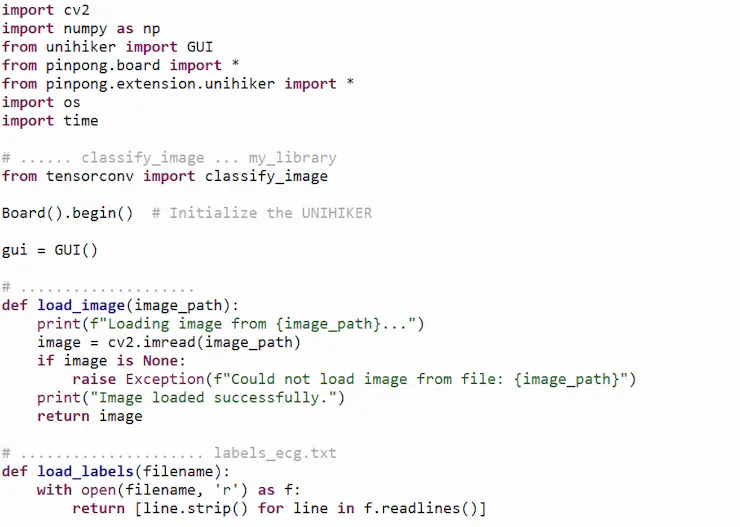

STEP 4:Source Code
CODE:
https://github.com/YakrooThai/UNIHIKER/tree/main/SmartECG
