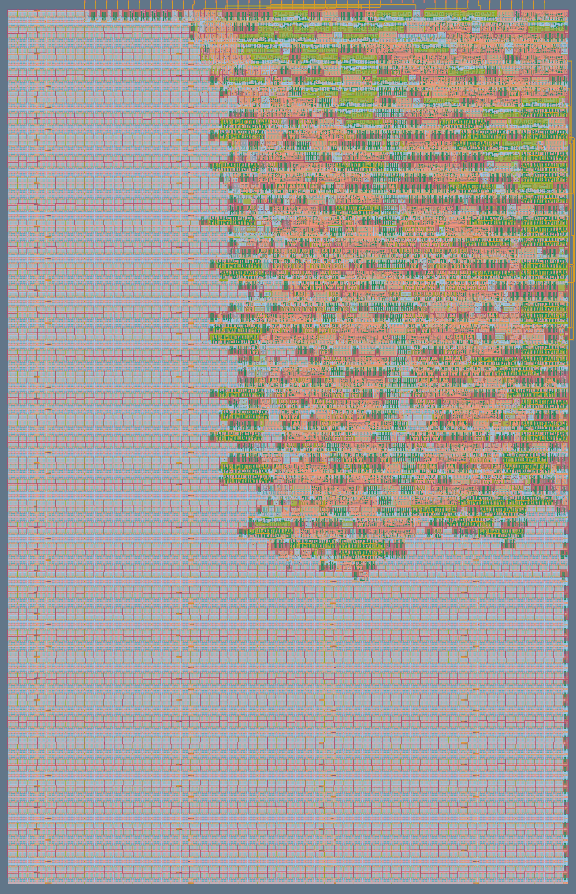

For the Verilog version.... rain is pouring on the proverbial park.
- first I had to come up with a translation layer to insulate the PDK from pesky variations between the iHP G2 and CMOS5L version. That has given https://github.com/YannGuidon/IHP_SG13_cells after a lot of wrangling with sed.
- but then, I need a functioning place to put the files, and I want to reuse https://github.com/ygdes/miniMAC_5Lwithout touching it. This is already a fork and github does not let me fork it further... So I guess the only remaining solution is to restart from scratch. So I must clone everything locally, treat all the files and then reupload them in a new instance of the original SG13G2 template... I hate git.
But in the end, coding has resumed.
Already I can find a few errors, such as
- B initialised to the wrong value,
- the CA bit reset instead of set.
- INIT_X And INIT_Y being ... wroooong.... (dffen_rs_x18 was bork)
Add to this the timing bug of the output multiplexer and you understand why the first tape out had no chance of working as intended.
But finally, the verilog version of the encoder is conform, at last !
