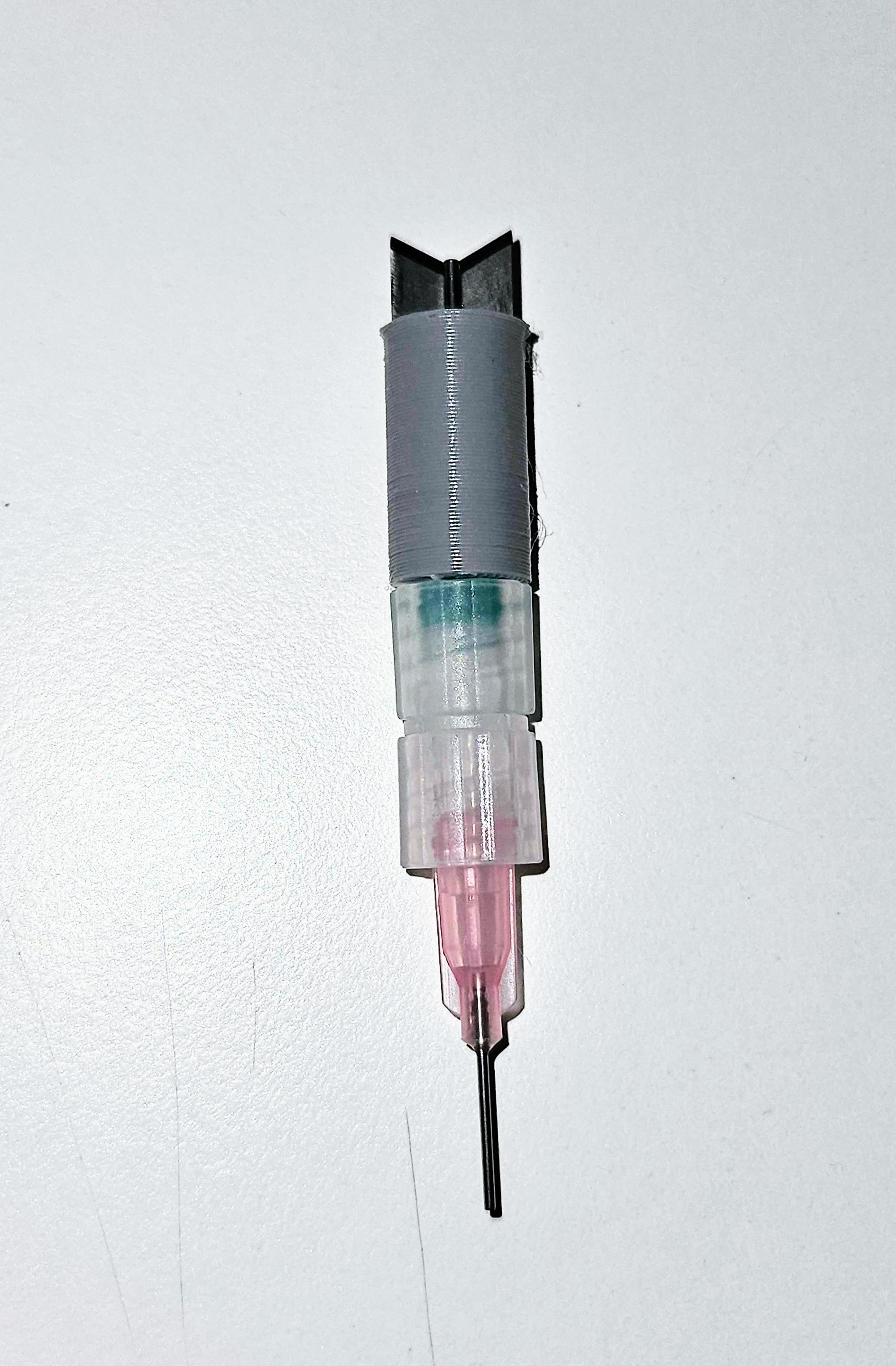

That’s where the cutting nozzle came in. This specially designed nozzle cuts the food-safe polymer tube at the moment the core material (chocolate, in this case) is extruded. The result? Only the chocolate comes out, leaving the tube behind in the printer, which keeps the printed object completely free from any unwanted material. It took quite a few iterations to get the cutting action just right, but once it worked, it was a game-changer. This innovation allows for clean extrusion of the core material without contaminating the print.
Here's a picture of my first cutting nozzle, since then I've progressed a lot!
