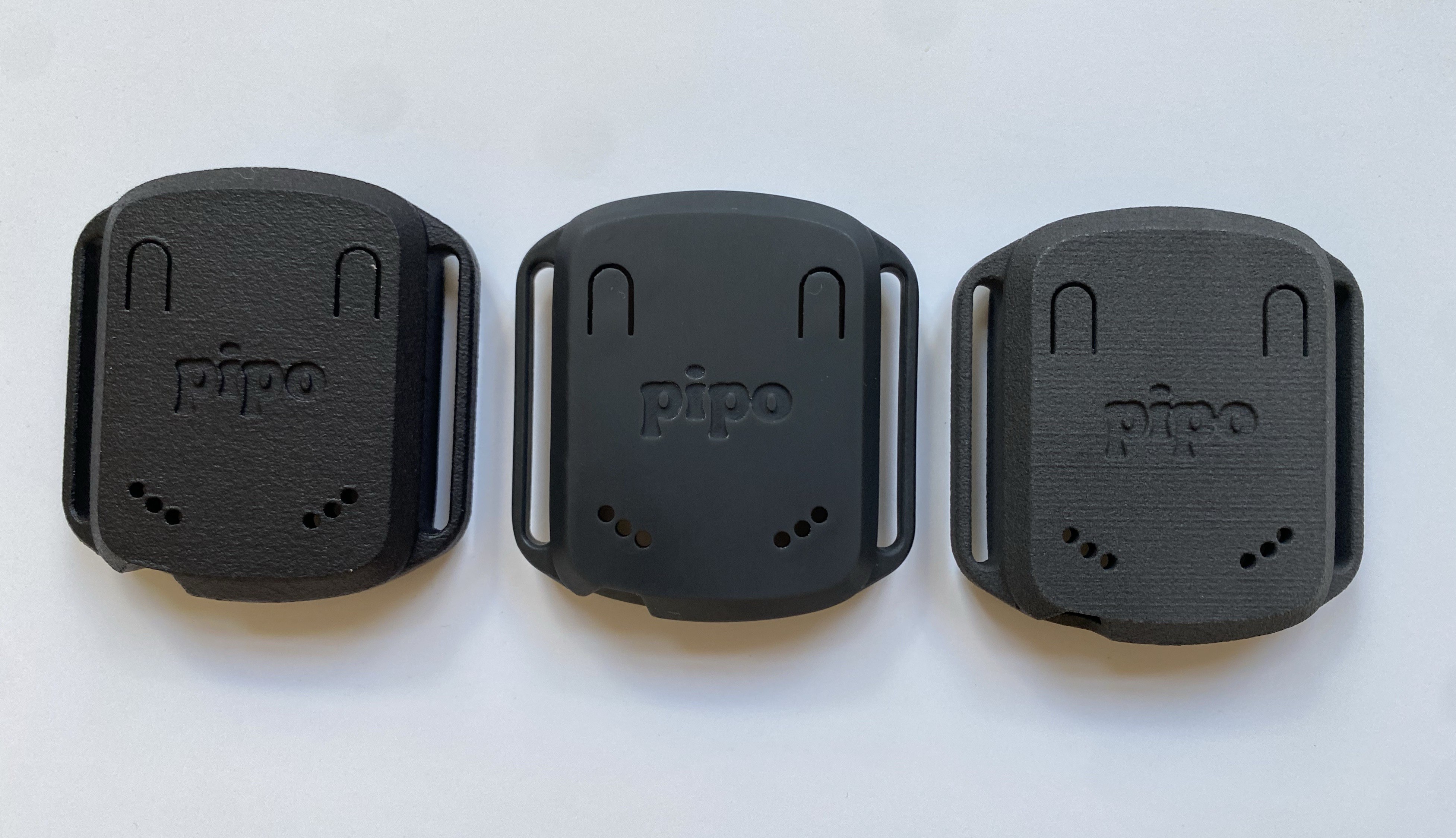

    With this log, I want to quickly share some pictures from a comparative test I just made of various 3D printing technologies and material.
    The comparison was done for the new case design of Pipo Motion, the wireless MiDi & OSC creative motion sensor I am developping.
    Note: this project will be publicly released soon on CrowdSupply if you want to have a look
    I choose this case among the 3 other Pipo types because it will be used more intensively, probably receiving more shocks and tension while having thin geometries, and I want this case to be robust while qualitative.
    I compared 6 types of 3D printing types here, 3 industrial options and 3 FDM (which  actually turns in 4 technologies)
    Having a good Fdm experience, I did not considered any declination of PLA as I consider it not durable enough for a small serie production. I had many occurrences of parts degradation over rather short periods of times, no matter the brand or the type.
    As well, JLC black Resin is unfortunately not in this comparison. I have been using it for many prototypes and have been rather satisfied since it is a good balance overall.
    I would note the following points about it:
    - black is not very deep. on thin wall, light goes through easily
    - the surface finish is not truly homogeneous, some areas can be glossy while some other will be matte
    - the value for money is good.
    Now, let's see the comparison
    Industrial overview:
    Left: PA12-HP
    Center: SLA Black Resin
    Right: 3201PA-F
    All 3 seam very robust while providing some flexibility.

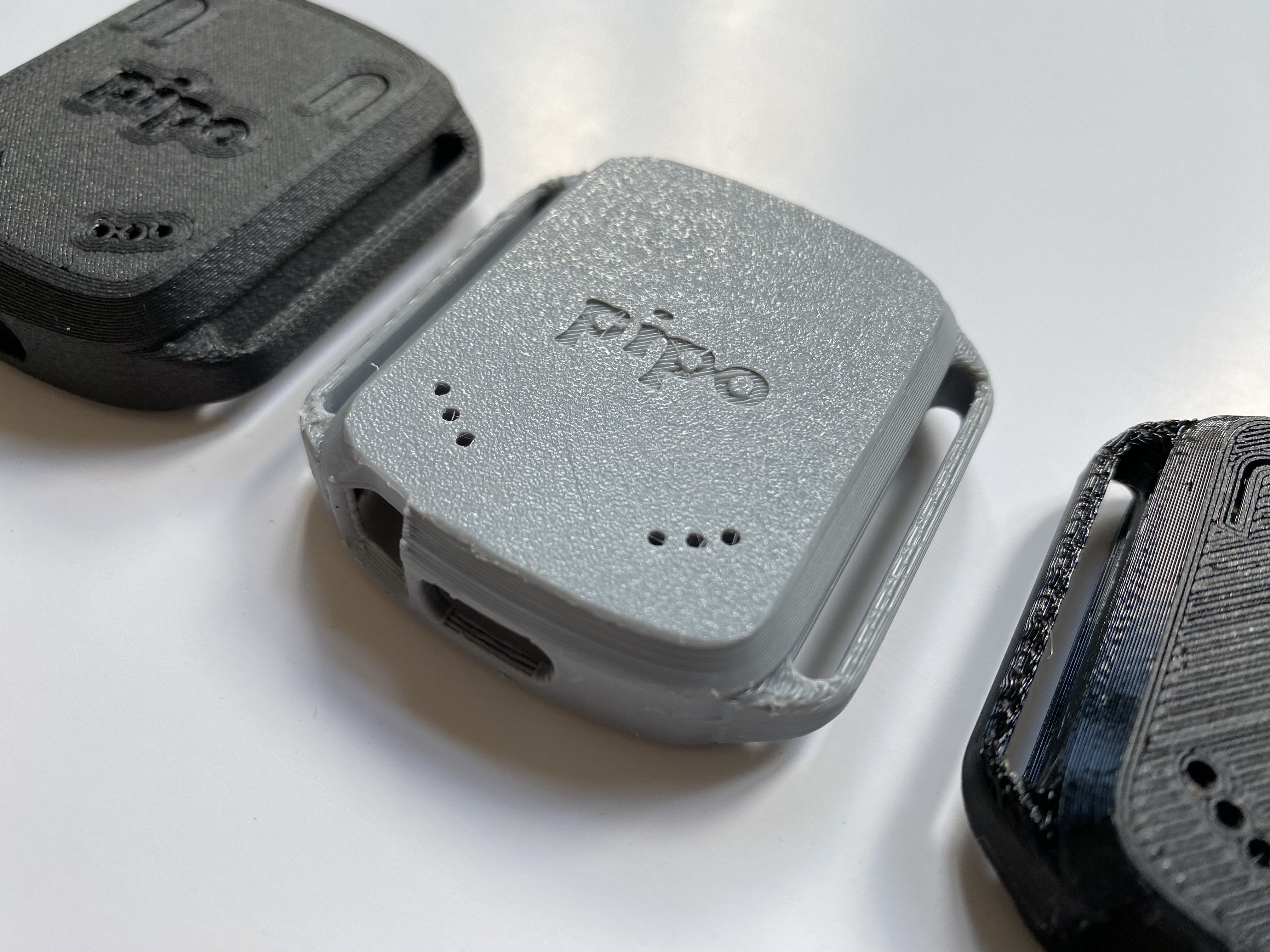

    FDM overview
    (Left PA12-CF, center PETG, right TPU)
    The finish on a part with this amount of detail is not at the level of the other techniques, while I designed this part initially for FDM.
    Fdm test overviewPA12-CF
    FDM PA12-CF
    • would be the best overall if the logo in the middle was not there since it is too detailed
    • good homogenous satin finish
    • very rigid
    PETG:
    FDM PETG
    • good all rounder
    • my PEI print bed gives 2 surface texture on the part
    • the details are not very refined
    TPU
    FDM TPU
    • was curious to see how it would behave with this geometry. It turns out to be too soft
    • rather shiny with average details
    • Not much to says as this is not an appropriate material for this use
