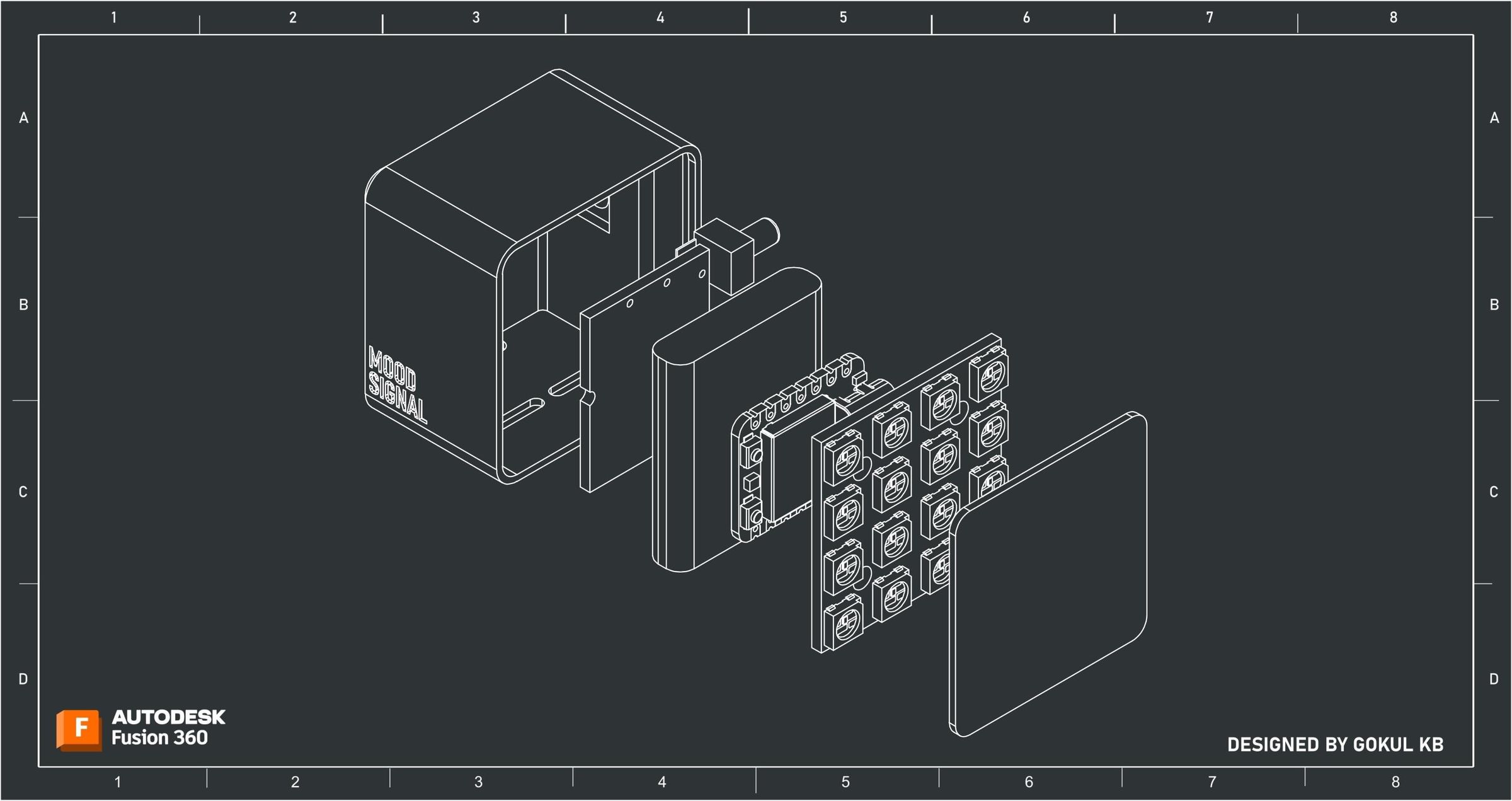

Step 1: Modeling in Autodesk Fusion 360
I utilized Fusion 360 to plan and design my project, which required careful space optimization. I needed to fit all the parts into the smallest form factor possible while ensuring practicality, including sufficient space for wiring and easy assembly. First, I imported all the 3D models of the parts and tried different configurations by placing the parts in various positions. Once I found the optimal configurations, I built the enclosure around them. design files are provided below.
mood signal v13.stepDownloadView in 3D

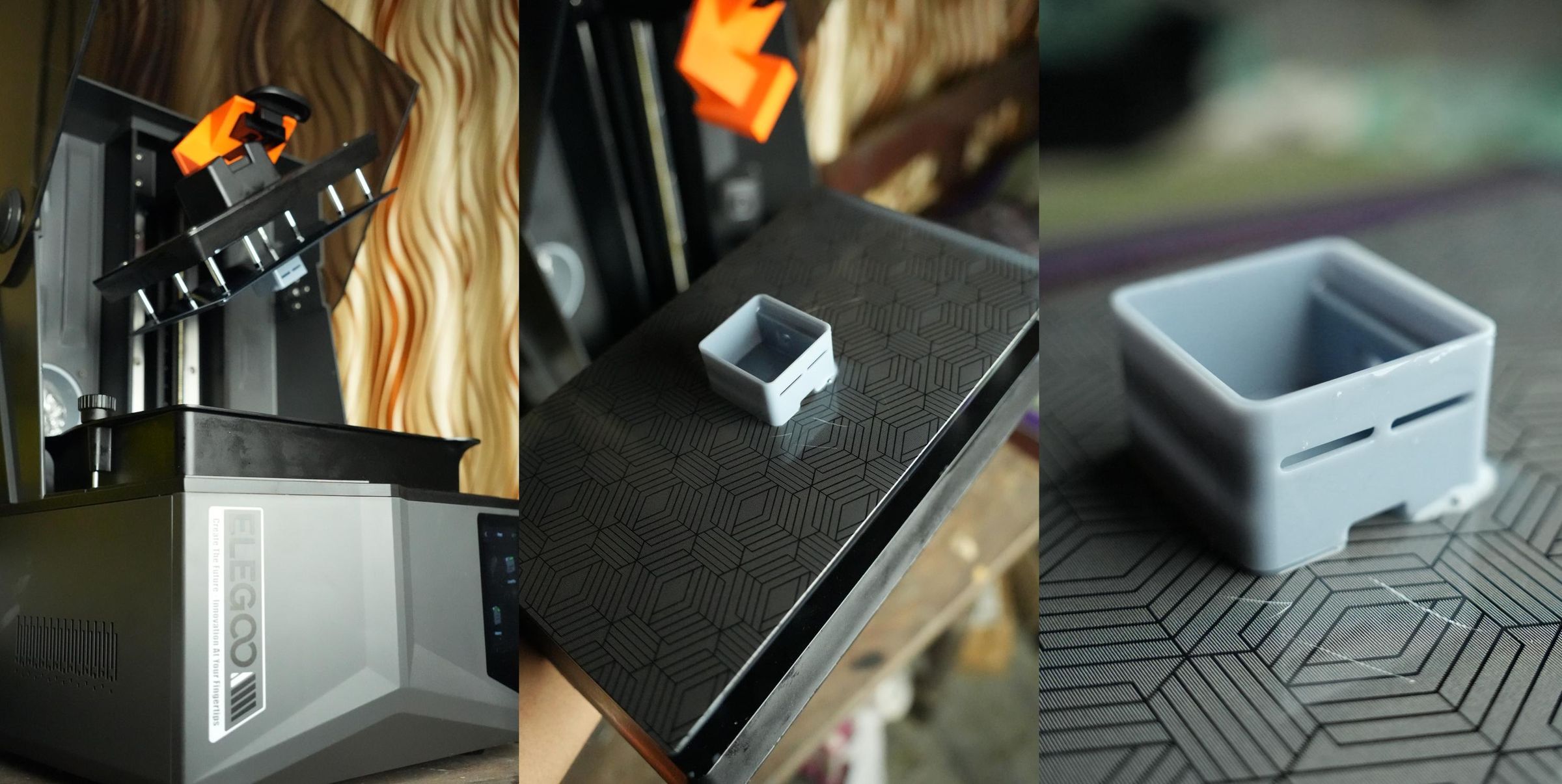

Step 2: 3D Printing
After exploring the model's STL file. I 3D printed each model. The main body is printed using a resin printer with standard resin . Then I spray painted matt black. This project can be also printed using FDM printers but the letter might not be visible in it. The resin printer allows me to produce my model with great accuracy , you can find both .STL file down below
after printing the main body i spay painted in in matte black
also i printed the diffuser in white PLA using FDM printer
diffuser.stlDownloadView in 3D
main body.stlDownloadView in 3D
