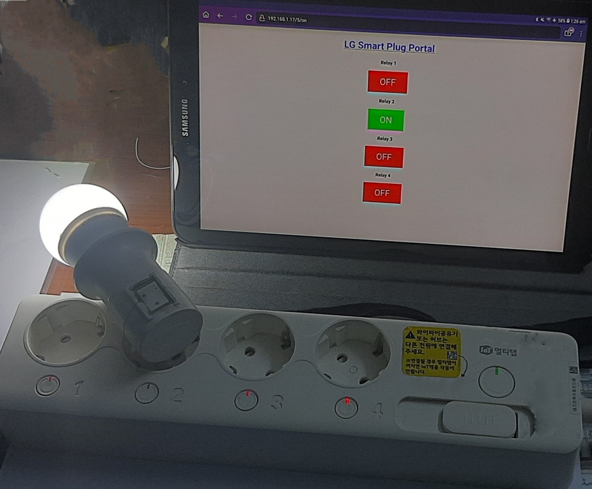

  • 5. Result
    mwahid12/25/2024 at 14:13 0 comments
    Here is the final result - Video link

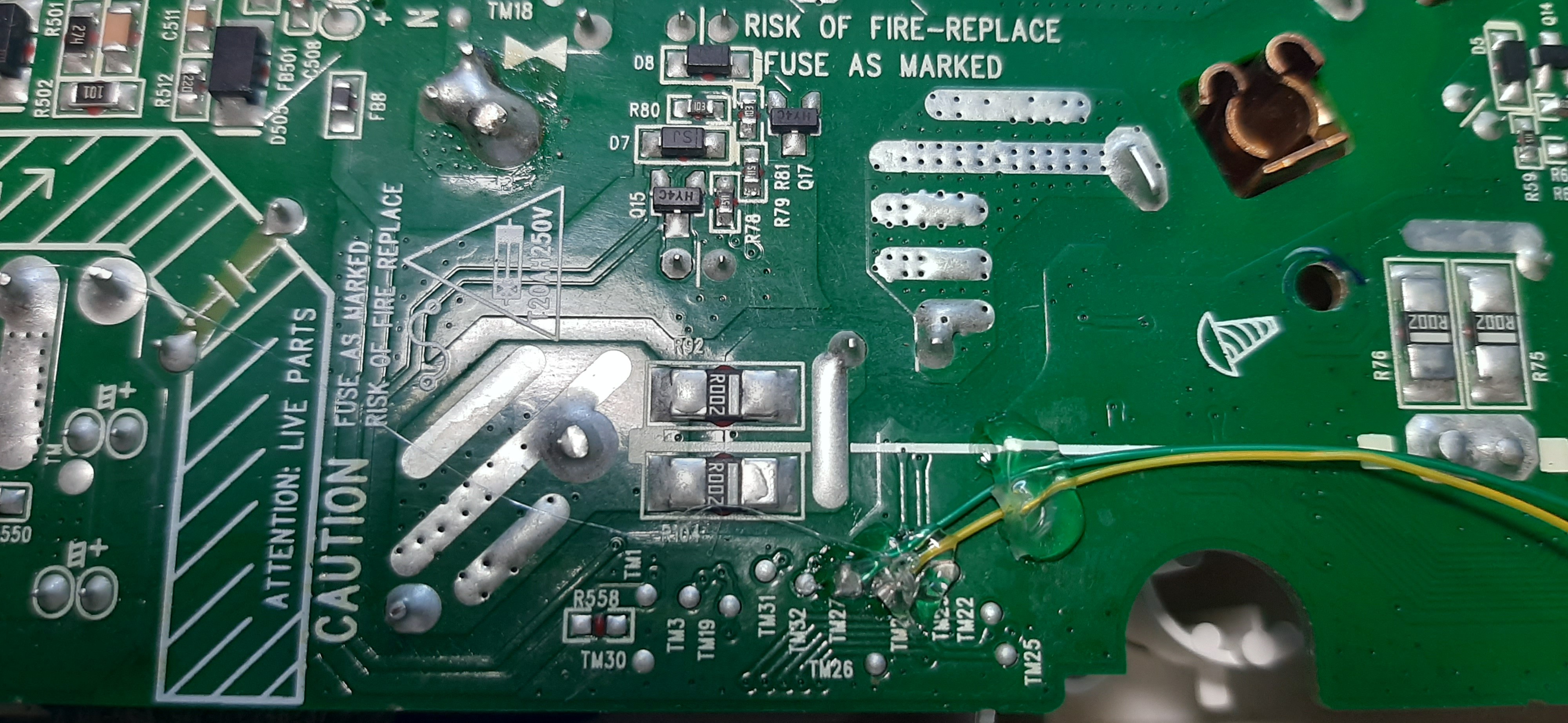

    So, I turned to the LED-I2C bus that controls the relays. Using the amazing "Bus Pirate" and the logic analyzer captures, I was able to control all the relays in the same way the SoC does by sending the frames in the capture files.
    The only problem is that the I2C bus can have one master only which is the SoC. So, for the bus pirate to work, I had to put the SoC in reset before sending the frames. But, in order to operate the device normally, the SoC must be running.
    Remembering that the I2C bus is transferred from the Control board to the Power board via the flat cable, I cut these two pins from the cable, and soldered two wires on the Power board itself thus, isolating this bus only from the Power board.
    This worked perfectly without the need to reset the SoC.

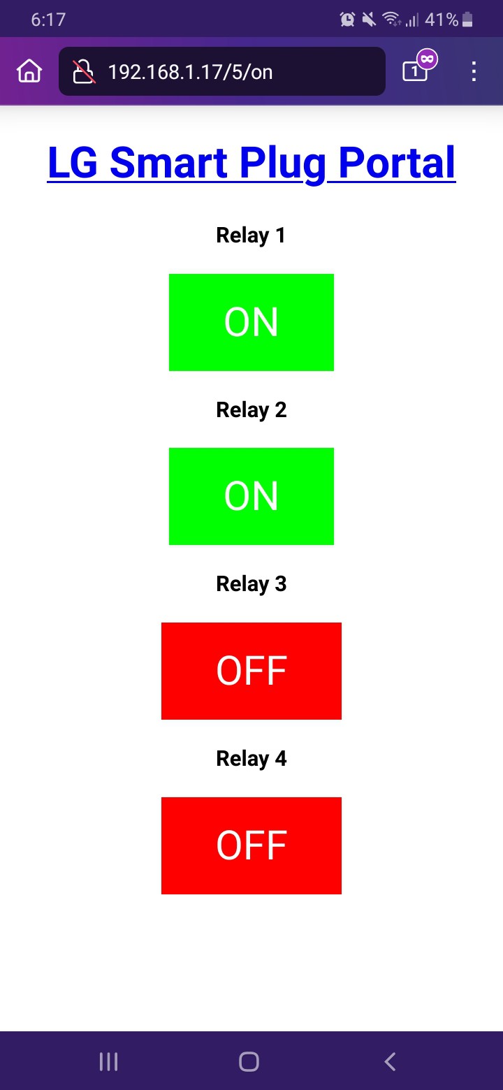

    Now, that I can bypass the SoC, all what remains is to add "Internet" part to the "Things".
    The ESP-01 is a tiny and capable module, and fits perfectly inside the plug housing. Using GPIO0 and GPIO2, I connected the ESP-01 to the I2C test pads on the Power board. With a simple Arduino sketch, I can control the power plug from any phone.

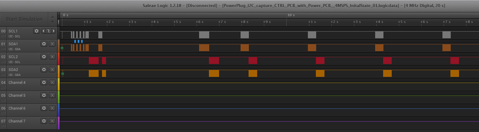

    I2C1 & I2C2
    • The two I2C buses transmit messages every 3 seconds whether a relay is ON or OFF.
    • I am still unable to understand the meaning of the bytes, but I think they are related to the current measurements.
    • The same pattern appears on both buses.
    • The files "PowerPlug_I2C1_capture_CTRL_PCB_with_Power_PCB_InitialState.csv" and "PowerPlug_I2C2_capture_CTRL_PCB_with_Power_PCB_InitialState.csv" contain the decoded bytes.
    Current measurements I2C frames

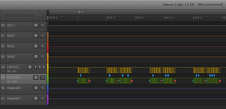

    LED-I2C
    • This is that controls the relays and indicator LEDs.
    • When one of the four keys on the Power board is pressed, the SoC detect the input and sends the corresponding command over this bus.
    • The files "I2C_RelayX_OFF.csv" and "I2C_RelayX_ON.csv" show the frames for controlling each of the four relays.
    Relays I2C control
    Relays I2C control

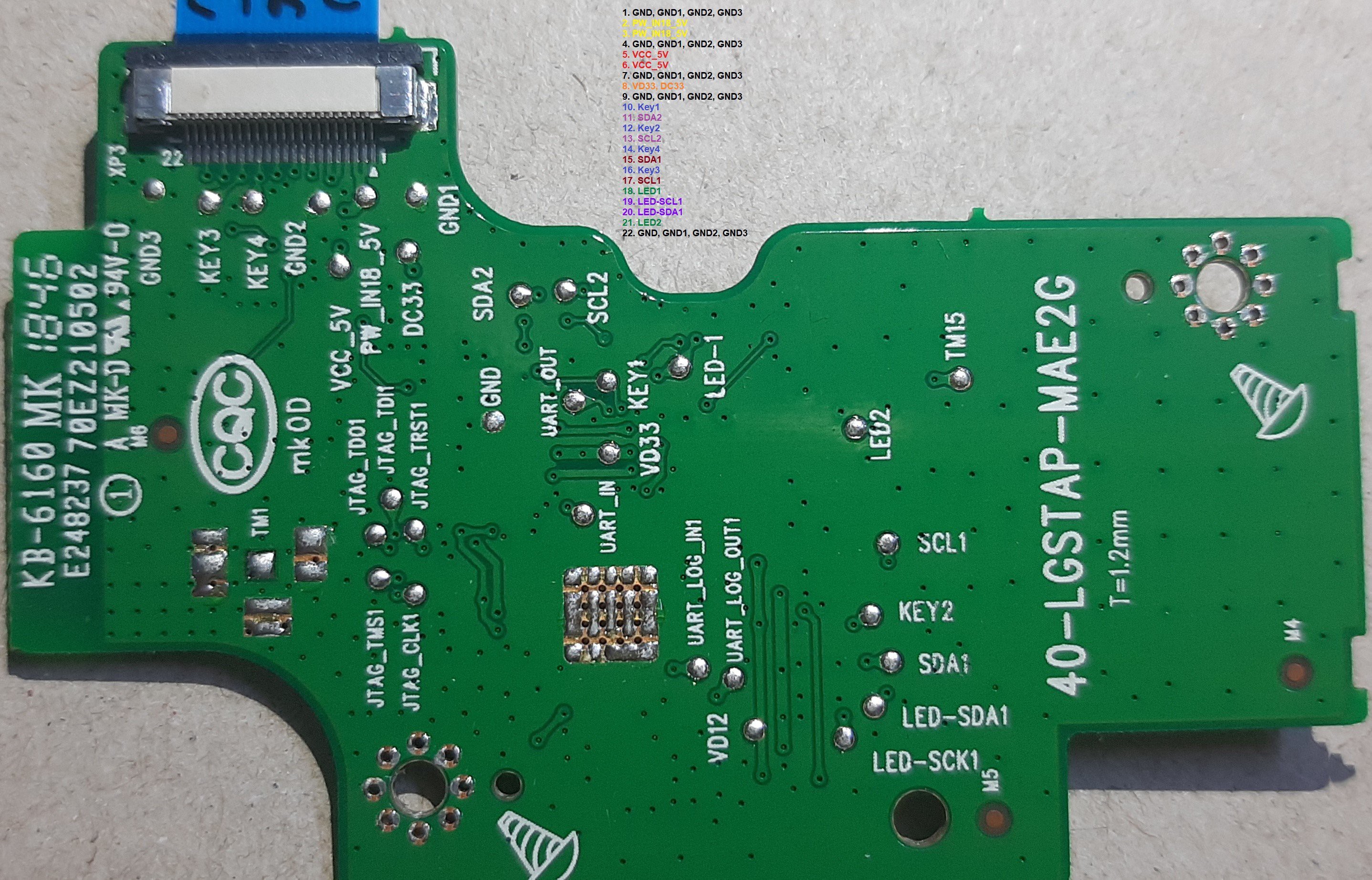

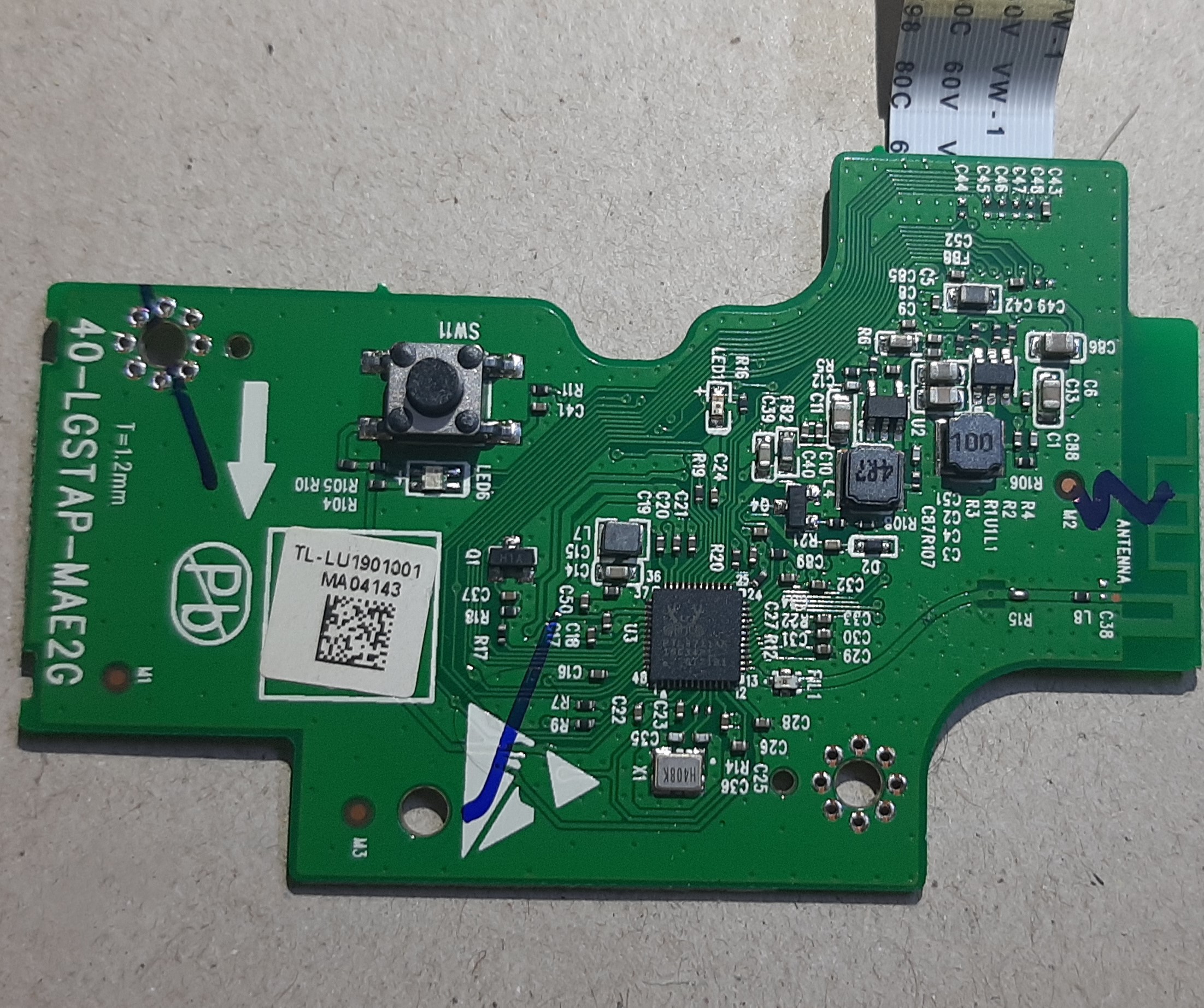

    Control PCB
    • The control PCB is the brain of the plug and has the following components:
      • The controller is an RTL8711AF which is "ARM Cortex M3 SINGLE-CHIP 802.11b/g/n 1T1R WLAN SoC".
      • The SoC has several GPIO pins, I2C, SPI, UART and even NFC peripherals.
      • The input is 18V coming from the Power board.
      • There are several voltage regulators to generate the 5V, 3.3V and 1.2V required by the USB and  the SoC.
      • The Control board communicates with the Power board via a 22-pin flat cable, and controls the relays and LEDs over three I2C buses:
        • I2C1 (SCL1 & SDA1), and I2C2 (SCL2 & SDA2) are used to communicate with four current sensor ICs.
        • LED-I2C (LED-SCL1 & LED-SDA1) is used to control switch ON/OFF the relays.
      • There are two UART ports:
        • UART_LOG_OUT1 & UART_LOG_IN1:
          • Works at 38400bps
          • Outputs the current status of the relays, and accepts user input.
            I am still unable to figure out what commands it accepts or, if it is even possible to control the relays over this UART port.
        • UART_OUT & UART_IN: Not used.
    Control PCB Top
    Control PCB Top
    Control PCB Bottom
    Control PCB Bottom

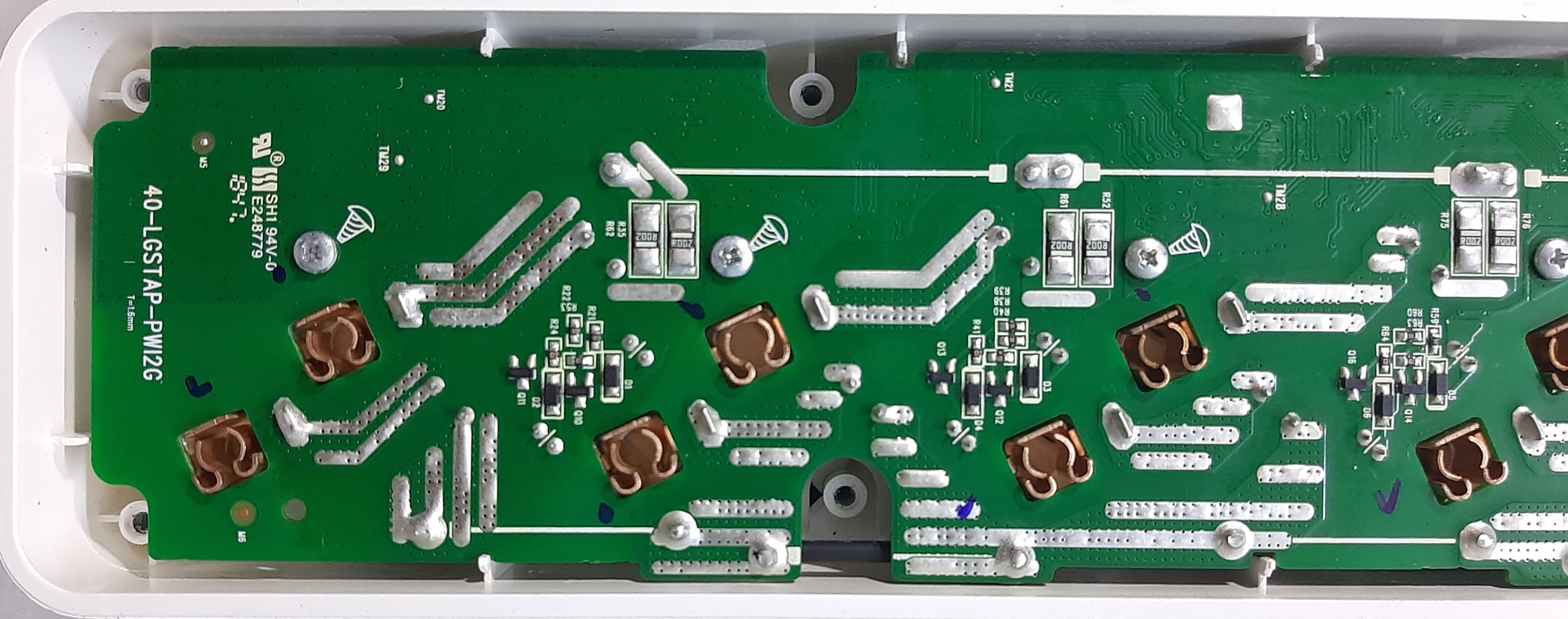

    Power PCB

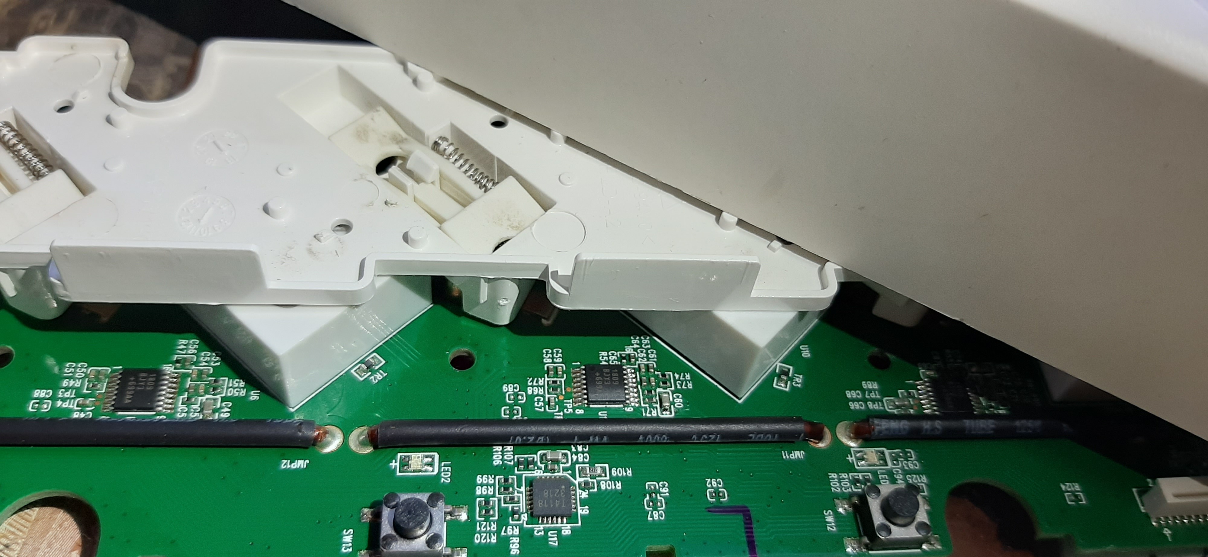

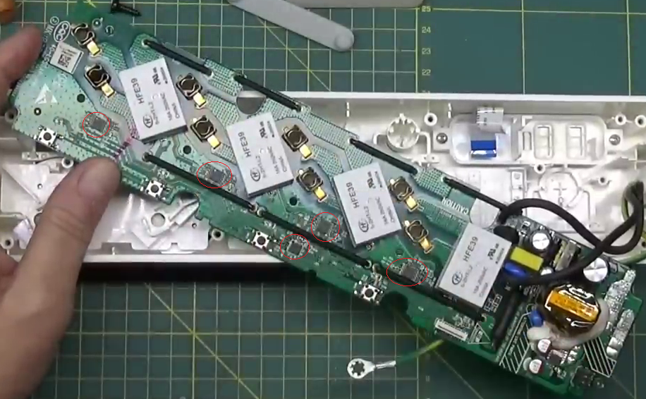

    The Power PCB has several interesting components which, unfortunately, I could not identify any of them. I was able, however, to discern their functionality from their connections.
    • 4 x Momentary buttons
      • Push-Buttons to switch ON/OFF the relays.
    • 4 x Status LEDs
      • Bi-color LEDs showing whether a relay is ON or OFF
    • HFE39
      • It Is a 277VAC/20A latching relay that works with 5V.
      • It has two coils; one for ON and another for OFF.
    • 1809 BJY3
      • There are four of this chip; each connected to one of the relays, and communicates with the main SoC over I2C1 and I2C2 buses.
      So, my guess is that these chips are for current sensing.
    • T4118 3218
      • This chip communicates with the SoC over LED-I2C bus.
      • The SoC controls the relays via this chip over the I2C bus.
      • 18 out of its 24 pins are connected to transistors to drive the relays' coils, as well as the indicator LEDs.
      So, my guess is that it is a GPIO expander of some kind.
    Power PCB Top
    Power PCB Top
    Power PCB Top
    Power PCB Top
    Power PCB Bottom
    Power PCB Bottom

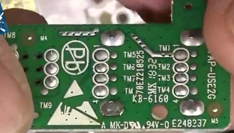

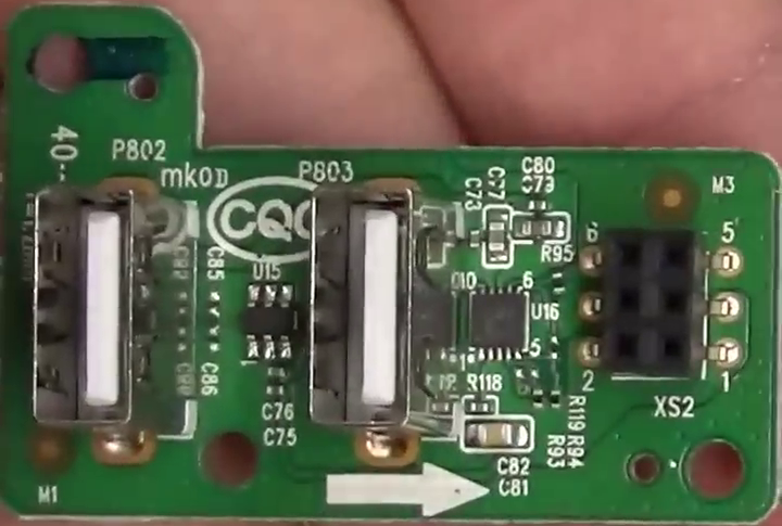

    USB PCB
    • The USB board is quite simple with two USB-A female connectors, charger IC and probably a voltage regulator.
    • The 6-pin connector connects the USB board to the Power board.
    Unfortunately, I could not read anything of the chips.
