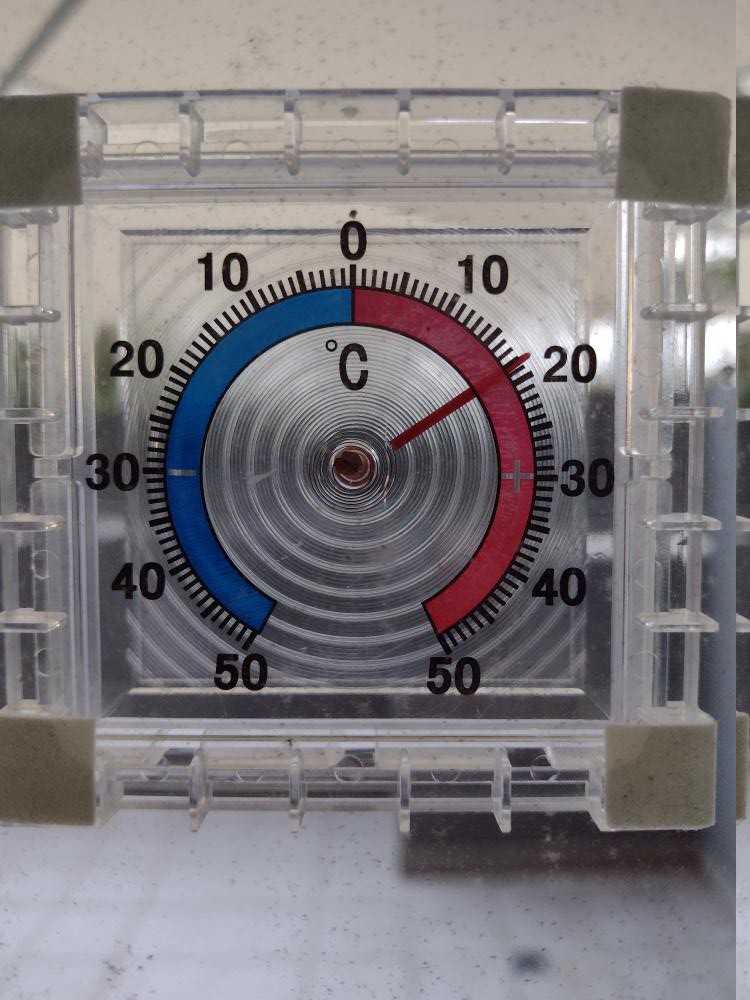

    I bought a couple of these analog thermometers for a couple of dollars each from AliExpress. They are lo-tech, the pointer is linked to a coiled spring the length of which is temperature dependent. It's stuck to a glass wall with double sided sticky pads at the corners. Here it's viewed from inside.
    Brilliant! No wires, no electronics, no communications, no power source, no computing. I only need to judge how much clothing to wear if going out, not to know the temperature to a fraction of a °C.
    The biggest drawback though is that it's still close to the dwelling and it will be warmer than open air due to the proximity. For a good idea of the temperature away from the dwelling, I need a remote station. Also need to know the wind speed to add a chill factor. So back to the drawing board for that. Or maybe I'll just check the weather page on the Internet.
