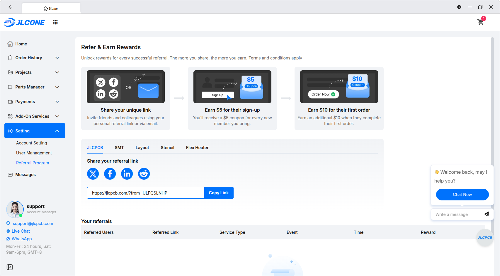

    (In the above screenshot showing a successful conversion I won't show the Home page because I don't want to show my orders, but feel free to use my referral link above. 😉)
