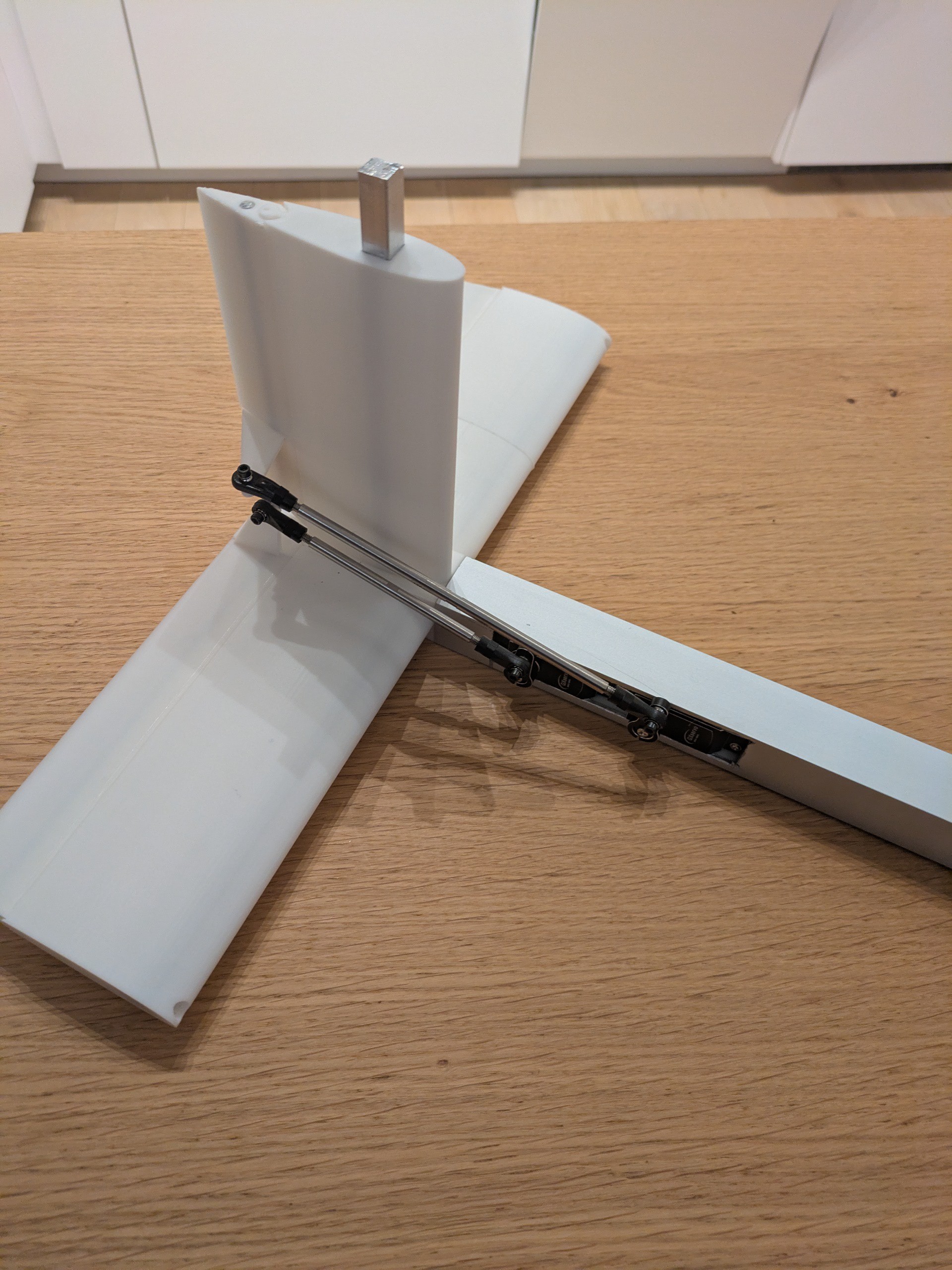

• First (short) Flight
    Giovanni05/24/2025 at 18:14 0 comments
    Feels much more stable than with the standard stab.
    Now waiting some wind for a test with a wing.

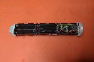

  • Battery and fuselage adapter
    Giovanni02/05/2025 at 17:18 0 comments
    now the two 21700 cells have been submerged in silicon resin and fit perfectly in the 30x30 aluminium profile.
    The stab adapter make sure that the Gong V2 fuselage stab connects to the aluminium profile. The stab adapter locks in the battery and allows to pull it out of the profile for charging
    The battery has an integrated 8A BMS that allows it to be charged without accessing the balance leads
    The Servo adapter is next. The version in the picture still has a lot of work to be done
