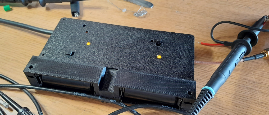

    Next revision. The main change is auto-calibration (microcontroller was needed). The main problems in this revision are mechanical construction (poor shielding, light coupling asymmetry and calibration). Still some adjustments maybe needed (LED operating point, maybe different LED, dividers and op-amps compensations, resistors/ferrites in power supply rails), but it works.
    Some distortions caused by physics of photodiode were observed, probably unavoidable, but possibly it can be improved by more symmetrical coupling of LED with photodiode. Maybe different LED would be better, but it's hard to find LED with good rise time.

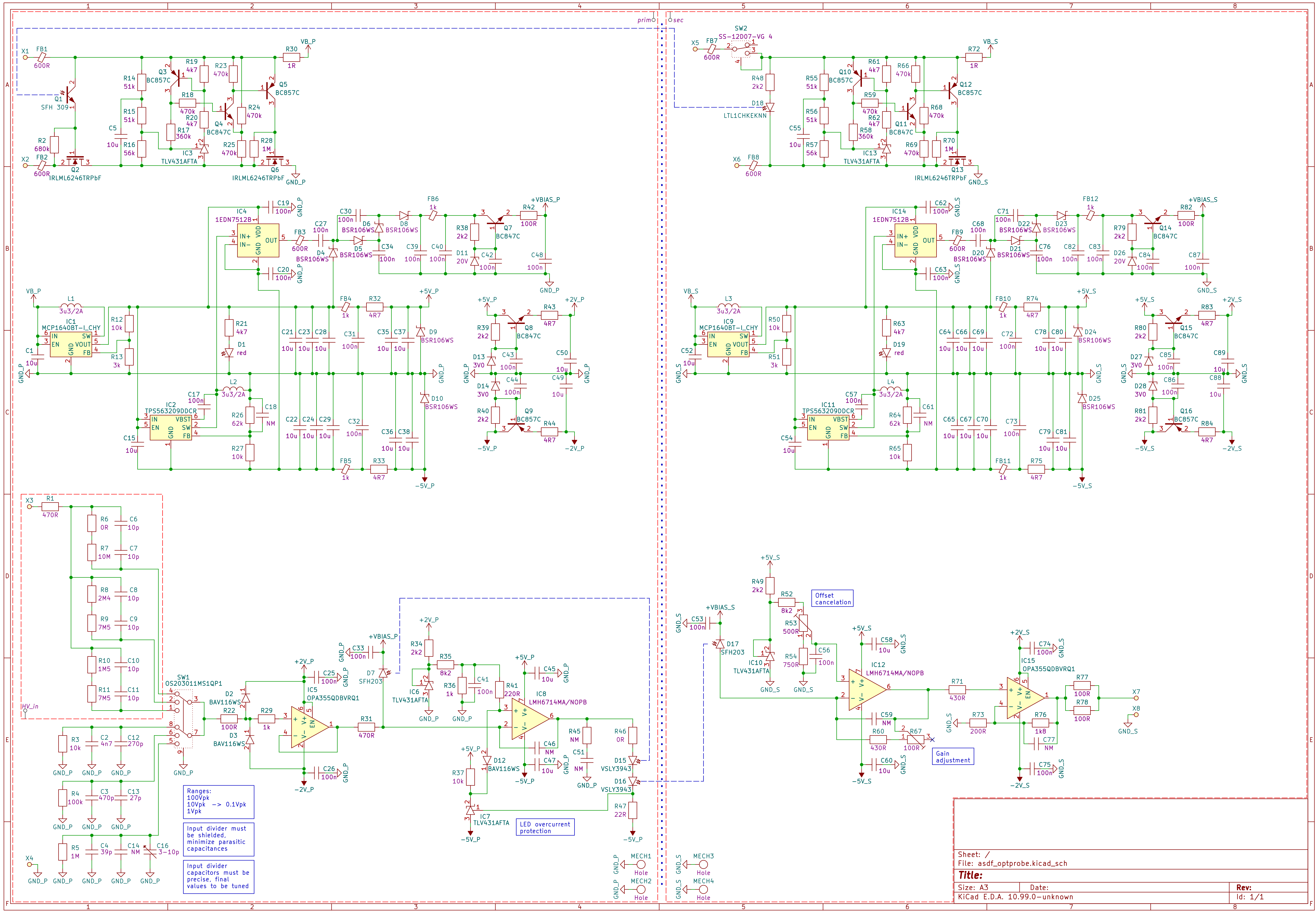

    Issue
    Status
    Input divider compensation not accurate
    As expected, because of parasitic capacitances and poor tolerance, capacitors must be adjusted
    Adjustments (still not perfect):
    10x – 33p+6p8
    100x – 510p+47p+6p8
    1000x - 4n7+470p+68p
    Maybe better change to a single divider 1/100, then selection of two ranges after buffer
    Instability of op-amp
    Missing compensation capacitors for the op-amp (recommended by datasheet)
    Added 4p7 on pin for compensation capacitor in receiving op-amp.
    Not needed for final 10x amplifier.
    Boost converter startup issue
    Turns off after detecting undervoltage (?)
    Shorted 1R resistors which were added to limit inrush current (maybe unnecessary?)
    Adjustments of optical couplings
    It’s difficult to match gain in feedback path and primary-secondary signal path.
    Adjustable by screw, but needs better mechanical design.
    Also, minor flexing of PCB changes coupling while usage (use thicker PCB? different mounting points?).
    More space for diodes is needed, especially if OPV332 is an option (longer).
    Shielding
    Not sufficient shielding
    Poor immunity with shielding cans (0.1mm copper), mounted with a few clips to PCB, sealed with copper adhesive tape, SMA-U.FL 1.13mm cable converter.
    Previous prototype was better, with soldered cans and cables shields soldered to cans, but it was difficult to disassembly and the rigid cables caused bending PCB (causing gain/offset drift).
    Too long calibration
    Time constants too long
    Change C12: 10u->470n (with PWM 15Hz, it’s enough in detector that drives voltage change for calibration).
    Change C63: 10u->470n (still good enough filtering of PWM controlling gain adjustment, large impact on calibration speed)
    Possibility of using OPV332 VCSEL
    With OPV332
    R40=R61=2k7
    R57=0R
    R58=120R
    R45=1k8
    C46=2p2
    C56=3p3
    Advantage – higher bandwidth (-3dB at about 30MHz, with LED about 15MHz).
    Disadvantage: noise is high – about 7mVrms, 70mVpp in 20MHz, above 10mVrms without bandwidth limit, also depending of diode bias (at 1V range, so the noise is a few percent of full range – quite noticeable).
    Possibility of optimizations with VSLY3943 LED
    Consider adding capacitors to resistors limiting LED current, to speed up at higher frequency:
    R57=47R||220p
    R58=22R||220p
    Then reduce capacitor in feedback of op-amp (which reduces ringing and is needed for stability):
    C46=2p2
    On receiving side it can be:
    C56=4p7
    Move up slightly current of LEDs:
    R40=R61=6k2
    R45=620R
    R69=15k
    VSLY3943 has less noise than OPV332, about 2mVrms 13mVpp in 20MHz, bandwidth is about 15MHz, some DC offset appears at high frequency (asymmetry of rise and fall time), some nonlinearity – at +1V and -1V it’s about 2% difference (when 0V has no offset).
    Distortions of signal with VSLY3943
    Square wave is not quite square, first it’s a fast rise time (about 20ns) to almost final voltage, but then it takes some microseconds to reach the final voltage.
    The problem is observed also in a separate test of diode-photodiode,...
  • Rev 3
    michal777 • 05/20/2026 at 22:32 • 0 comments
    Next version.
    In contrary to the version with laser and plastic fibers, transmitter and receiver are in the same enclosure for stable transmission through light-pipe.
    In contrary to the first versions, there's no mechanical symmetry of couplings between IR transmitter and photo-diode in feedback path and primary-secondary path. In feedback path the LED and photo-diode are near, to keep tracks to op-amp short. In primary-secondary path, plastic light-pipe is used to provide optical coupling and isolation distance (MENTOR 1216.1003). It works well, but coupling in primary path must be slightly reduced for symmetry.
    Shielding is very important (details below). In the prototype, about 40mV (or a bit less with bandwidth limit in oscilloscope 20MHz) was achieved when 4kV burst disturbance was connected to input ground (coaxial short connected), which is 4% of full scale.

    No signal - saturation.
    Incorrect bias for the used emitter+photodiode (VSMY5850 and SFH203). R26 and R44 had to be much lower because VSMY5850 can’t cause that much current through SFH203.
    VSMY5850 won’t be used, bias should be designed for IR emitter OPV332. Potentiometers were added to make it adjustable (OPV332+SFH203 may be not very repeatable). Tests shown that 0.7V at “+” input is good for range and linearity (so about 1.5mA through photodiode should flow at 0V input) – voltage divider was adjusted.
    Could be faster.
    Emitter VSMY5850 and photodiode SFH203 were good up to about 10MHz, C41 was required to avoid ringing. OPV332 (VCSEL) instead of VSMY5850 (LED) works better:
    - higher signal (0.4Vpp at output),
    - wider bandwidth (probably 30MHz),
    - lower current - less heating, so better thermal stability expected (10mA is max, now limited to 5mA).
    - THT package (not SMD-THT adapter required)
    Higher cost but it’s worth the money.
    R30 is changed from 33R to 220R. C41 not placed.
    VSMY5850 was changed to OPV332. Cathode must be connected to -5V (not GND) to ensure voltage sufficient for bias (considering op-amp output range and max voltage drop at OPV332). Op-amp output...
