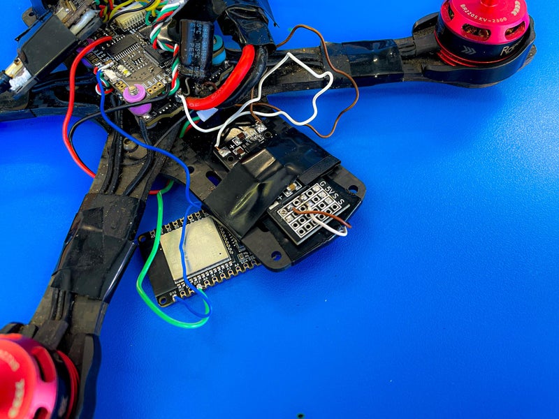

9Component Placement
After soldering the wires to the flight controller according to the wiring diagram, your setup should resemble the image below.
Next when you flip the drone over, you can position the ESP32 in the same orientation as below, ready for the Droke to be attached.
