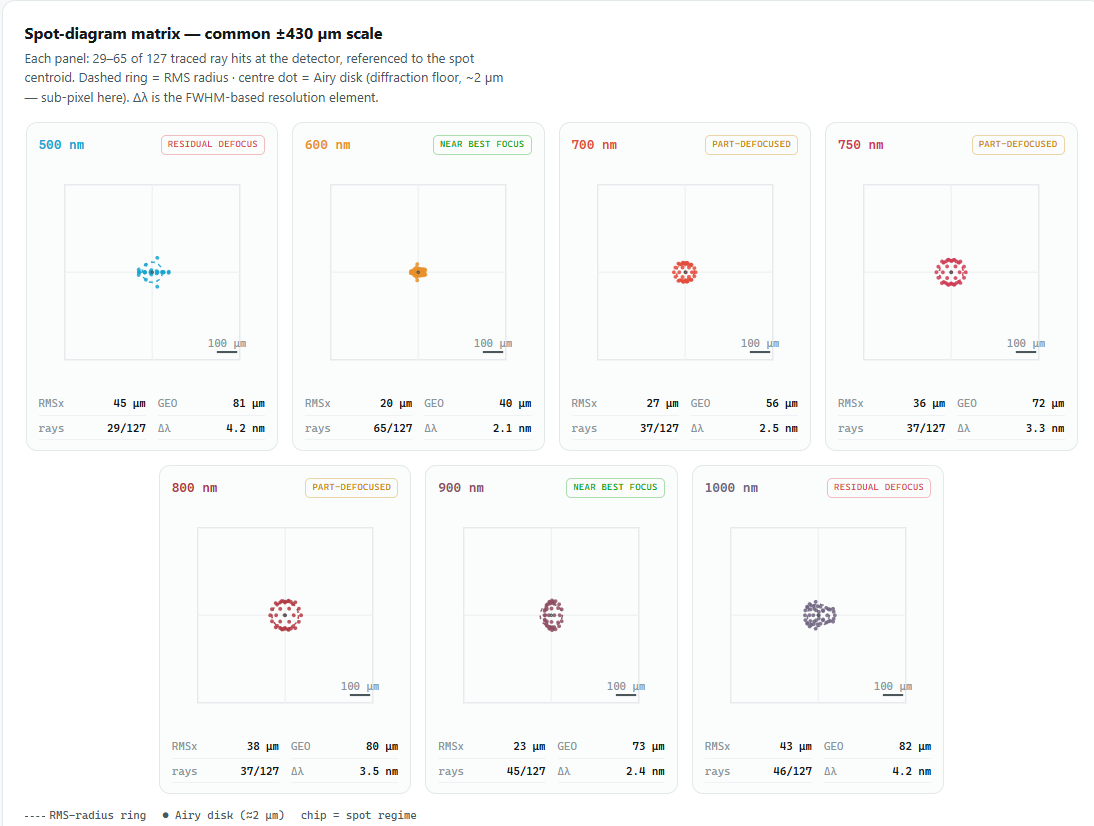

Spot / spot diagram. When the camera focuses one single colour, it should ideally land as one perfect point. In reality it lands as a small smudge of rays called a spot. A spot diagram is just a zoomed-in picture of where all the rays for one colour actually hit. Smaller, tighter spot = sharper instrument.
Centroid. The average position of all the rays in a spot — i.e. the "middle" of the smudge. For the dispersion direction, the centroid is where that colour's spectral line effectively sits on the detector.
RMSx — the number that sets resolution. RMS stands for root-mean-square, which is just a careful way of saying "typical spread." RMSx measures how far the rays are spread out along the direction colours are separated (the dispersion axis). We only care about this direction, because spreading sideways doesn't blur one colour into the next — only spreading along the colour axis does. In one line: RMSx = √⟨(x − centroid)²⟩, converted to microns. Smaller RMSx = a sharper spectral line.
GEO — the worst-case spot size. Where RMSx describes the typical spread, GEO (geometric radius) is the distance from the centroid to the single farthest ray in the spot. It's the full footprint — the circle that contains every ray. It's always bigger than RMSx and is driven by the most poorly-behaved ray at the edge of the beam. We report it as a reality check on how large the spot can get.
Airy disk / diffraction floor. Physics says no lens can ever focus light to a perfect point — diffraction spreads it into a tiny blob called the Airy disk. Its size is fixed by the wavelength and the lens speed (about 2 µm here). This is the best case: no design can beat it. In our spots it shows as a tiny centre dot. Because our real spots are 10–40× larger than this dot, the design is geometry-limited — meaning lens imperfections, not diffraction, are what set the blur. (BeamFour is a geometric tracer, so it can't model diffraction directly; we draw the Airy disk in as an analytic reference, using the standard formula 1.22 × wavelength × f-number.)

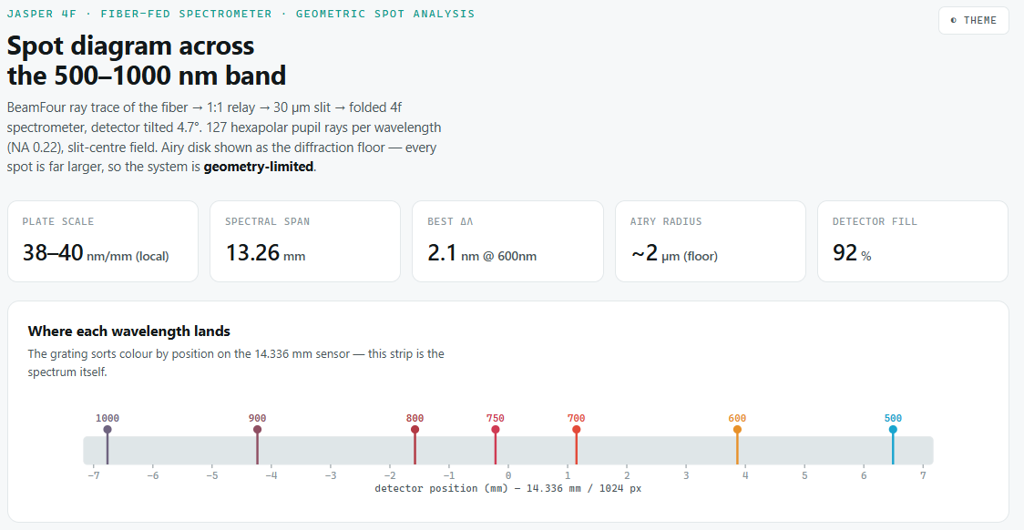

Dispersion scale (nm/mm). How many nanometres of spectrum are packed into one millimetre of detector. Here it's 38–40 nm/mm. Lower would mean the colours are spread out more (finer detail); higher means they're squeezed together. It's not constant across the band, so we always measure it locally from the traced spots rather than using one average.
Spectral span. The total length the whole 500–1000 nm spectrum occupies on the sensor — 13.26 mm here.
Detector fill. What fraction of the sensor's length the spectrum actually uses. 92% means we're filling almost the whole 14.336 mm sensor — good, because unused sensor is wasted resolution.

rays n / 127 — survivors vs launched. For each colour we launch 127 rays arranged in a pattern across the beam. Some get clipped by the edges of lenses or apertures on the way through (this is called vignetting). The n / 127 count tells you how many survived to reach the detector. A lower number means more of that colour's light is being lost, so its measured spot rests on fewer rays.
Figure 3: Top-level results. The five tiles summarise the whole design; the strip below shows exactly where each wavelength lands on the 14.336 mm sensor — that strip is the spectrum itself.
The five tiles are the headline numbers, now that you know what they mean: dispersion scale 38–40 nm/mm, the spectrum spanning 13.26 mm, a best-case resolution of 2.1 nm (at 600 nm), the ~2 µm diffraction floor, and 92% of the sensor used.
The strip underneath is the most intuitive picture in the whole analysis: it's the sensor drawn to scale, with a coloured tick showing where each wavelength actually focuses. This is, quite literally, the spectrum the instrument would produce.

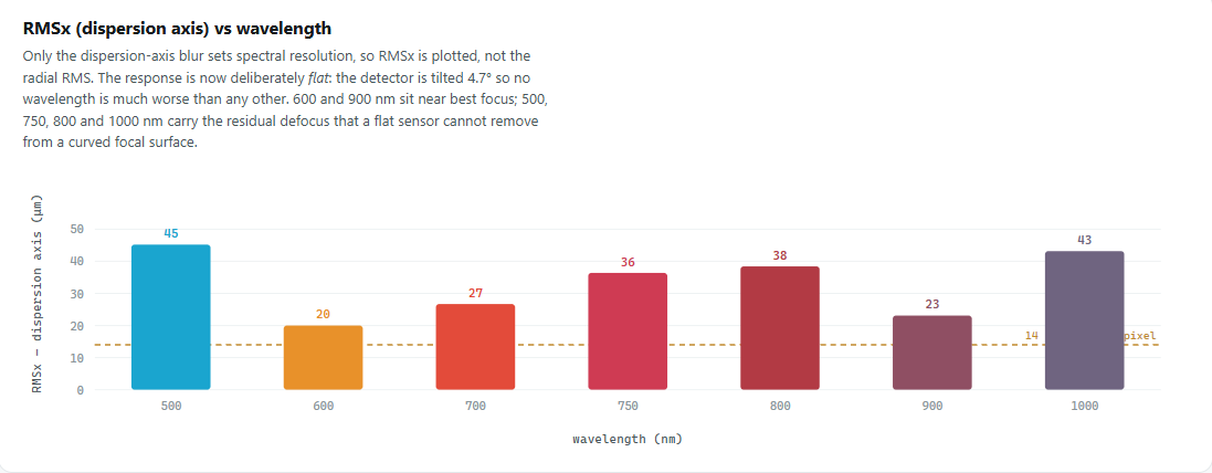

Figure 4: RMSx (spectral-axis blur) for each wavelength. The dashed line is one detector pixel. The response is deliberately flat — no wavelength is far worse than the others.
This bar chart shows RMSx at each wavelength. The interesting thing isn't any single bar — it's that they're all roughly similar height. That flatness is on purpose. 600 and 900 nm sit near best focus (sharpest); 500, 750, 800 and 1000 nm carry a bit of leftover blur. But nothing is catastrophically bad, which is exactly what you want in a spectrometer that has to work across the whole band, not just in the middle.
The dashed line marks one 14 µm pixel, so you can see the blur in units of "how many pixels wide is this."
Figure 5: One spot per wavelength, all drawn to the same ±430 µm scale. Dashed ring = RMS radius, centre dot = the ~2 µm Airy disk. The small print under each panel gives RMSx, GEO, the surviving ray count, and Δλ.
Now you can read every panel. Each shows the actual cloud of surviving rays for one colour, all on the same scale so they're comparable. The tiny centre dot is the diffraction floor (the best any optics could do); the fact that every real spot dwarfs it is the visual proof that we're geometry-limited. Under each panel are the four numbers we defined: RMSx, GEO, rays-survived, and Δλ.
Notice the shapes differ — some are tight blobs, some are little rings or arcs. Those shapes are the fingerprints of specific lens aberrations, which leads to the one genuinely surprising result.
The surprise: it's not the colours, it's the curved focus
The obvious guess for why the band edges (500 and 1000 nm) are softer than the middle is chromatic aberration — the classic problem where a lens focuses different colours at slightly different distances. It's the intuitive villain.
But when we isolated the camera lens and tested it two ways, the data said otherwise:
- Hold the colour fixed and only change the angle the light enters at (which is what really changes as you move across the band): best focus moved by about 2.3 mm. This is field curvature — the lens focuses onto a gently curved bowl-shaped surface, not a flat plane, so off-centre colours focus at a slightly different depth.
- Hold the angle fixed and sweep the colour across the whole 500–1000 nm range: best focus moved only about 0.37 mm. That's the actual chromatic effect — and it's tiny.
So the real limiter is field curvature, about six times bigger than the colour effect. The doublets are doing their job on colour; it's the flat sensor trying to catch a curved focus that costs us sharpness.
That's also why the detector is tilted 4.7°. A tilt can't un-bend a curved focal surface, but it can line the sensor up as well as possible with it — trading a little sharpness in the middle to rescue the ends. It's why the RMSx chart is flat rather than pointy.
