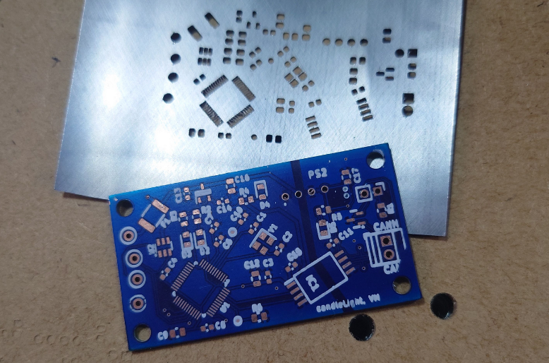

I've always been intrigued by the possibility of making circuit boards at home. So when I got a CNC machine, one of the first things I wanted to try was fabricating custom-made circuit boards. I focused on creating a reliable process that can be easily followed and is almost guaranteed to produce same result over and over again.
Despite it being a DIY process, I was still interested in creating boards that are somewhat comparable to commercial ones, which meant having a soldermask, and (to some extent) silk screen. At the same time, I was not under the illusion that it will ever match what you can get from many online PCB fabrication places, but it's sufficient for most hobby applications.

So far, this process has been reliably test out on components as detailed as LQFP48/64 package. This means package size of 10x10mm and pads of ~1.2x0.25mm, spaced 0.5mm apart.
(source: https://www.ti.com/lit/ds/spms376e/spms376e.pdf, p.1404)
This was also used as an inspiration for design rules when making a PCB. Namely, minimum trace size of 0.2mm and clearance of 0.2mm.
Here's few of the examples made with this process:

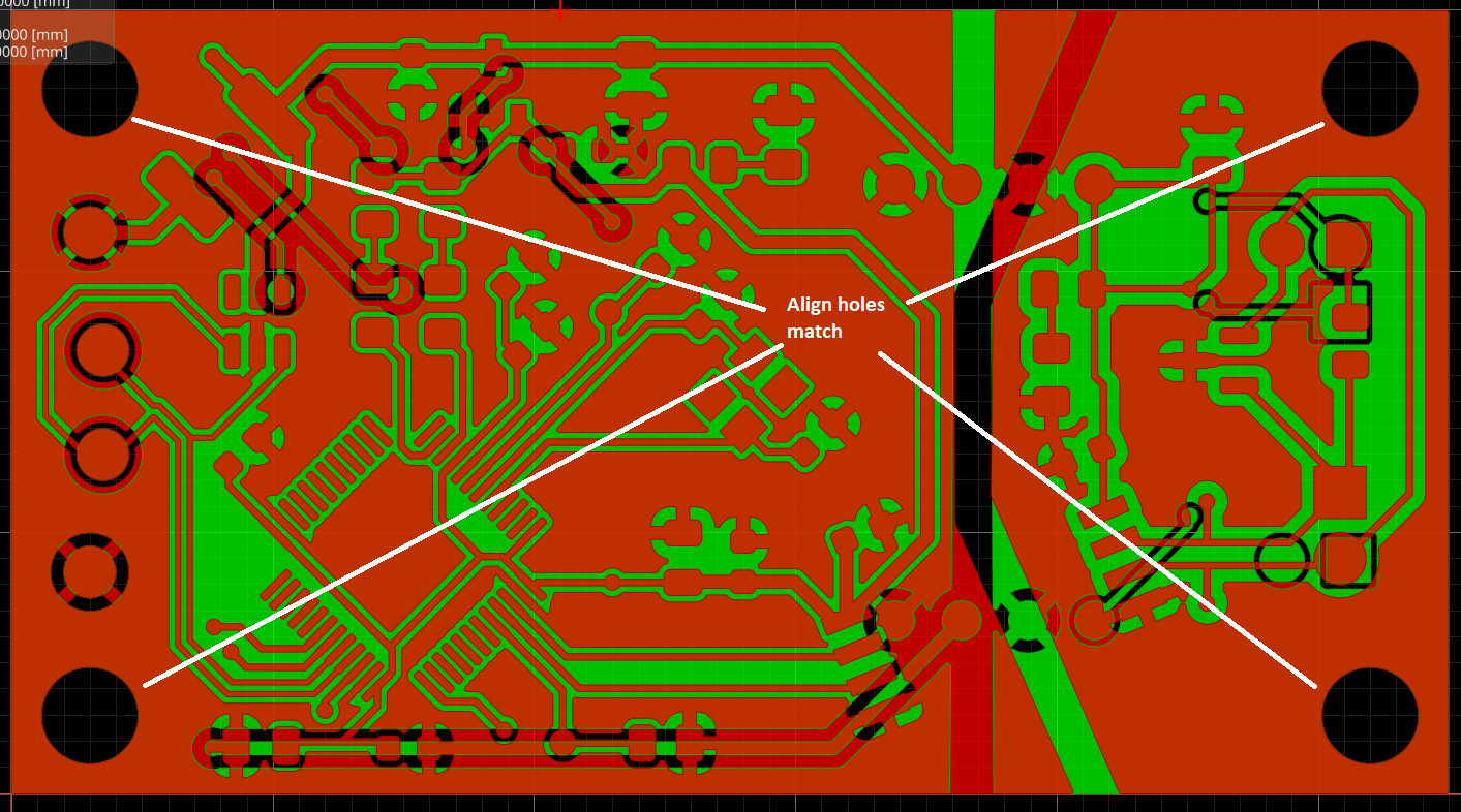

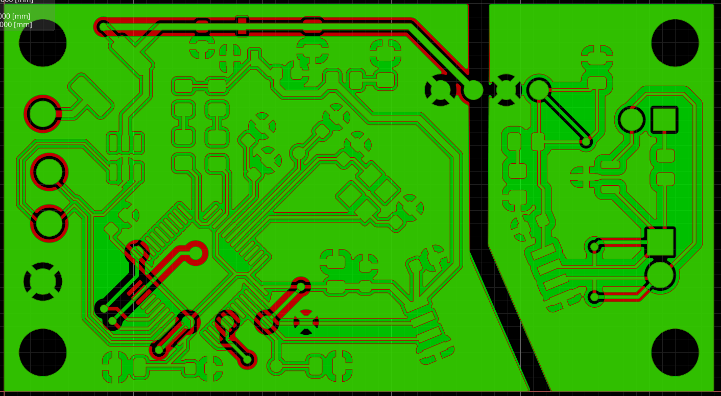

    Next, import back copper layer. Before generating geometry and job, the imported gerber object needs to be flipped in either X or Y axis. I prefer flip around Y axis.
    To do so, double-click imported gerber object, and press "Transformations" button from the side menu. From there, press "Flip on Y" from the "Mirror (Flip)" side menu. Using the 4 align/mount holes, confirm alignment between the front and back copper layer.
    Before back layer Y flip
    After back layer Y flip
    From here on, repeat the isolation routing and copper clearing steps in the same way as for the top layer.

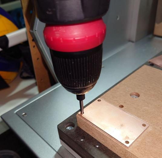

    Fixture + Cutout

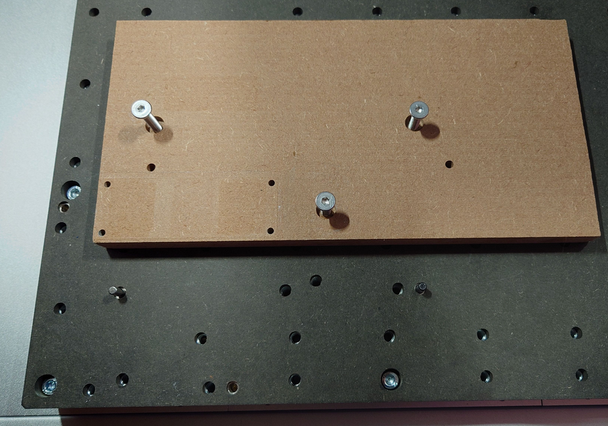

    To work with PCBs, I create a fixture that aligns on carvera bed using pins, and is fastened with 3 screws (file attached here). This fixture has also been milled so that its top face is flat. On the fixture, the bottom-left hole is placed at coordinates (5,5) from the anchor point 1, and it's where I'll have my bottom-left align hole for the PCB.

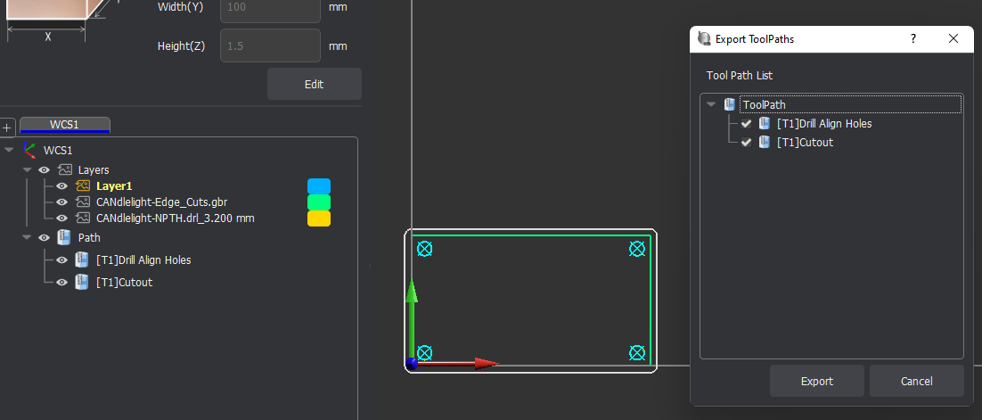

    I always start a PCB project by adding a raw PCB to the fixture, drilling the align holes and cutting the board to the correct size. To create CNC job for that part, I use MakerCAM. Import EdgeCuts and NPTH layers from KiCAD export into MakeraCAM. Select the align holes, and create "Vector Drilling" task for them, end depth of 10mm (to go through the board and create align holes in the fixture for later). Secondly, select the edge cut vector, and create "Vector Contour" job with end depth of 1.6mm. Both the holes and the cutout are made with 1/8" x 12mm single flute bit, in my case set as tool #1. Export both toolpaths together in a joint file, and import to Carvera controller.
    When running the job, set the offset from anchor point in controller such that the bottom left mount hole on the PCB aligns with the bottom left hole in the fixture. I always place that hole on PCB at coordinates (3,3) from origin and since the align hole on fixture is at (5,5), it gives an offset of (2,2).

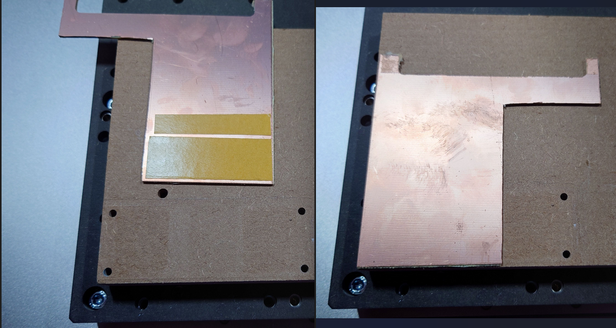

    The PCB is secured to the fixture with double sided tape.
    Once the job is completed, clean up the dust chips from the board and leave it stuck to the fixture. Use the newly made holes and a 1/8" bit to test the alignment on at least 3 holes at the time. The holes might be a bit tight at this point, you can carefully widen them with a 45 deg chamfer bit in a hand drill.
