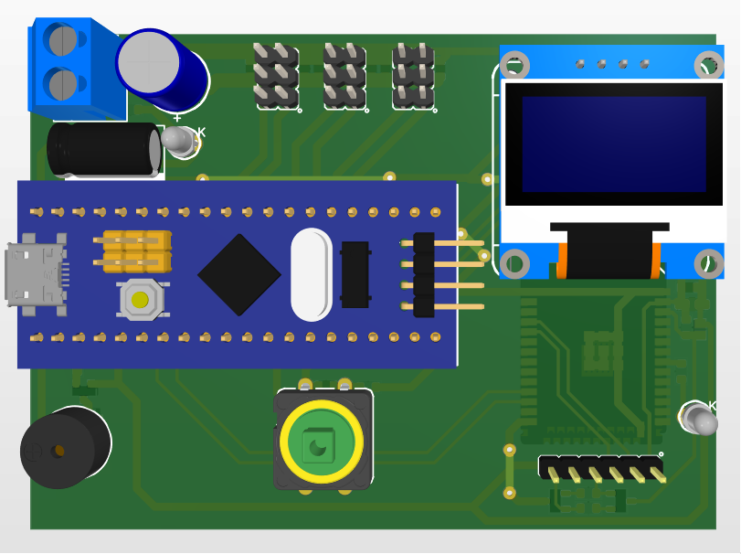

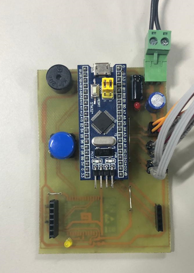

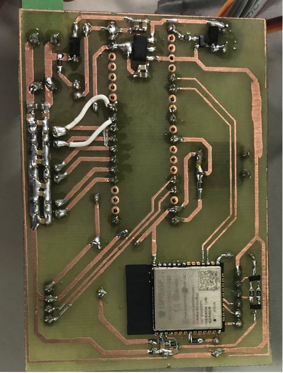

 PROJECT PCB AND EXPLANATION

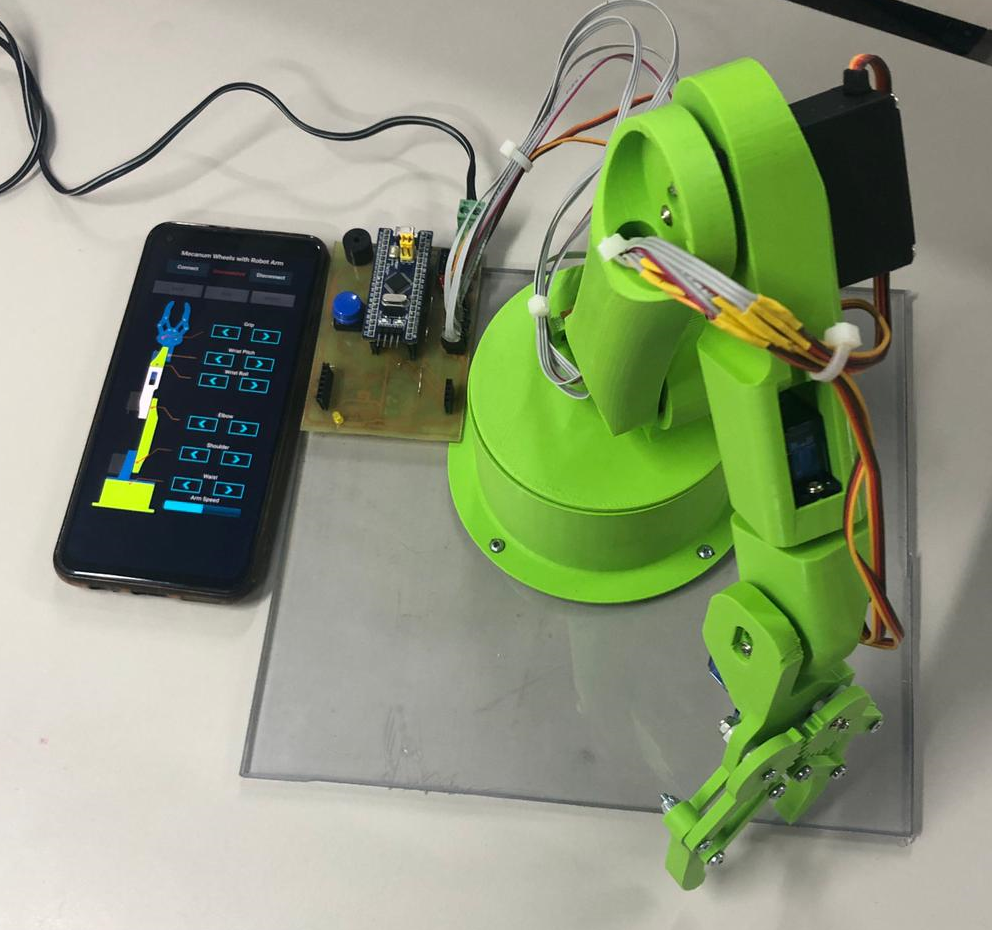

HOW TO WORKING:
In this project, the STM32 microcontroller receives commands from the ESP32 Bluetooth module and transmits motion commands to the servo motors. The servo motors connected to each joint of the robot arm are programmed to move at certain angles using PWM with the TIMER channel. The user can control the robot arm via the mobile application.
Software Development In the software part, the firmware developed for STM32 focuses on Bluetooth communication and servo motor control. The main topics are as follows:
  1. - Receiving data via Bluetooth
  2. - Interpretation of incoming data
  3. - Controlling servo motors with PWM signal
  4. - Integration with user interface

 Bluetooth Robot Control App Developed With App Inventor
This application, developed using App Inventor, provides a simple and user-friendly interface for controlling your robot via Bluetooth.
Also below is the arduino code file to be installed in esp32. You can use it like a bluetooth module in this project using esp32 wroom.
