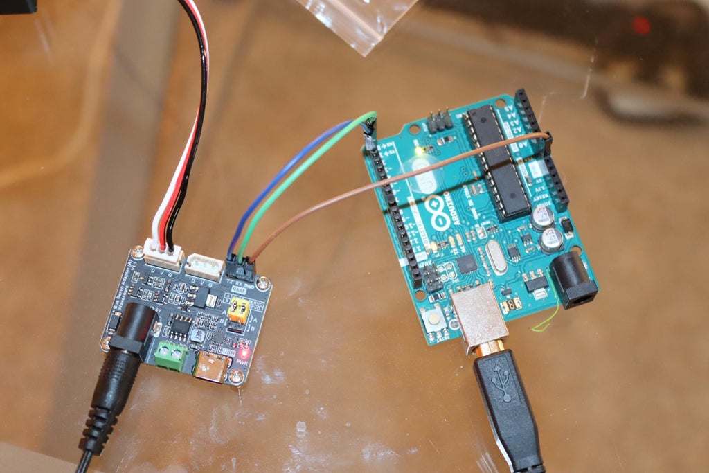

The Arduino uses two pins for serial communication, receive and transmit (pins 0 and 1). The serial servo uses one pin for both receive and transmit. Something has to give. A serial bus driver board (around ten dollars) receives the input from the Arduino and does the electrical magic necessary to talk to the servo motor.
To connect the Arduino to the bus driver board, pin 0 of the Arduino goes to "receive" on the bus driver board. Pin 1 of the Arduino Uno goes to "transmit" on the bus driver board. Ground on the Arduino goes to ground on the bus driver board. The bus driver board is powered by a 12 volt, 2 amp power supply.

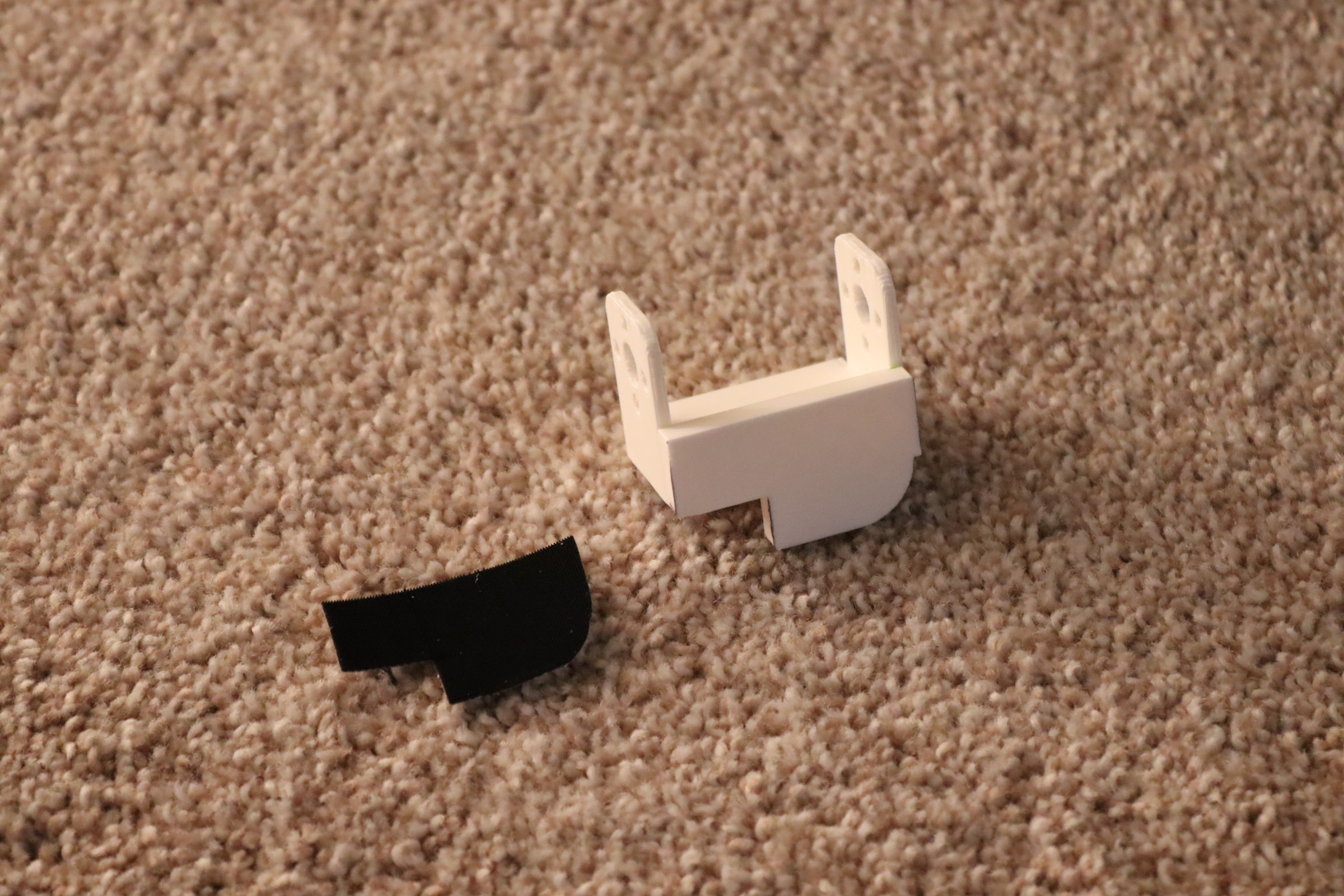

After figuring out the basics, I 3d printed a few connector pieces and assembled the hand.
