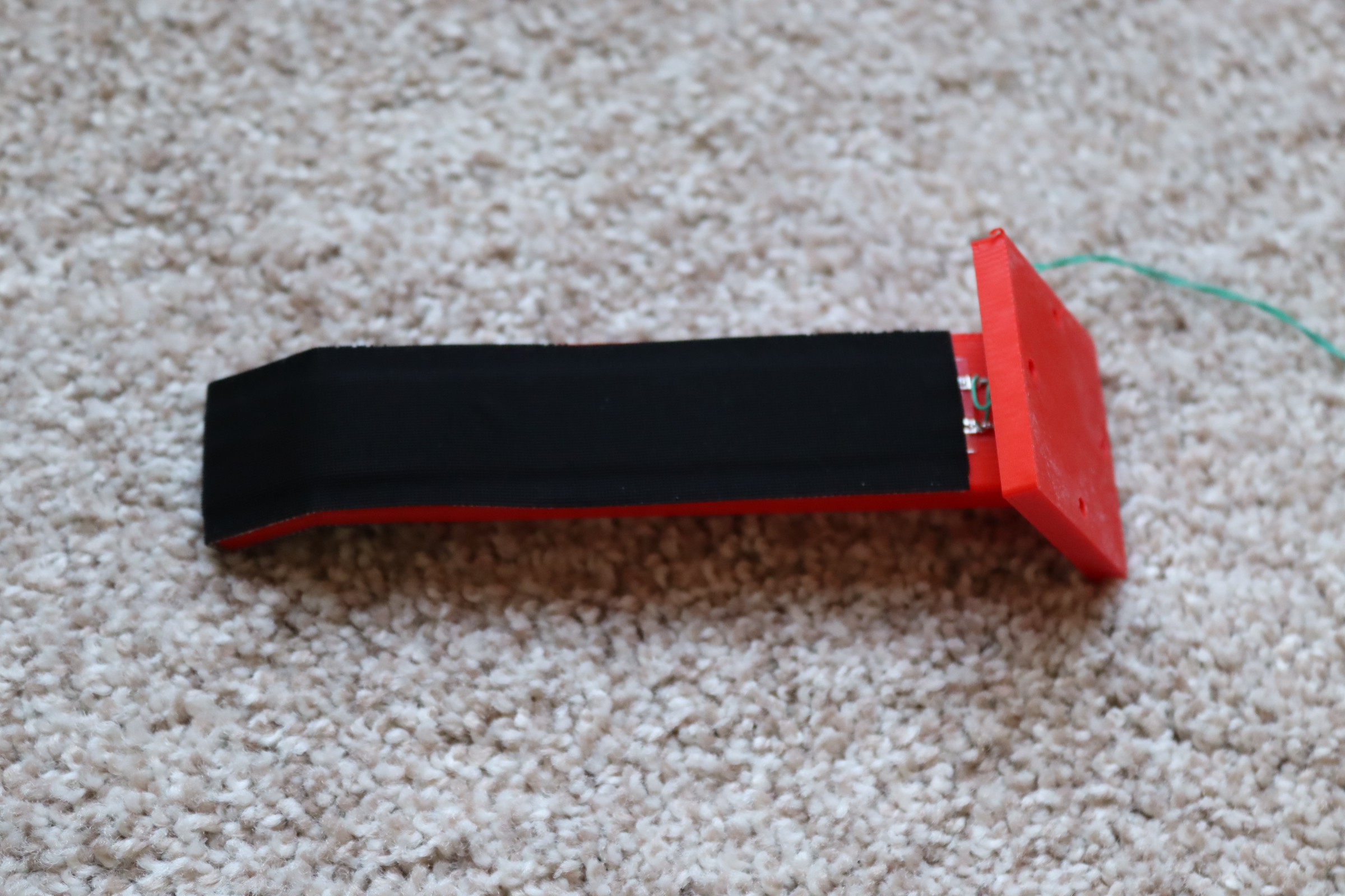

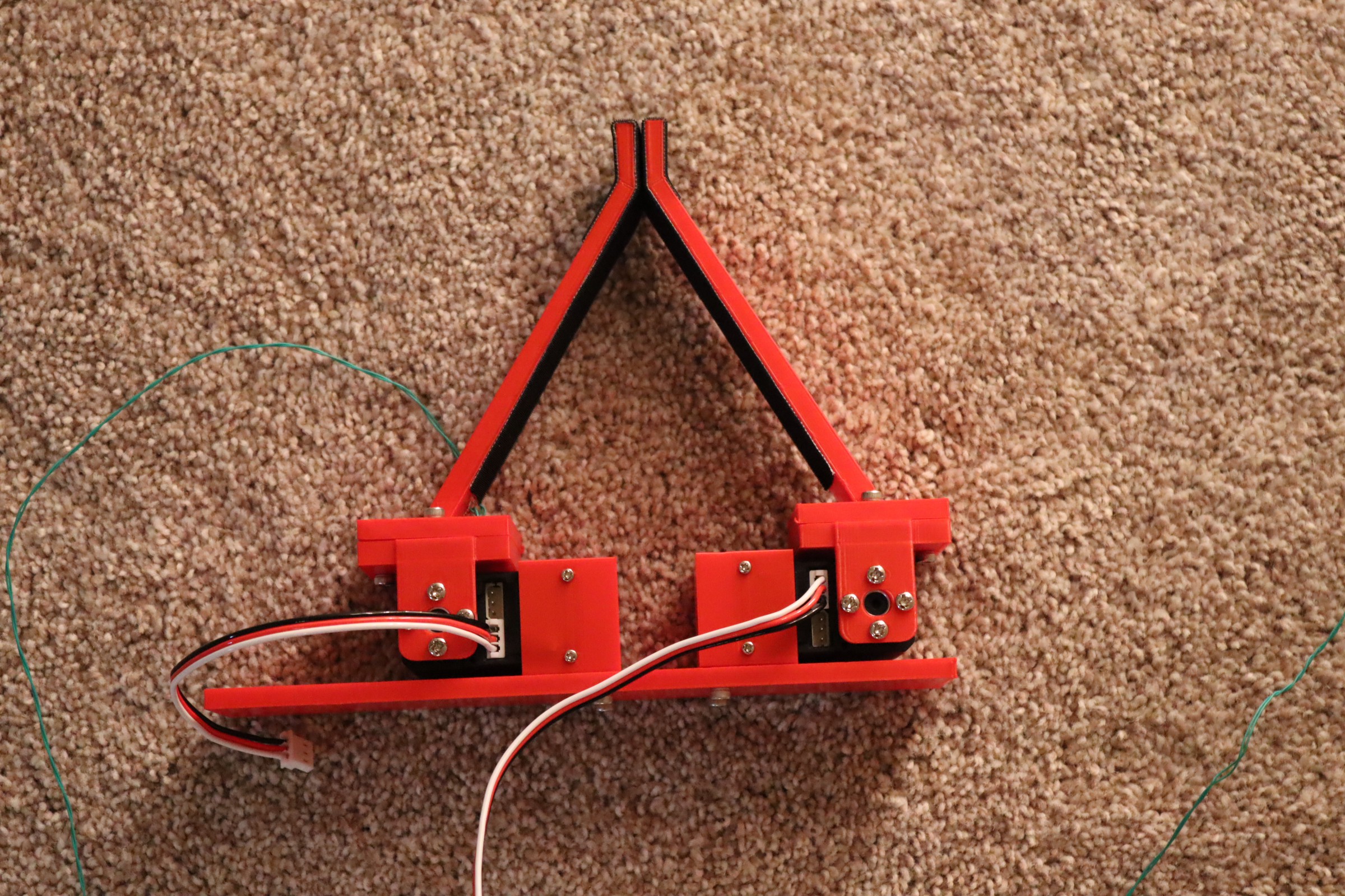

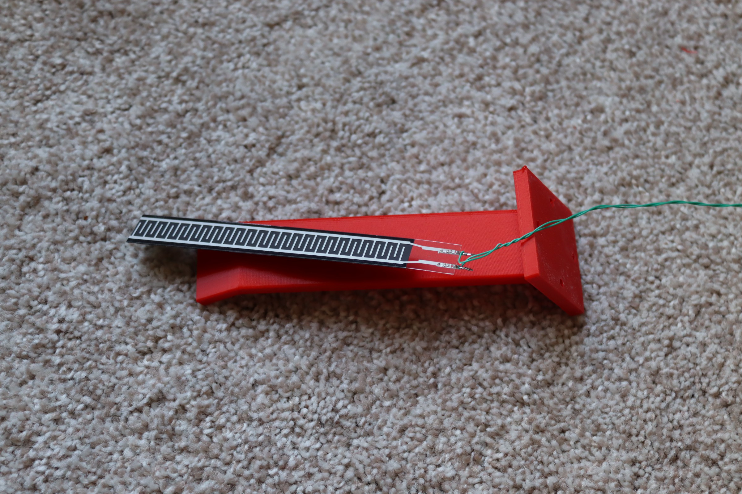

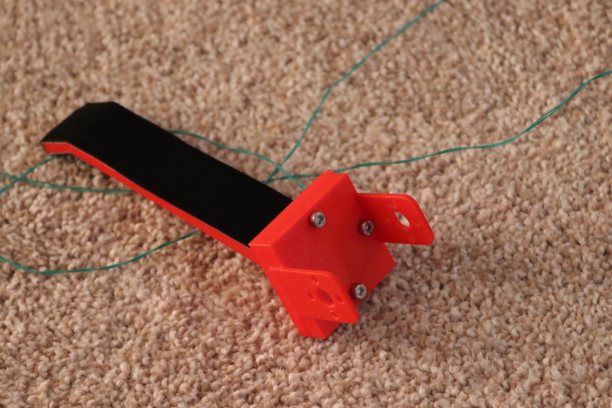

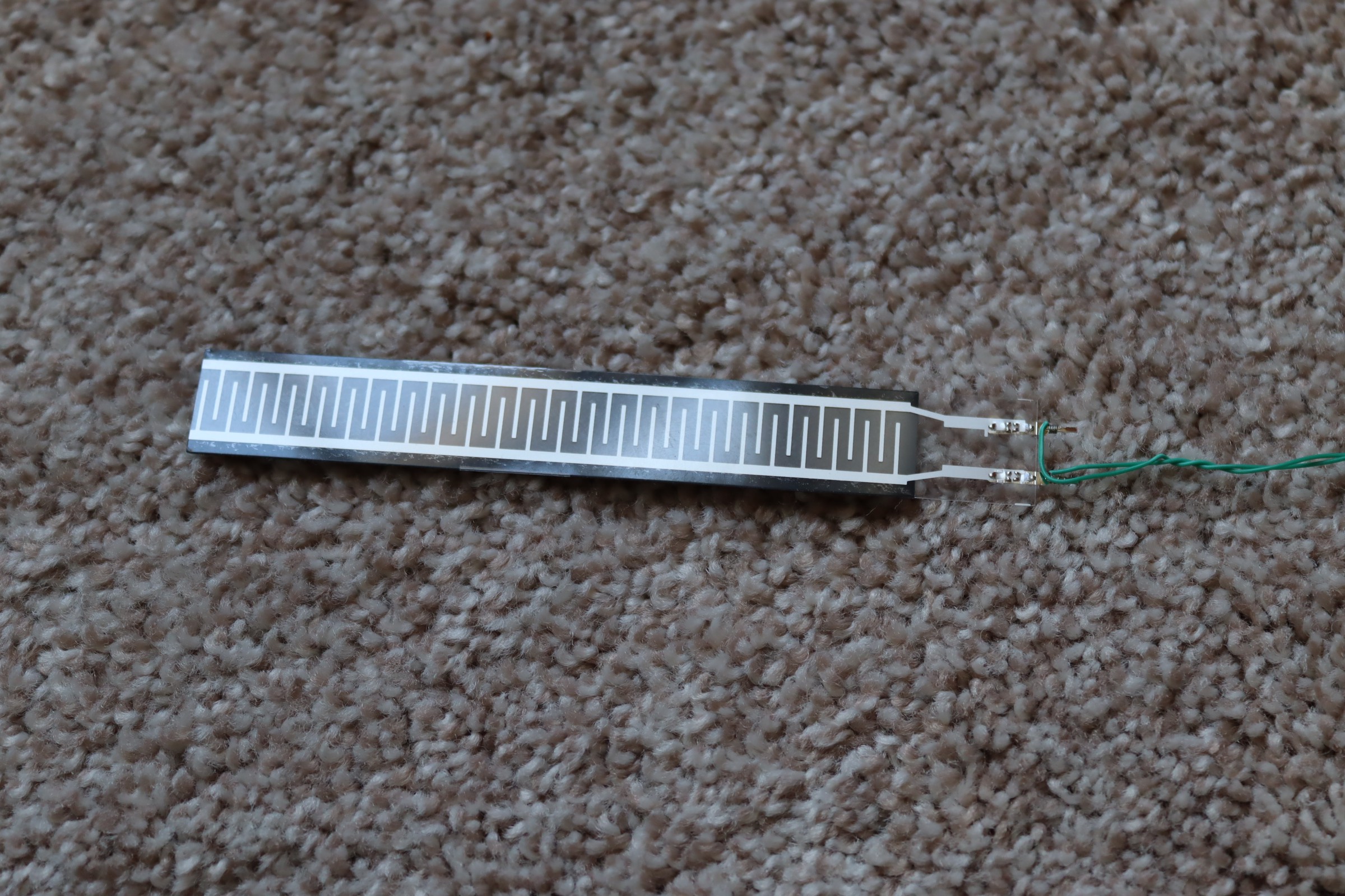

Hackaday.io Hackaday.io
Sign up Log in
Robot Gripper
This robot gripper with a pressure sensor uses two serial servo motors controlled by an Arduino to close and grasp an object.
mike-rigsbyMike Rigsby
Following Follow project
Liked Like project
Become a Hackaday.io member
Sign up with Github
Sign up with Twitter
OR
Forgot your password?
Just one more thing
Pick an awesome username
hackaday.io/
Pick a few interests
Choose more interests.
OK, I'm done! Skip
Join this project
689 views
0 comments
8 followers
10 likes
  • Description
  • Details
  • Files 11
    • View all
  • Components 0
  • Logs 0
  • Instructions 0
  • Discussion 0
View Gallery
689
0
8
10
Team (2)
  • mike-rigsbyMike Rigsby
  • stevesteve
Join this project's team
ongoing project
Related lists
otros
otros varios
This project was created on 03/24/2025 and last updated a year ago.
Description
I'm working on robot grippers to be used as the "hands" on humanoid type robots. This particular unit needs only to have the selected object placed between the grippers--then a command to "close and grasp" will cause the fingers to close until pressure is sensed. Control is managed by using an Arduino Uno.
Details
Files
two_finger_automatic.ino
ino - 3.78 kB - 03/24/2025 at 21:28
Download
two finger backbone.stl
Standard Tesselated Geometry - 20.20 kB - 03/24/2025 at 21:27
Download
two finger backbone.f3d
fusion - 46.54 kB - 03/24/2025 at 21:27
Download
direction switch.stl
Standard Tesselated Geometry - 94.03 kB - 03/24/2025 at 21:27
Download
direction switch.f3d
fusion - 228.64 kB - 03/24/2025 at 21:27
Download
View all 11 files
Log In/Sign up to comment
Become a Hackaday.io Member
Sign up with Github
Sign up with Twitter
OR
You'll learn how to construct your first Arduino robot car and create your chassi.
Project Owner Contributor
Arduino Robot Car
fcodiegomoreirafcodiegomoreira
The 2016 Hackaday Prize
Robot control in ultrasonic and simple alarm pir and system calcule distense in ultrasonic and lcd
Project Owner Contributor
Arduino
micro-technology-makerMICRO Technology MAKER
An arduino based robot
Project Owner Contributor
Robot
bigbatbigbat
You will learn how to build a robot tank with Arduino
Project Owner Contributor
How to Make a Tank Robot with Arduino
fcodiegomoreirafcodiegomoreira
Going up?
© 2026 Hackaday
Yes, delete it Cancel
You are about to report the project "Robot Gripper", please tell us the reason.
Send message
Remove Member
