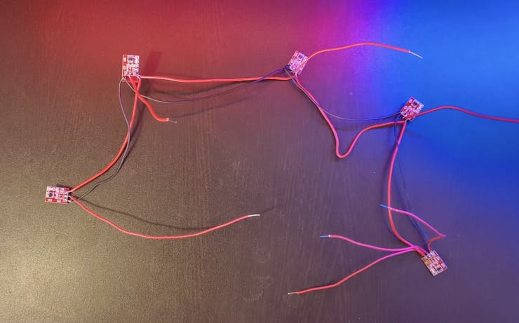

    Next, we'll prepare the touch sensors with some soldering.
    Follow these steps:
    • Ground (GND) Connections: Solder all the GND pads of your touch sensors (five, or the number corresponding to your colors) together. Use enough wire between each sensor to allow you to position them freely later.
    • Power (VCC) Connections: Similarly, solder all the VCC pads of the sensors together, again using sufficient wire lengths for flexibility.
    • Signal (I/O) Connections: Attach a single wire to the Signal (I/O) pin of each individual sensor. These wires will be connected to the microcontroller, so ensure they are of adequate length for easy placement.

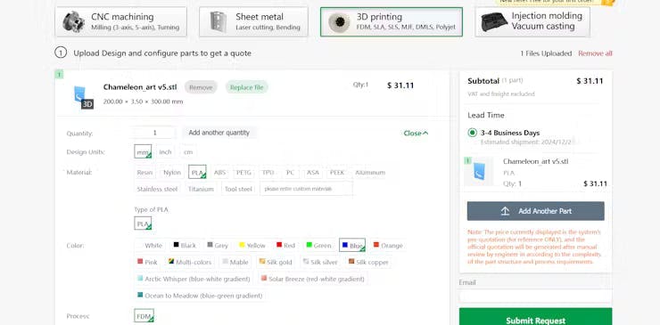

    Here are the steps to get your project 3D printed by Justway's 3D printing service.
    First, head over to Justway's 3D printing service and select 3D printing. You also have options like CNC machining, injection Molding and Urethane Casting. But for this project, we will use the 3D printing service.
    Click on "upload your design". A new page will appear. Here, you need to click on "Select CAD files" and upload the STL file.

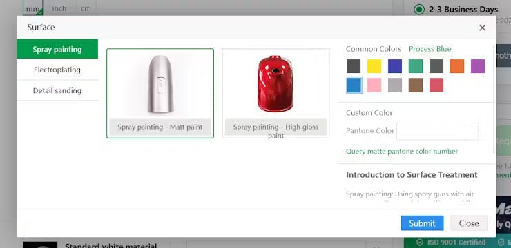

    After that, select the Quantity, Material (I recommend PLA or ABS for this project). In the color section, you can either select white and paint it later, or select the color you like directly in the 3D print. This will save time later.
    Finally, after selecting all the options, you can enter your email and submit the request to get a quote.
    Justway is a great option, especially for complex prints which might be tricky to print at home with low-end printers. Plus, you get options like surface finishing and resin 3D prints.
