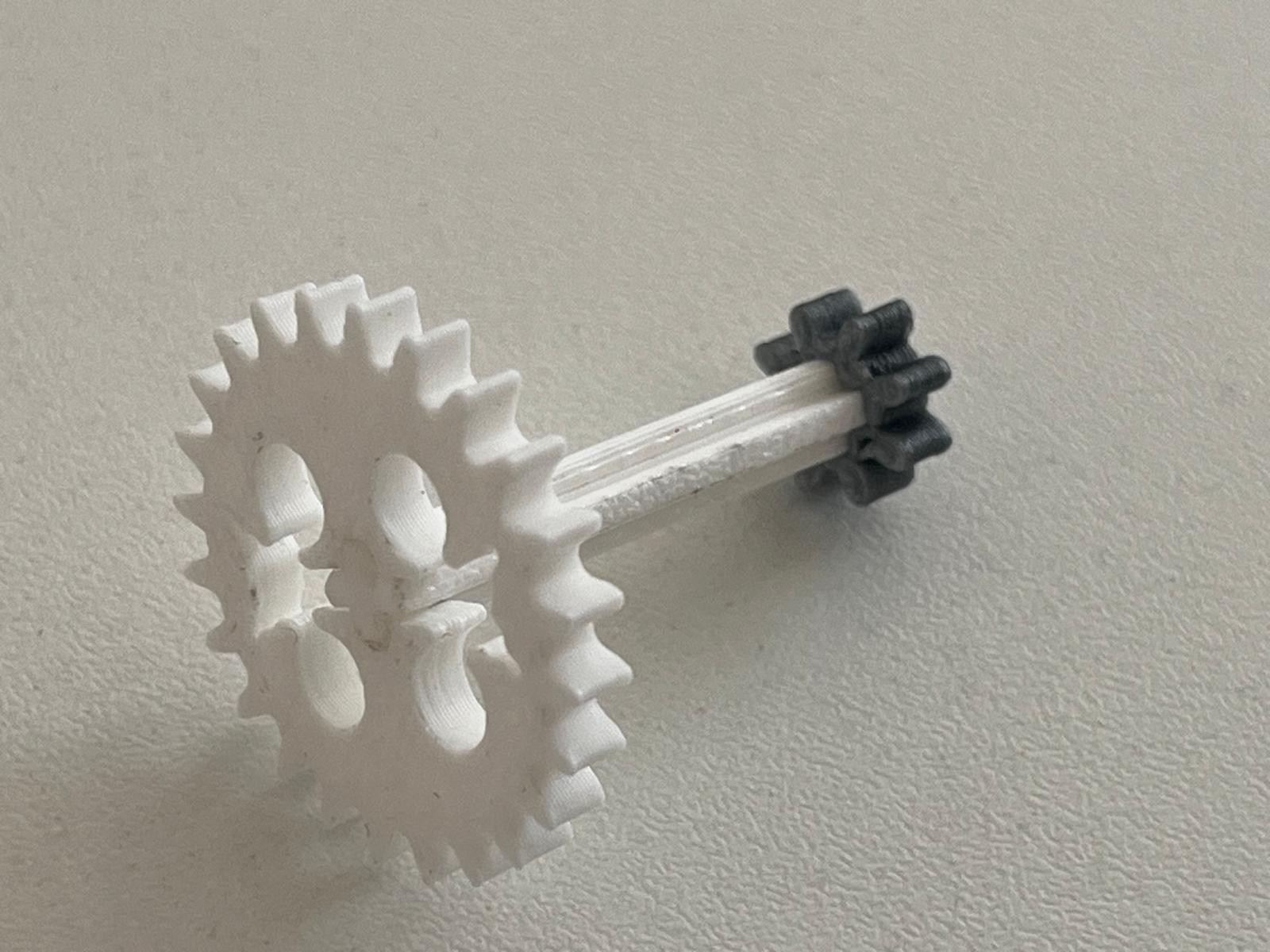

    For the fourth week we 3D printed the pieces that we needed to control the translation motion.
    The 3D printing was messy for the gears, the reason was that the gears were really tiny, less than 8 tooths.
    This part is for the Ballast System
    Here is the gear nested in the axle, this will be attached to the 24teeth_Gear.
    Now that we have the gears and the axle we can 3D print the rails to pilot the moving part of the syringe.
    The gears will be translated to the rails.
    If you have the occasion, maybe, try with a resin printer and not a 3D printing for the little pieces
    ( Go to the files and open : Rail1_Syringe.STL , Rail2_Syringe.STL Axle_Syringe.STL, Gear_24Tooth.STL, Gear8_Tooth.STL)

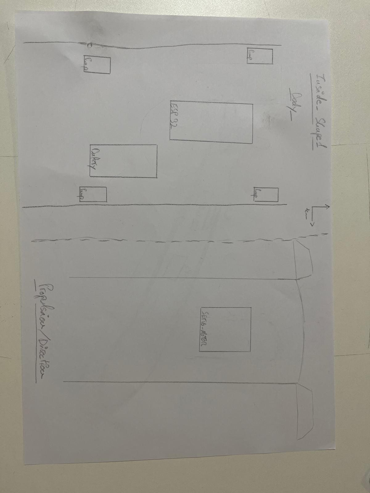

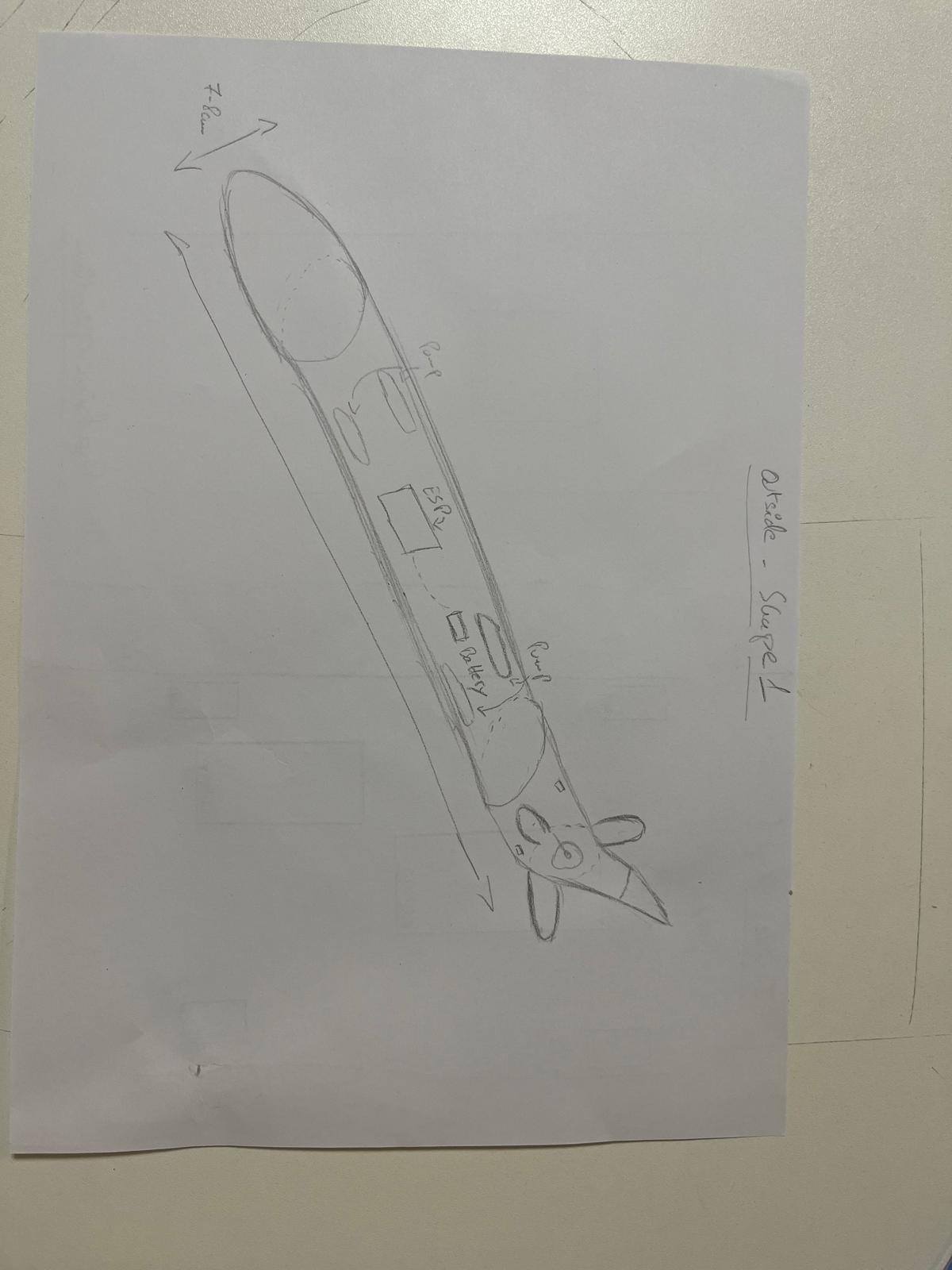

    We also make some sketches to have an idea of the size
    For the next week we will have to find a tube, in preference a transparent tube to see how the submarine works. Also make some research for the buoyancy.
