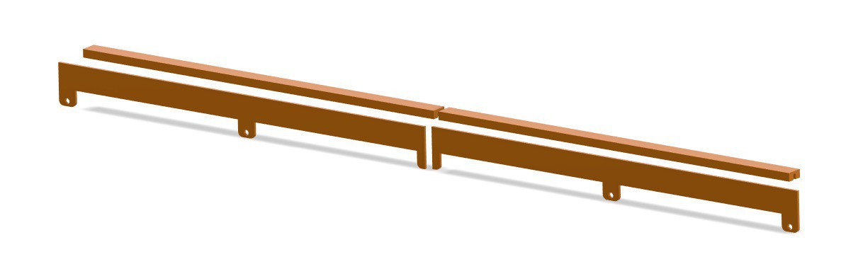

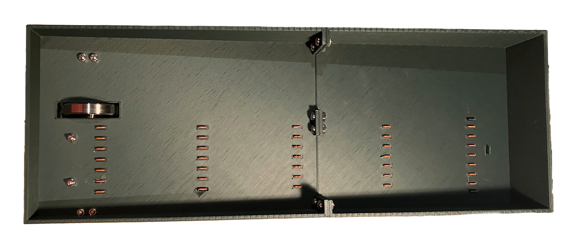

Again the rails had to be printed in two pieces because build plate. In addition the vertical rail and the rail "cap" that goes on top were printed separately so that the vertical piece could be printed on its side to maximized the strength of the tabs used to attach them to the body. Like the body the splits between the cap and rail were in slightly different positions to strengthen the join when they are glued together.
