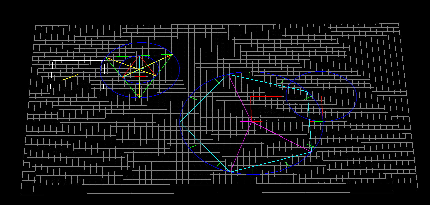

A quick screenshot shows where things are right now, graphics-wise.  Eventually, I will post the code for a file named euclid.cpp, which has grown to about 1500 lines, just to get stuff done like finding bisectors, perpendiculars, parallels, points of intersection and so on.
void euclidian::draw_clock ()
    fpoint minute_marks [60];
    dodecagon hour_marks;
    pentagon penta;
    hour_marks = construct_dodecagon (true);
    penta = construct_pentagon (true);
    euclidian::bind(*m_host,hour_marks);
    hour_marks.on_draw (false,true);
    fpoint center = hour_marks.m_center;
    fpoint radial = hour_marks.m_points[0];
    m_host->draw_polygon(center,radial);
 An idea comes to mind, therefore, about a possible correlation to Moore's law, and that is the idea, I think, that it sometimes becomes possible to get exponentially more stuff done as more capabilities are added.  Maybe that is a variation of Metcalf's law? We can, of course, now combine the idea of drawing a hexagon with the idea of bisecting the internal angles thereof, in order to be able to compute our hour marks.  Yet at the same time, now we can also consider how to use the fact that 12 and 5 are relatively prime with each other, so as to consider how to draw twelve rotated pentagons, if that is what it takes to generate the minute marks.
dodecagon euclidian::construct_dodecagon (bool draw)
    fpoint pt0,pt1,pt2,pt3,pt4;
    dodecagon decca;
    hexagon hex = construct_hexagon (false);
    int i;
    double len1;
//    first copy the even points over
    decca.m_center = hex.m_center;
    for (i=0;i<6;i++)
    decca.m_points [2*i] = hex.m_points [i];
    pt0 = decca.m_center;
    for (i=0;i<6;i++)
    pt1 = decca.m_points [2*i];
    pt2 = decca.m_points [(2*(i+1))%12];
    pt3 = bisect (pt0,pt1,pt2);
    len1 = fpoint::length (pt0,pt1);
    pt4 = fpoint::extend0 (segment (pt0,pt3),len1);
    decca.m_points [2*i+1] = pt4;
    return decca;
Here, it is easy to see that all we needed to do to get the hour marks is to start with a hexagon, and then bisect the internal angles, and extend the bisector line segments until they are the length of the appropriate radius.  Perhaps the code for drawing a rectangle would have more utility if it were possible to generate, position, and also rotate a collection of small rectangles, so that these can, in turn, be used, perhaps with OpenGL, for example, to obtain a more pleasing 3-dimensional view.  Of course, as much fun as branchless programming is, eventually it does become useful to sneak some loops in.   Maybe someday, I will try to hide some, if not all of the looping code, in some kind of scheduler.   That would generally be very bad for an inner loop, but if enough functions were actually called from some kind of loop manager, then maybe that could be put to use, if I wanted to make videos about Euclid's methods, for example.  That will have to wait for now.  Even though it also would help with the prospect of having a clock that you could give natural language commands to, like "When the sun comes up, dispense cat food."
