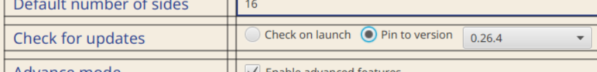

    Kevin Harrington12/21/2025 at 20:16 0 comments
    Thanks to some help from @rondlh I added version pinning to CaDoodle. Unlike pervious update, you will need to gett the latest installer from: https://github.com/CommonWealthRobotics/CaDoodle/releases for this new feature to work. You can pin your CaDoodle to a specific version, and CaDoodle will not use any internet connections whatsoever from first click to working application.
    Current releases of CaDoodle include a zipped up copy of the online assets needed by cadoodle, in the git cache directory that CaDoodle expects them to be in. The instaaller downloads this zip with any new update, and the Application unzipps the zip into the correct location each time it loads to ensure the assets match the version this application expects to be there.

    Kevin Harrington09/21/2025 at 16:37 0 comments
    You can set the number of sides in the settings menu, and all new shapes will default to that number when you drag them into the UI.
