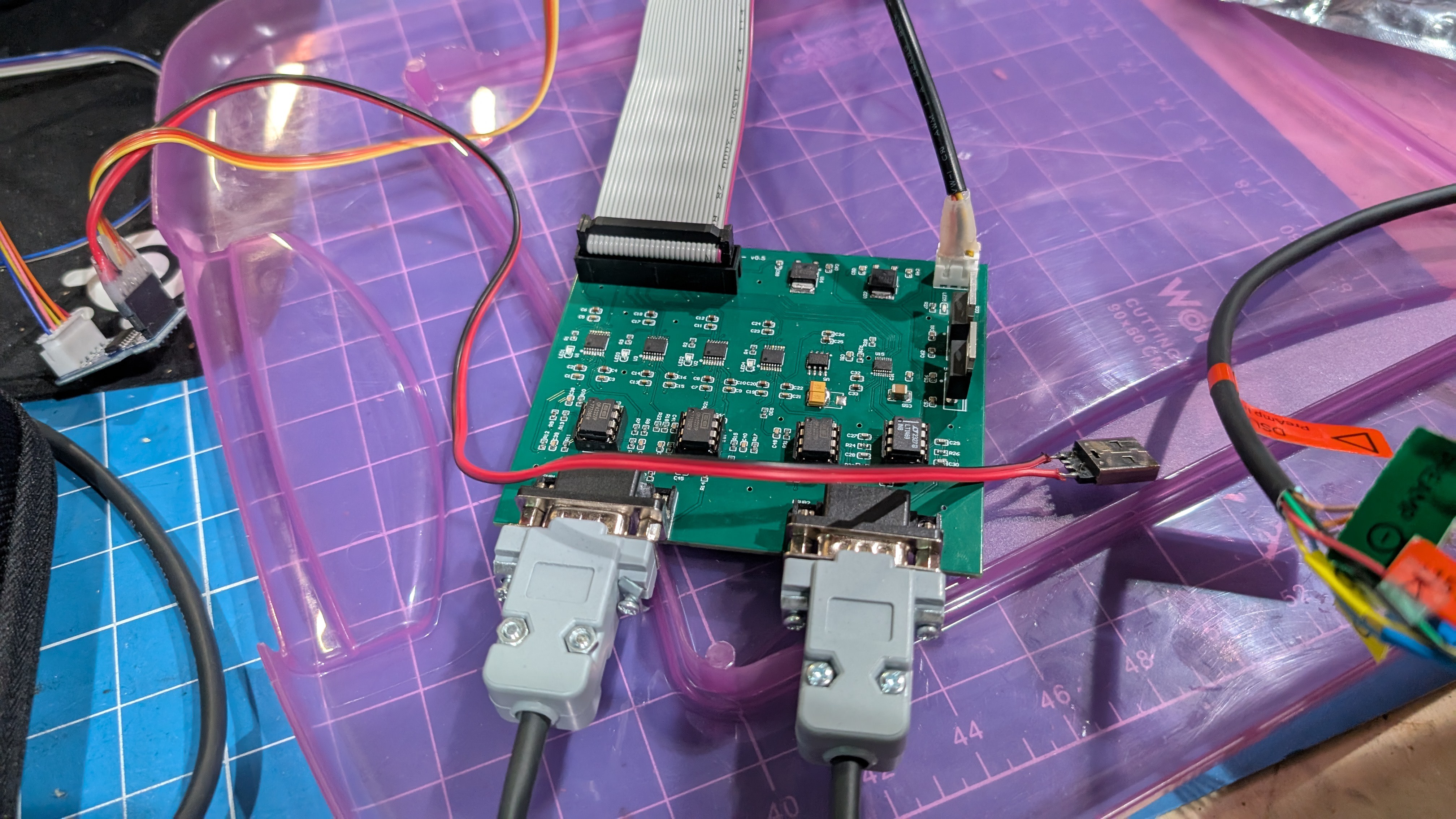

We have determined that there will be at least one, and possibly a second more refined version of the project. For sure in the first project, we largely continue to get inspiration from MechPanda and Dan Berard's work, meaning that we are only doing minor tweaks to update components. We are fighting the urge to dramatically rework any systems until we have a baseline. The bare circuit board for the controller board remains largely the same, though the BOM has been updated. We identified the following boards:
Controller Board (CAD documented)

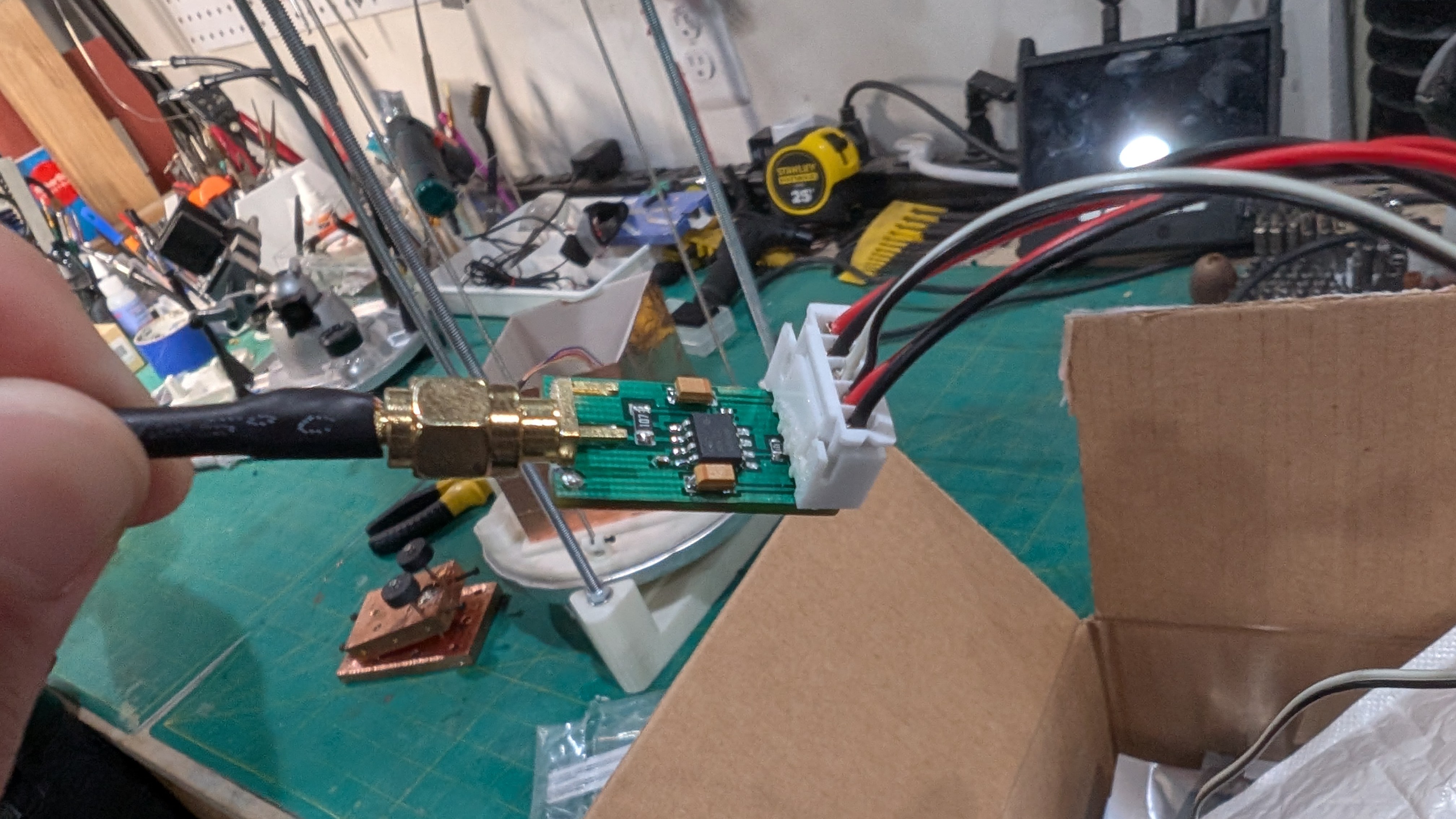

Preamplifier Board

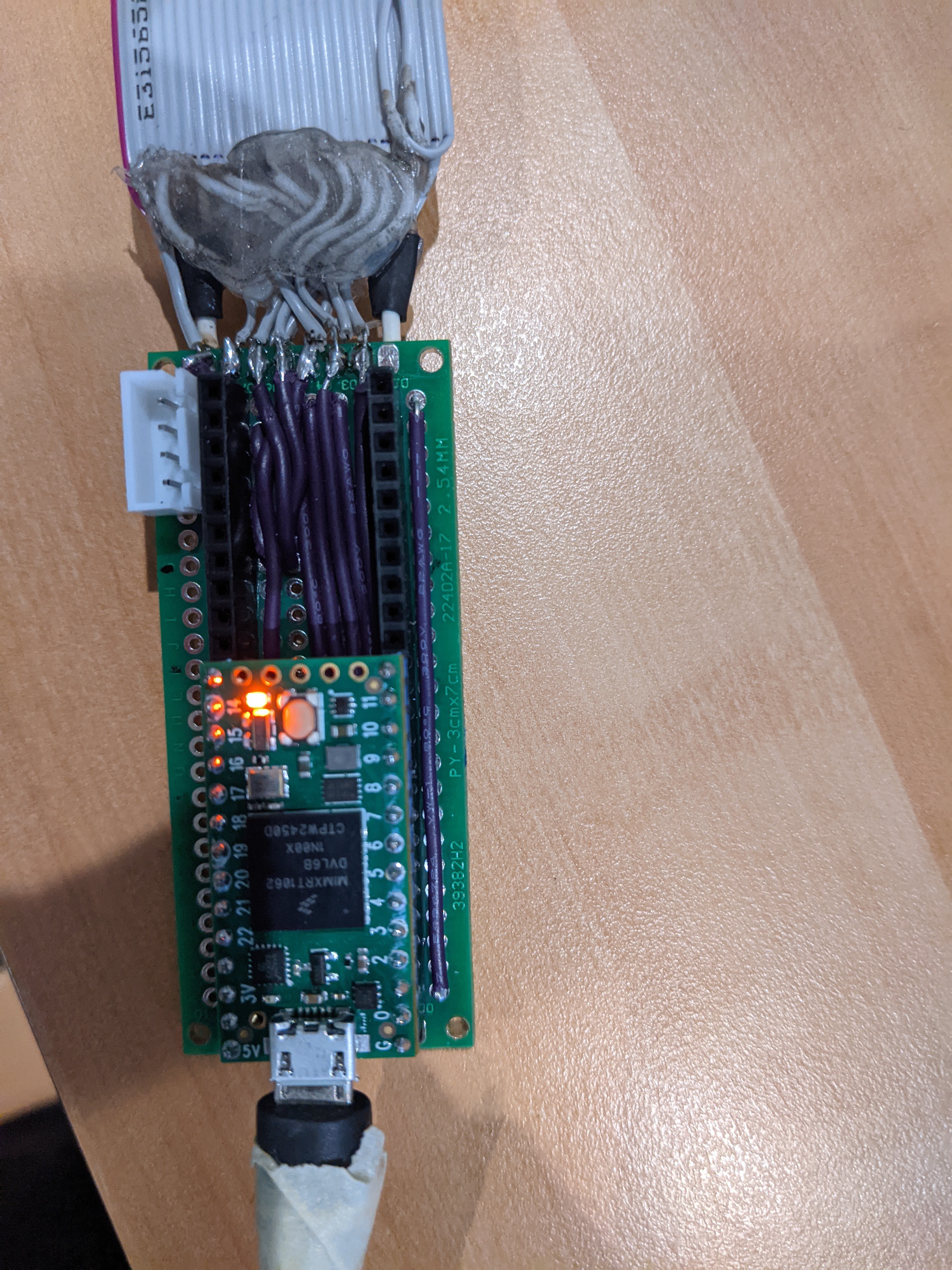

Microcontroller adapter board (simple pins breakout for a Arduino Teensy 4.1 done with protoboard)

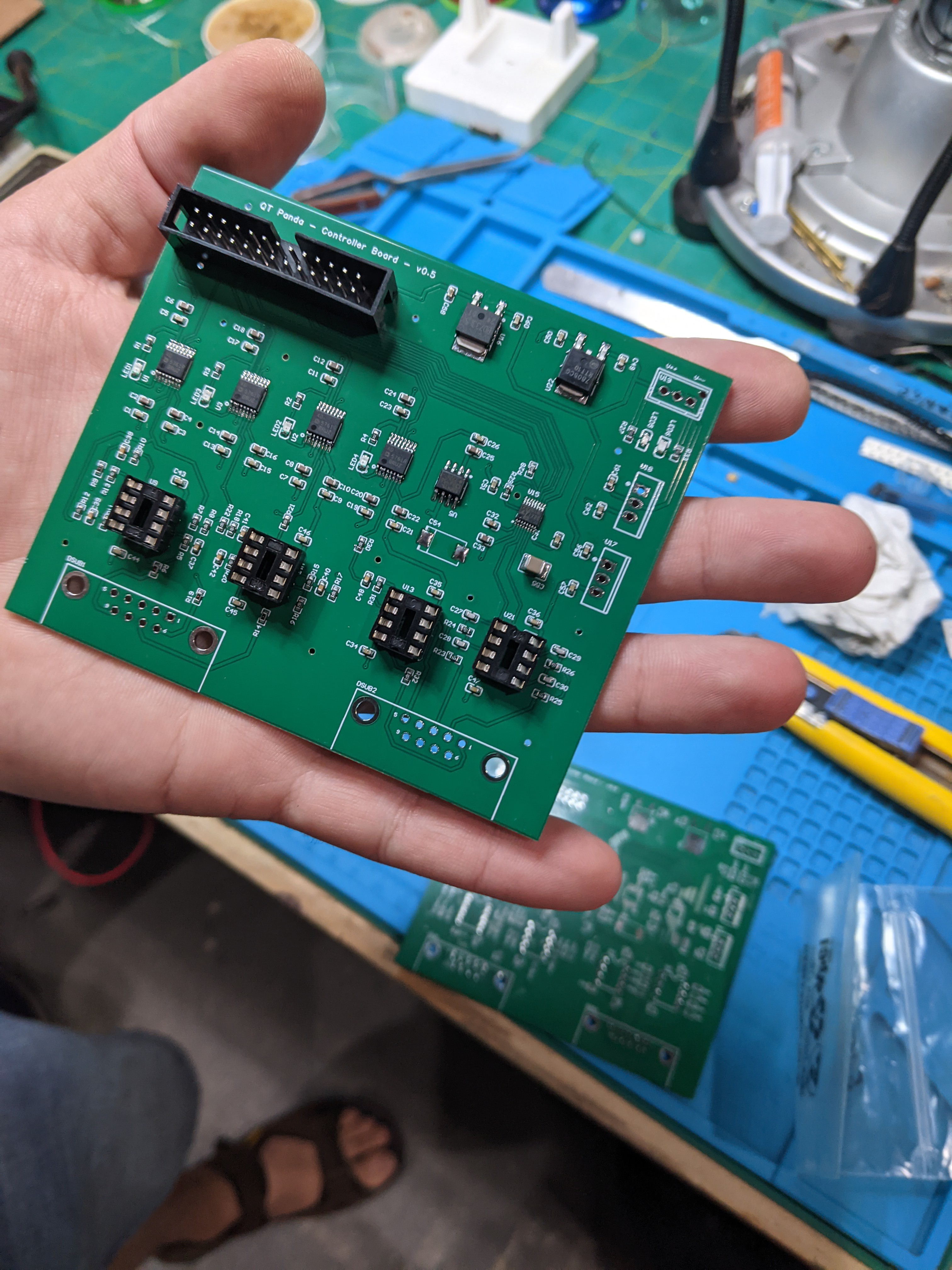

Controller Board
The bare board was largely unchanged from Dan's design. However as mentioned components were updated. We will release an updated BOM and project files when we are further along in our testing, but feel free to reach out and ask for it any point. Preamplifier Board

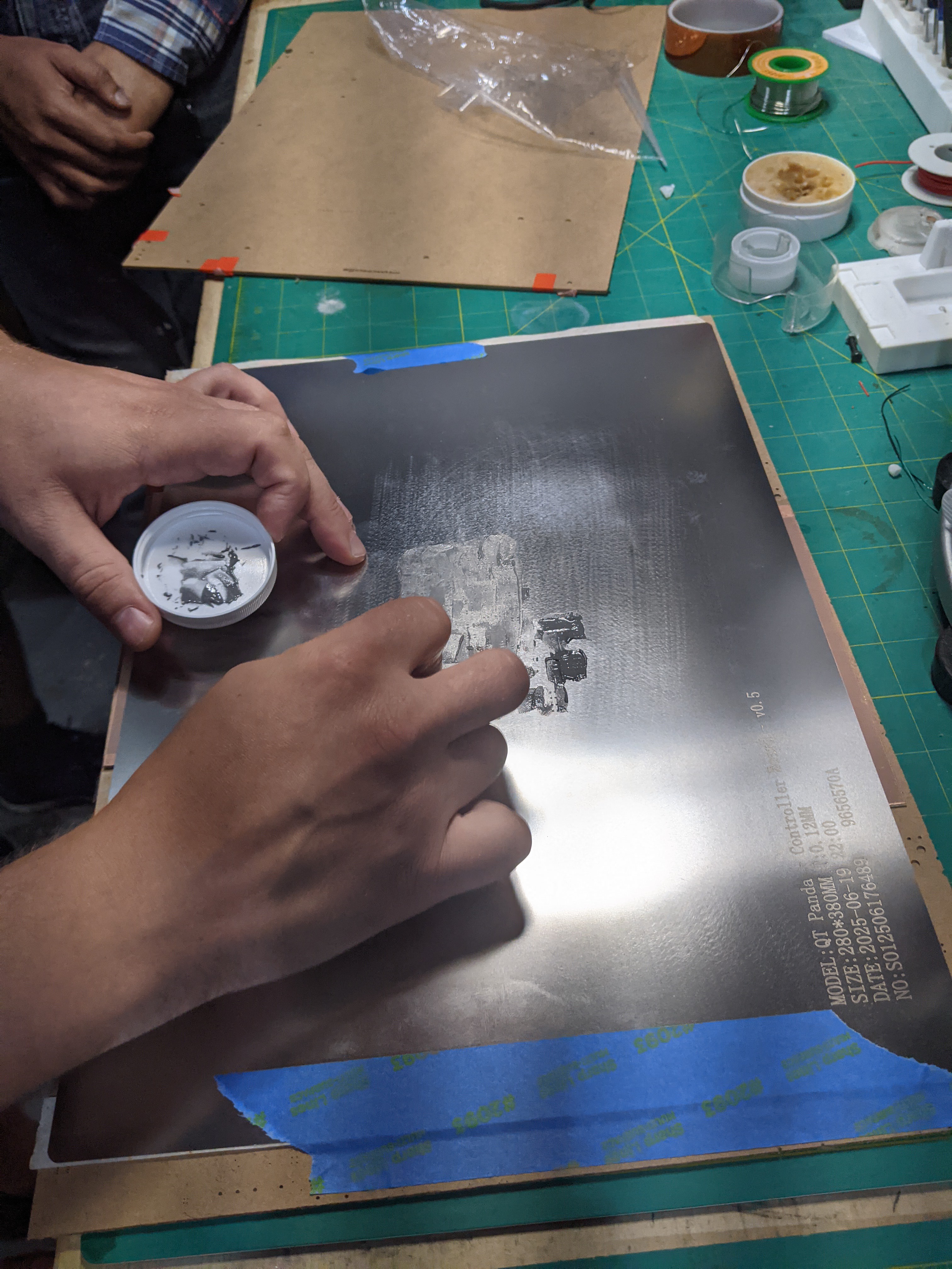

Note that we are testing out using a coaxial cable for the sense wire. Otherwise this board was made manually from bare copper stock board, using at-home PCB design techniques. We'll circle back and have a CAD-style version in a final files release. Power management module
Notice that this is now a barrel jack power input from a wall outlet. This power chip is net-new for our project, and we'll be releasing the design files for this as well! This was also an at-home crafted circuit board prototype.
This is just mapping the Teensy pins to the Controller Board through a cable, and this can be done by referencing the Teensy code, and the Controller Board schematic.
