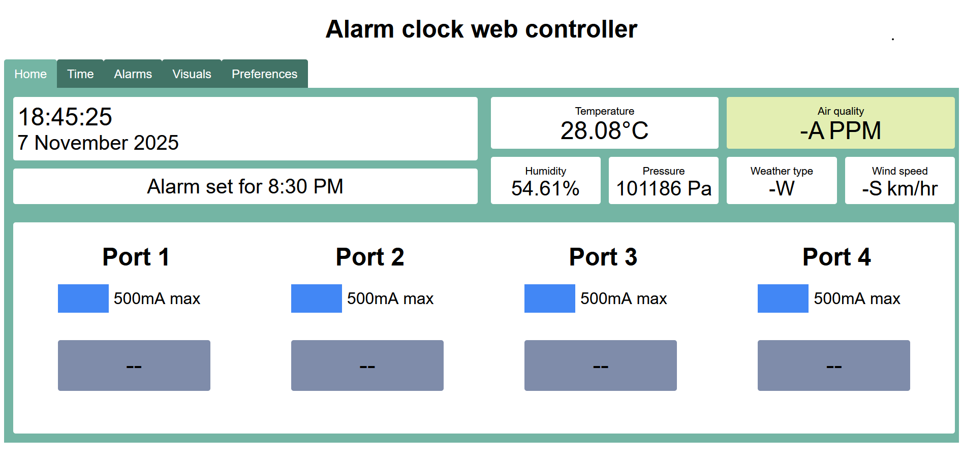

    Web Interface
    A picture of the web interface, with time and weather data being separated into different panels, plus a non-functional section for controlling the USB ports. Currently, only the time, date, temperature, pressure, and humidity work.

    I've made some progress with the project (albeit slowly because I'm kind of busy). Right now I've managed to get some basic time and weather info being displayed on a 240*320 LCD and a web interface. Next step is to get the alarm system working and improve the UI on the LCD. Stay tuned!
