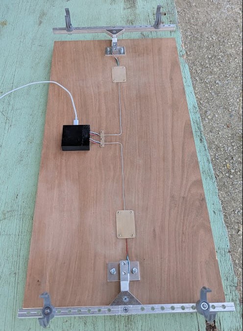

LoadCells
I have choosen two 2kg loadcells. This is a good balance between sensitivity an max load. Most of my planes are gliders in the range 200g to 3kg. As the total weight of the plane is almost shared on the two scales, 3kg will put max 1.5kg on each scale... 2kg load cells add some safety margin !
These devices need an amplifier HX711 to adapt their output.
Connection between load cell and amplifier follows this schematics:
Plane stand and scales
The plane will be sitted on a stand, its wing leading edge touching the vertical side of the stand.
The stand itself  will be put right above the two loadcells. Perpendicularity of feet must be insured so that the horizontal bars of the stand are trully horizontal. This is mandatory for accuracy of the "moment" computation
Both the stand and the scales must be adjustable in width and lenght to accomodate most of the RC planes.
building the stand
As you can see the length "L"  is measured between the two vertical sides of the stand.
Here is the stand with a small foamy flying wing:
The stand can be 3d printed or laser cut. Both options are available.
If you choose the laser cut option (what I did) then cut the “CoGfinder_flat.dxf” file into 5mm plywood. Then glue each foot with 3 parts (the slot one in the middle). Let the glue dry and drill the...

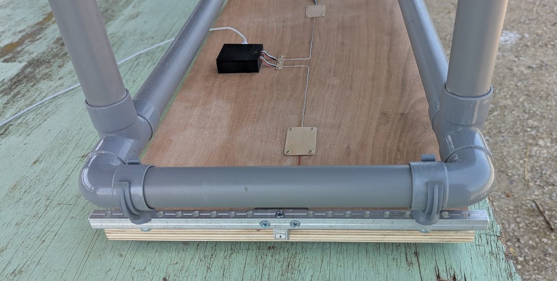

    Jean-Philippe is a "big planes" builder. He used to build more than6m gliders !
    So he built an XXL CoGfinder. He designed the plane bed so that it could sustain more than 40kg and used consequently 20kg load cells.
    His bed was built with 5cm PVC pipes and  "clipped" on the CoGfinder;
    The software was strictly the same , simply calibrated with  10kg weight
    And It proved to work on his very big ASW15 21 kg glider.
    CoG was found with an accuracy of 1mm compared to his previous measure. The CoGfinder is thus fully qualified for big planes !
