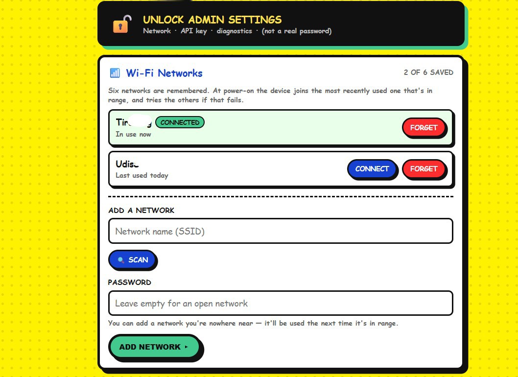

  • Six Networks, Because Teachers (obviously) Move
    Udi Tirosh09/01/2026 at 11:34 0 comments
    This one is by popular demand: teachers using VA5 in classrooms kept asking for it.
    VA5 remembered just one Wi-Fi network. That's fine on a bench. It is not fine when the device  moves between a classroom and a library on different access points, or goes home with a teacher for the weekend.
    Every move meant the same ritual — power on, wait fifteen seconds for the connect to time out, join VOICE-AGENT-XXYY from your phone, and retype an SSID and password with your thumbs. And because the old firmware erased the credentials it had just failed with, you did the whole thing again in the other direction on the way back. That erase was reasonable-looking code with a wrong assumption behind it: a failed connect almost never means a wrong password. It means the access point is rebooting, or you're out of range.
    So VA5 now remembers six WIFIs
    (I was not sure about the numner and am still undecided on 6-7)
    At boot it scans, keeps the saved networks that are actually in range, and joins the one you used most recently. If that one doesn't answer it tries the next, and only opens the setup portal once they have all failed. Nothing is ever erased for failing — an access point that was switched off for a week is still in the list when you come back to it.
    Two things fell out of that which turned out to matter more than I expected.
    You can add a network you're nowhere near. Type in the staffroom SSID and password while you're still at home, and it gets used the first time it's in range. A device can be handed to somebody already knowing where it's going.
    (Plus) Holding the push-to-talk button while powering on jumps straight to the setup portal. No waiting on a device patiently working through six networks that aren't there.
    It's in v0.14: https://github.com/iollama/Voice-Assistant-5

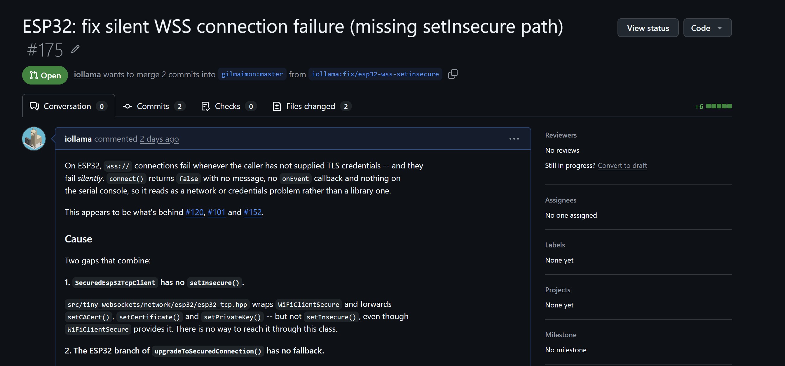

    If you use ArduinoWebsockets on an ESP32 and you need a secure connection, it does not work. Not "is fiddly" — does not work, and does not tell you why.
    What you see is a connection attempt that returns and then simply never becomes a connection. No exception, no useful error, no failed handshake to read. I re-checked the URL, the port, the certificate, the network and the API key before I went looking at the library, which is the wrong order and cost me a weekend.
    There are two bugs, and they interlock.
    One: SecuredEsp32TcpClient has no setInsecure().
    The class wraps WiFiClientSecure but never exposes the one method you need to tell it not to verify a certificate you haven't given it.
        class SecuredEsp32TcpClient : public GenericEspTcpClient<WiFiClientSecure> {
        public:
          void setInsecure() {          // <-- did not exist
            this->client.setInsecure();
          void setCACert(const char* ca_cert) { ... }
    Two: the ESP32 branch of upgradeToSecuredConnection() never falls back.
    The ESP8266 branch has an else that calls setInsecure() when no key is configured. The ESP32 branch doesn't:
        #elif defined(ESP32)
            if(this->_optional_ssl_ca_cert) {
                client->setCACert(this->_optional_ssl_ca_cert);
            if(this->_optional_ssl_client_ca) {
                client->setCertificate(this->_optional_ssl_client_ca);
            if(this->_optional_ssl_private_key) {
                client->setPrivateKey(this->_optional_ssl_private_key);
            } else {
                client->setInsecure();   // <-- was missing
        #endif
    Neither fix works alone. Add the else without adding the method and it won't compile — there's nothing to call. Add the method without the else and nothing ever calls it. That's why this survives casual inspection: each half looks like an oversight you could shrug at, and only together do they explain the silence.
    The net effect is that WiFiClientSecure sits in certificate-verification mode with no CA bundle loaded, so every WSS connection fails verification — and fails in a way that surfaces as nothing at all.
    Both bugs are still present in v0.5.4 and on master. The last upstream commit was June 2024. Bumping the version will not save you.
    The fixes are upstream as PR #175 — six lines across two commits, mirroring what the ESP8266 path already does, and only reachable when no credentials are supplied. If you've been staring at issues #120, #101 or #152, I think this is your bug.
    https://github.com/gilmaimon/ArduinoWebsockets/pull/175

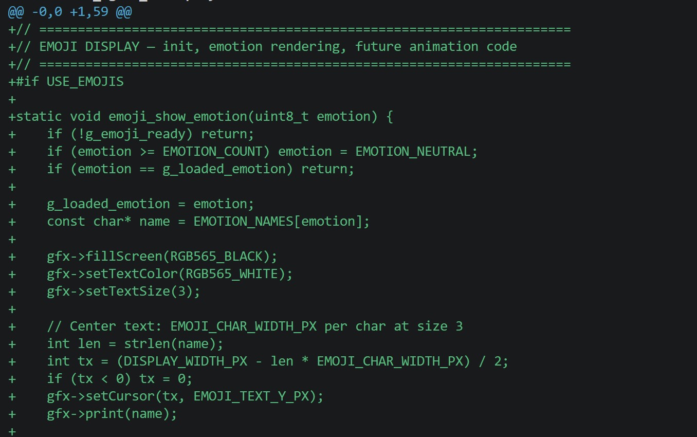

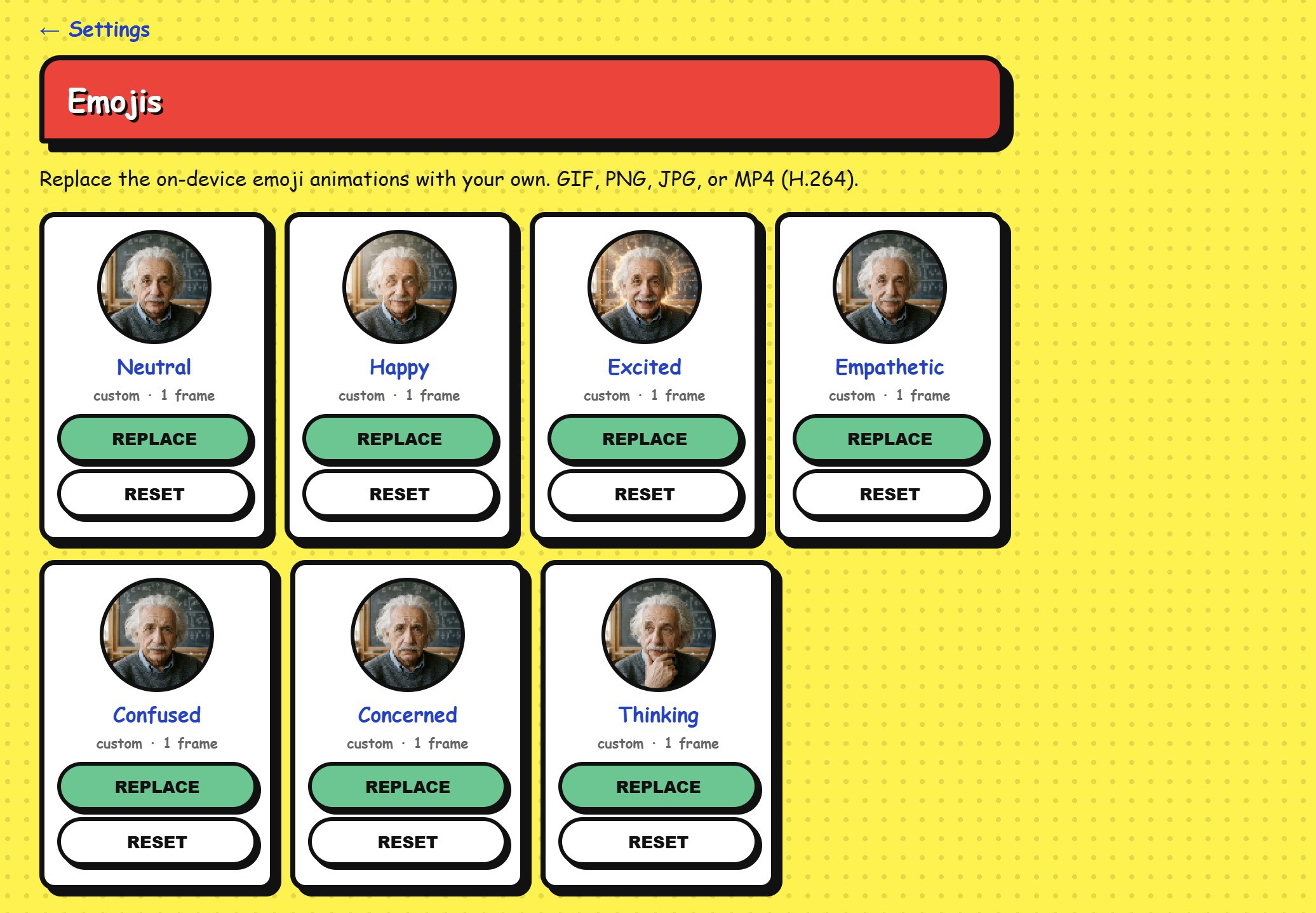

    One of VA5's features that the students love most is its animated emojis. On the technical side, the emoji face is 150x150 RGB565 frames, up to eight per mood, seven moods. Any of them can be replaced with your own GIF, PNG, JPG or MP4 from a page the device serves.
    The obvious build is to upload the GIF to the ESP32 and decode it there. I didn't, and I'd push back on anyone who tries.
    All image work happens in the user's browser. GIF decode, frame extraction, resize to 150x150, RGB565 little-endian conversion, zip pack and unpack — all JavaScript, on the phone or the laptop. The ESP32 only ever receives raw frame bytes, N x 45,000 of them, and writes them to LittleFS. It never decodes an image format in its life.
    That buys three things:
    1. no image codecs in firmware
    2. no PSRAM spent on decode buffers competing with a 1.4 MB audio ring buffer
    3. and when MP4 support arrived in v0.9, it was a JavaScript change rather than a firmware change.
    Two details that matter more than they look.
    • Staged atomic writes. Frames stream into /custom_stage/ and are renamed into /custom/ only once the whole upload validates. A dropped connection mid-upload can't leave a half-replaced mood on screen, and /custom_stage/ is swept on boot in case a previous upload died partway.
    • The defaults are untouchable. /default/ and /custom/ are a two-directory overlay — the loader probes /custom/ first and falls back. The shipped set is never overwritten, so no sequence of uploads can brick the display. Reset one mood or all of them, any time.
    The trade-off, stated plainly: customizing needs your browser online, because the page pulls omggif and JSZip from a CDN. The device itself stays local-only.
    Full source: https://github.com/iollama/Voice-Assistant-5

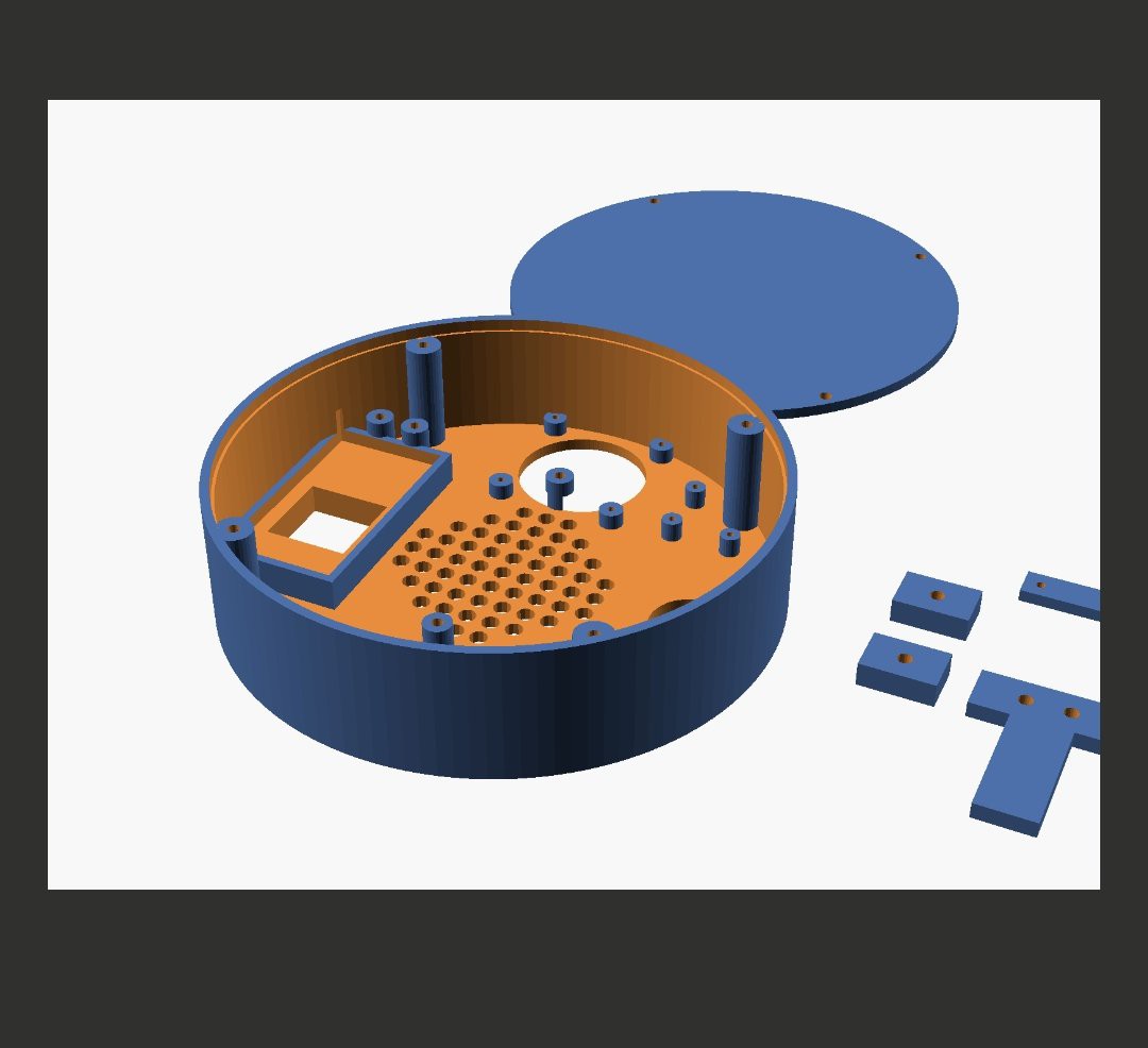

    The breadboard version lived in a laser-cut wooden box. It worked, and I like giving a project a decent box, but a wooden rectangle with a breadboard rattling around inside is not a thing you hand to thirty teenagers.
    So it needed a real enclosure: round, printable, with a mount for every module.
    I'm fine in Fusion 360 — that isn't the problem. The problem is that a box like this is about a day of work, and none of it is interesting. Calipers on six modules, transfer the dimensions, place the bosses, check clearances, discover the speaker fouls the display bracket, go back and move three things. Tedious, not hard.

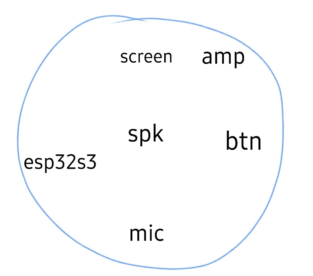

    What made me try something else: Claude already knew this build. I'd been in VS Code with it for weeks on the firmware, so the component list, the pinout and the board dimensions were already in context. It wasn't starting from "design me a box" — it was starting from a project it had been reading for a month. That's the whole trick, and it's the part that doesn't transfer if you open a fresh chat and ask for an enclosure.
    So I drew this on my phone. A circle and six words. No dimensions, no scale, nothing measured — screen up top, amp beside it, speaker in the middle, button right, ESP32 left, mic at the bottom.
    What came back was a complete OpenSCAD script: mounting bosses sized per module, a speaker grille, and — the part I hadn't asked for — cantilever clips to retain the ESP32 and the speaker so neither needs a screw. Then it rendered the model and showed me a snapshot, which is what turned it from plausible-looking code into something worth spending filament on.
    It did need some fixing, mostly for the sizes of the full boards, and getting the rails and the ESP32 cantilever right.
    Then off to the Bambu Lab P1S, and a few prints later, it was done.
    Worth being straight about what this is. It isn't "AI designed my enclosure." It's that the boring 80% — measuring, placing, writing out boss coordinates — is exactly what a model with your BOM already in context can do, and OpenSCAD happens to be the right output format for it, because it's text. I could read the script before I printed it, diff it when it changed, and fix a number instead of re-clicking a timeline. I wouldn't have trusted a binary I couldn't inspect.
    This SCAD box isn't what ships now — once the custom PCB existed, I rebuilt the enclosure in build123d so the board and the case come from one parametric source. But that rebuild took an afternoon, because by then I knew exactly what the box needed to be. This version is what answered that question.
