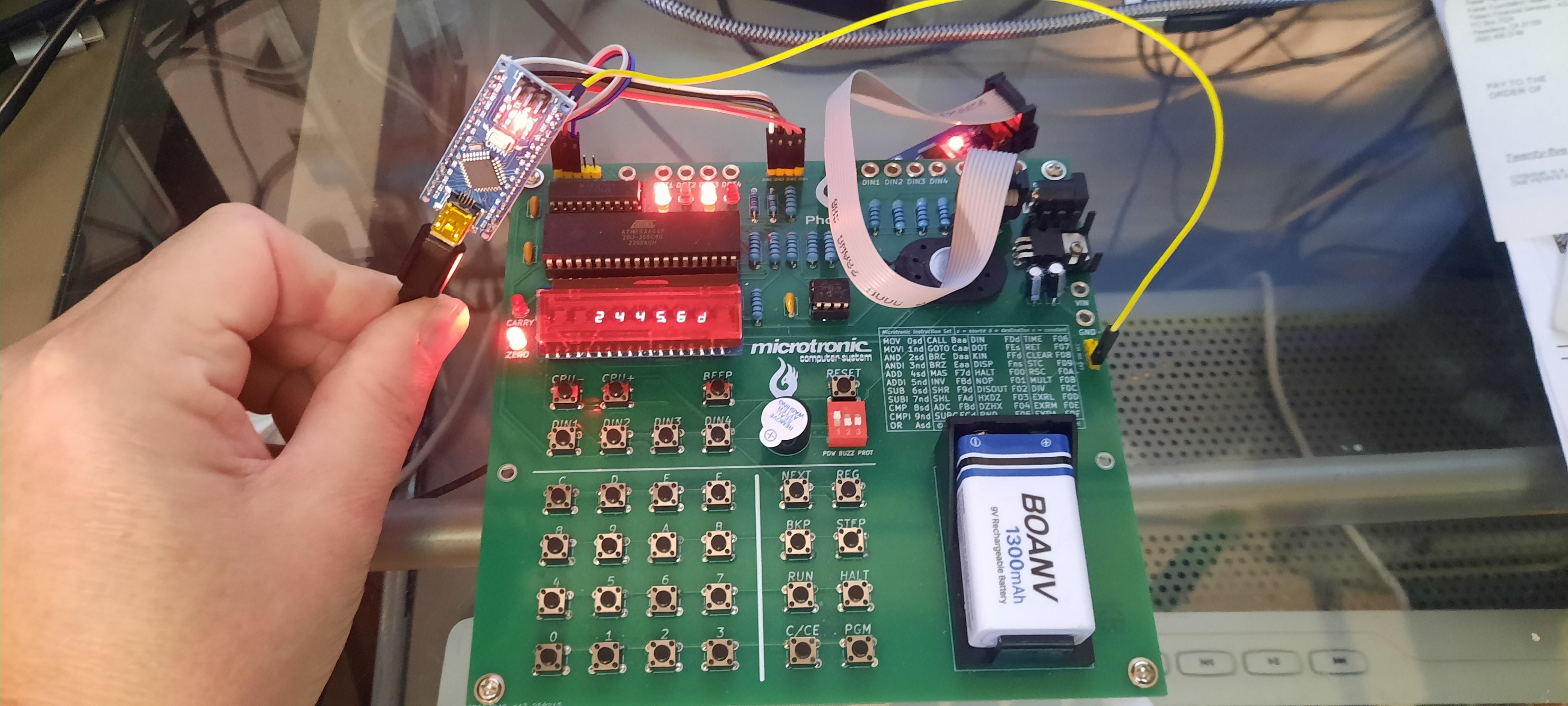

In a previous effort we have successfully recovered the original firmware ROM of the Microtronic - https://hackaday.io/project/197415-microtronic-firmware-rom-archaeology. With the original firmware available, it is now time to let it fly again on modern hardware, resulting in the first fully authentic re-implementation of the Busch Microtronic from 1981! Rise from your ashes, Microtronic!
The Microtronic Phoenix Computer System - A Microtronic Emulator Running the Original Firmware from 1981
Jason T. Jacques: TMS1xxx emulator, prototype hardware design and breadboarding, refined Microtronic firmware dumping, authentic Microtronic firmware emulator running the original Microtronic firmware ROM with a TMS1600 emulator

Unlike previous hardware emulators of the 1981 Busch 2090 Microtronic Computer System, the Phoenix emulator is the first emulator that is not only a re-implementation of the Microtronic, but actually runs the original TMS1600 firmware from 1981.
This breakthrough was made possible by a collaboration of Decle, Jason T. Jacques and Michael Wessel, referred to as "the team" in the following.

The Microtronic is powered by a mask-programmed Texas Instruments 4bit microcontroller, the TMS1600.
Until now, an authentic Microtronic emulator was impossible as the official firmware had been lost to history, and there was no documented procedure for reading out ("dumping") a TMS1600 firmware ROM. Firmware ROMs of related TMS1xxx devices (e.g., the SIMON game, TI calculators, and the Science Fair Microcomputer Trainer) had been retrieved in the past, but the process usually involved destructive die-decapping.
More recently, an alternative to destructive chip decapping was discovered for dumping the ROM of the 1985 Radio Shack Science Fair Microcomputer Trainer. This process utilizes an Arduino for putting the TMS1xxx into the so-called test mode, which then allows download of the firmware ROM over a serial interface.
After a lot of trial-and-error, the team finally succeeded in April 2024 in retrieving the Microtronic firmware ROM, hence opening up the avenue of re-creating the original Microtronic on modern hardware. The process is described here and, much more detailed and technically accurate, here.
After Decle and Michael had succeeded in enabling the TMS1600 test mode (this process was nowhere documented on the Internet back then), and succeeded in downloading a first version of the Microtronic ROM, Jason then took the lead and analyzed and double checked it, corrected some errors by hand (despite all our efforts, the retrieved firmware still contained some ambiguity!), and, for the first time in history, created an ATmega-based breadboard Microtronic running the original firmware on his TMS1xxx emulator!
Jason's work of curating the firmware and his TMS1xxx Microtronic breadboard hardware emulator opened the avenue of recreating a retro-authentic new version of the Microtronic on modern hardware, running the original 1981 firmware ROM on a TMS1600 emulator on an Arduino / ATmega. We are hence calling this new Microtronic hardware emulator the Phoenix.

The Phoenix board uses an ATmega 644P-20U clocked at 20 MHz, a 24LC256 EEPROM, and an 74LS244 in an abundance of pre-caution for connecting the ATmega's...
