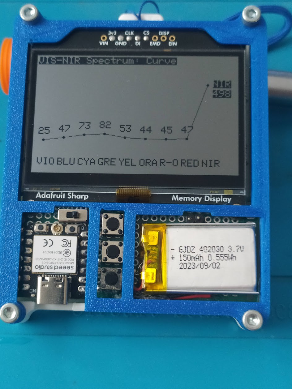

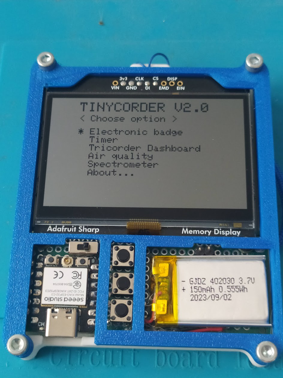

    Tinycorder Version 2 (updated July 6, 2025)
    The code is completed with the following changes:
    • The timer function is completed, allowing you to set blocks from 5 to 120 min. In the 25min block, a "Pomodoro Timer!" message appears. When activated, it starts a countdown and, when finished, notifies with a flashing label on the screen.
    • The Dashboard menu is completed, showing CO2, temp, and humidity measurements as a histogram, with measurements every 5 min up to a total of 24 for each variable. The time between samples can be changed in firmware to take a longer total sampling time.
    • The "Air Quality" menu presents CO2, temperature, and humidity measurements every 5 seconds continuously, until you return to the main menu.
    • The "Spectrometer" menu was already working but has been improved. Now it can display the spectrum as a histogram, lines, or numeric; you can switch between any of them or return to the main menu.

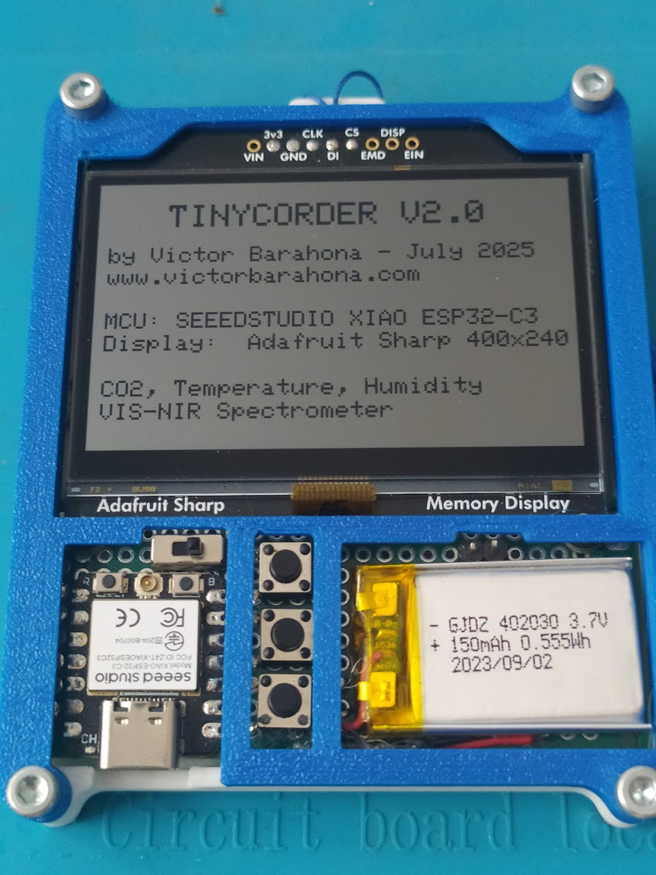

    • The "About" menu has been improved in appearance and presents basic information.
