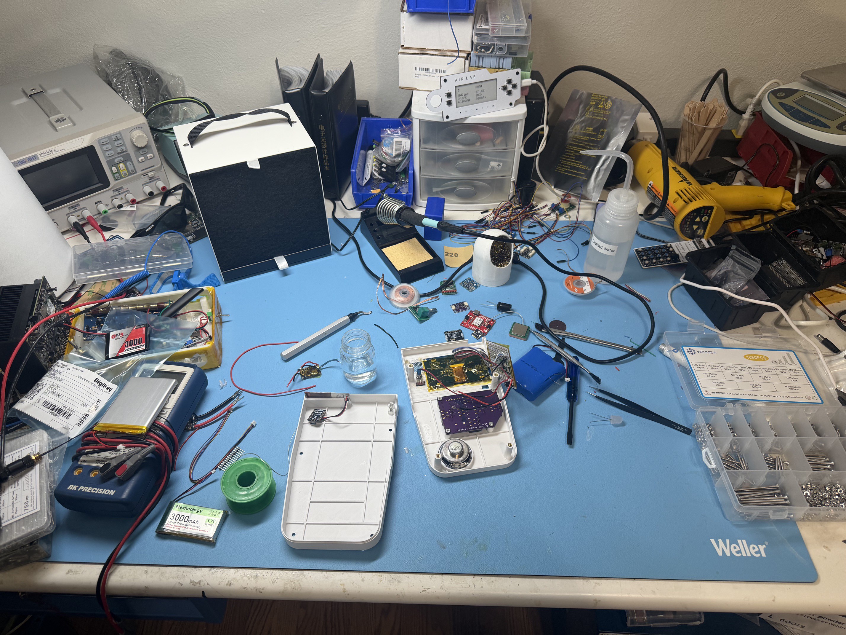

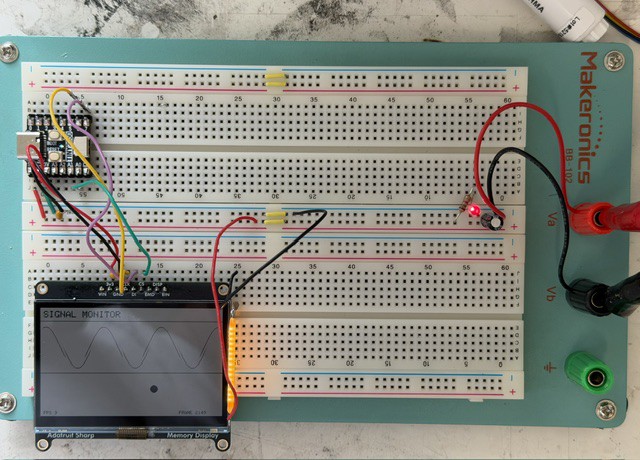

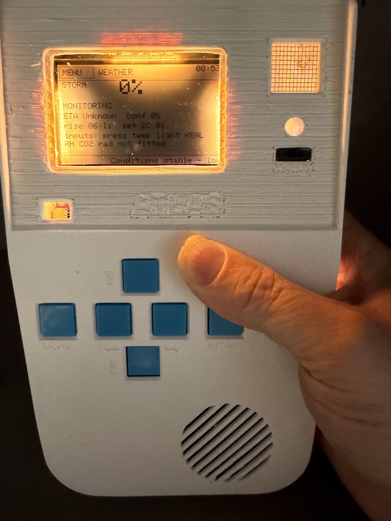

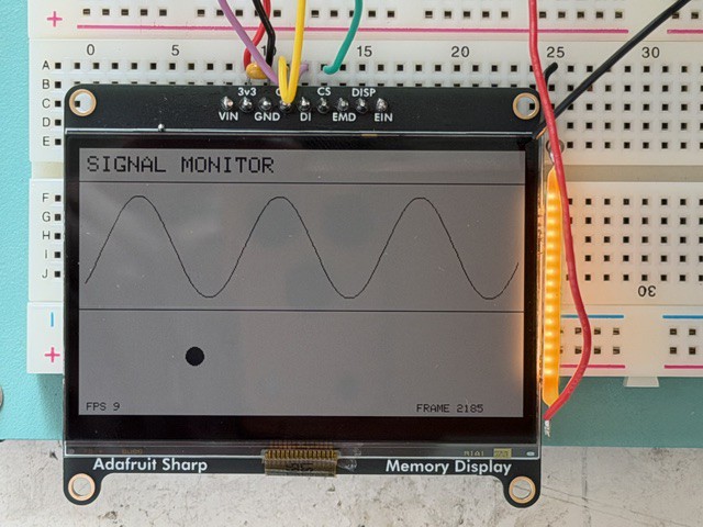

    The screen and the glass
    Short recap. ATLAS is running the Sharp Memory-In-Pixel now, 400x240 mono. Every pixel holds its own state, so once a screen is drawn the panel just sits there holding it for basically nothing. No backlight to feed. A GPS page parked on a 3D fix does not need 60fps, it needs to still be there in eight hours with battery left.
    The catch, and I knew this going in, is that it's fully reflective. Gorgeous in sunlight!, gets better the brighter it is out. In the dark it's a mirror. Nothing to see.
    Hence the frontlight. You can't light one of these from behind (the back IS the reflector) so it has to come in from the bezel and wash across the face.
    One correction from last time, I said Gorilla glass. It's now 1.75mm Borofloat 33 now. Nothing wrong with Gorilla, but go try and order 50 custom-cut pieces of it and let me know how that goes. (not great)  Borofloat comes in 1.75mm as a stock thickness, so I get fire-polished cuts with ground edges from a normal supplier on a normal lead time. Also does not care about going from a hot car into a 14C cave, which matters.
    For the lamp itself, warm Edison-style filaments around the bezel. Yes, partly because amber doesn't wreck your night vision.
    Then I wrote about three lines of code...
    Read the light sensor. Dark? Lamp on. Bright? Lamp off.
    Three lines. I felt pretty good about those three lines.
    Took it into a dim room. The sensor reads low, so ATLAS goes "it's dark in here" and fires up the lamp. Lamp comes on. And the TSL2591 is sitting on the front face about 9mm away from a lamp that is now on. Reads a TON of light. ATLAS goes "oh, plenty bright, we're good" and shuts it off. Room is dim again...
    You see where this is going. It sat on my bench flashing at me like a squad car.
    Now here's the part I'm not proud of. I checked the wiring first. Of course I did. Went looking for a cold joint, a flaky sensor, something in the mux. Twenty years of this and my first instinct is still "the hardware betrayed me." It hadn't. The firmware was doing exactly what I told it to do, which is the worst kind of bug there is.
    I built a positive feedback loop into a device whose entire job is measuring the world around it. It was measuring itself. In three lines. I stood there watching it blink for a good minute before I touched anything because it was, and still is, hilarious. Congratulations Apollo, you've invented a $200 candle. Battery powered. Speaks English.
    Fixing it
    First instinct is hysteresis. Split the on and off thresholds, add a dwell timer, flashing stops. Except that doesn't actually fix anything, it just makes it fail quietly. The reading still has the lamp in it, so now the lamp latches on and sits there forever in a dim room instead of blinking. Traded a loud bug for a quiet one.
    What it needs is the room with the lamp taken out of it. So I taught it what its own light looks like.
    Every time the frontlight switches, it grabs a reading right before, flips, waits for the sensor to settle, grabs another. The difference between them is what the lamp is contributing through this exact stack of bezel, glass and panel. Average that over time (it wanders a bit with duty cycle, and with however dusty the bezel got this month) and from then on the logic runs on measured-minus-lamp instead of raw lux. Hysteresis and a dwell timer still go on top, belt and suspenders. And one fast path, if the raw reading jumps way past anything the lamp could possibly account for, somebody opened a door or you walked out of the treeline, kill it now, don't wait on a timer.
    One thing worth stealing if you're building something like this: save that lamp number to flash and load it at boot. Start it at zero and the first switch after a cold...

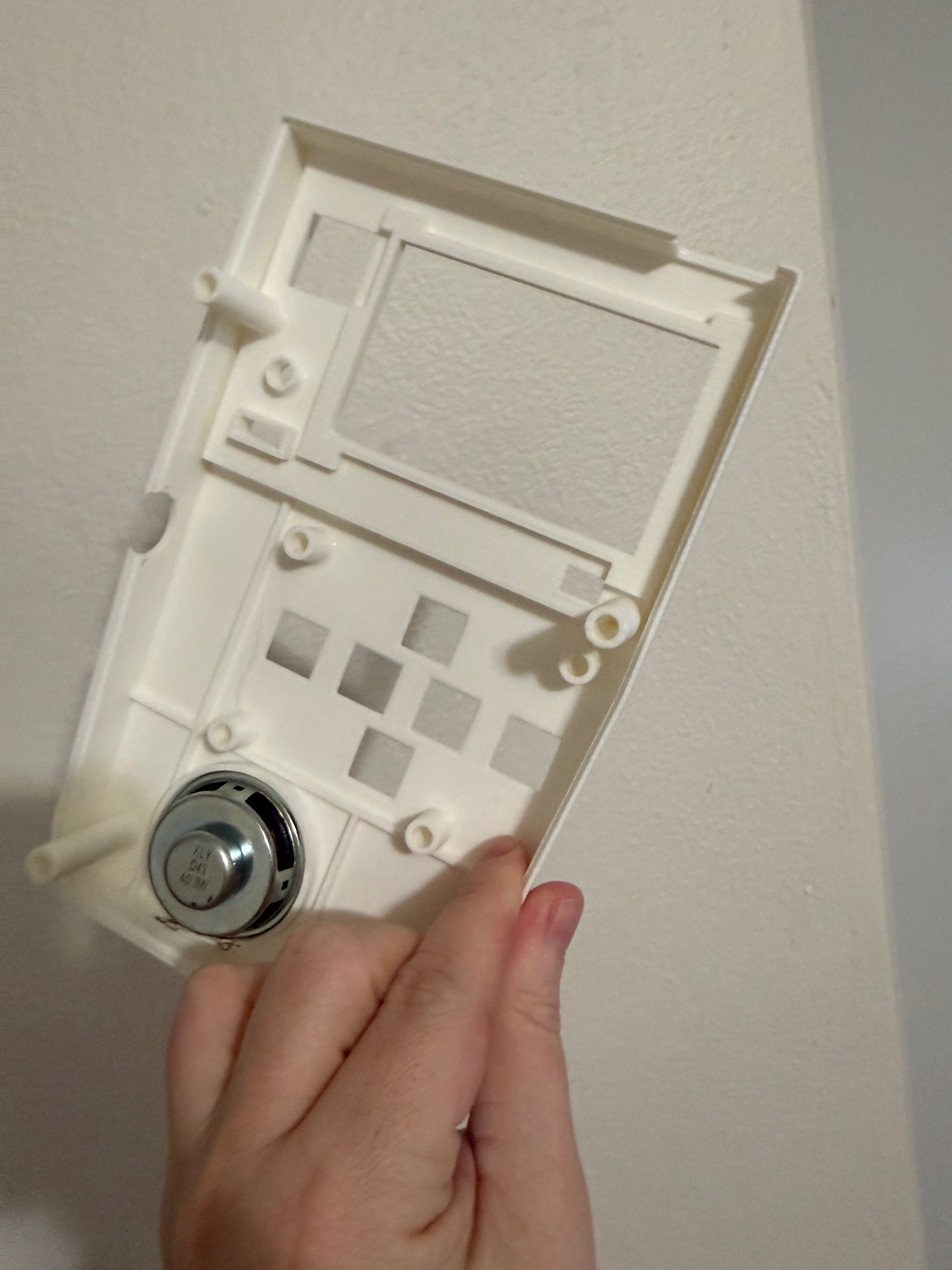

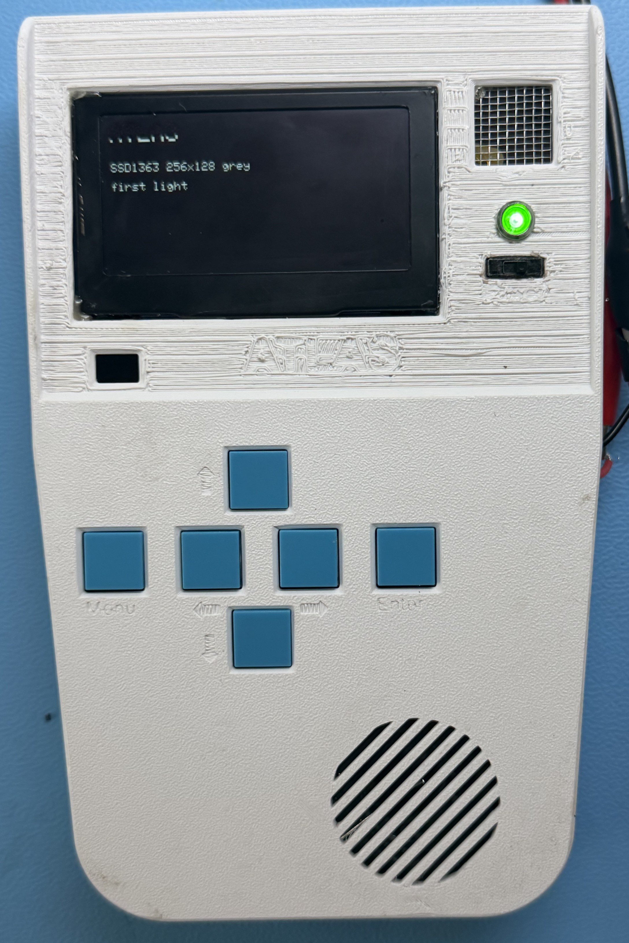

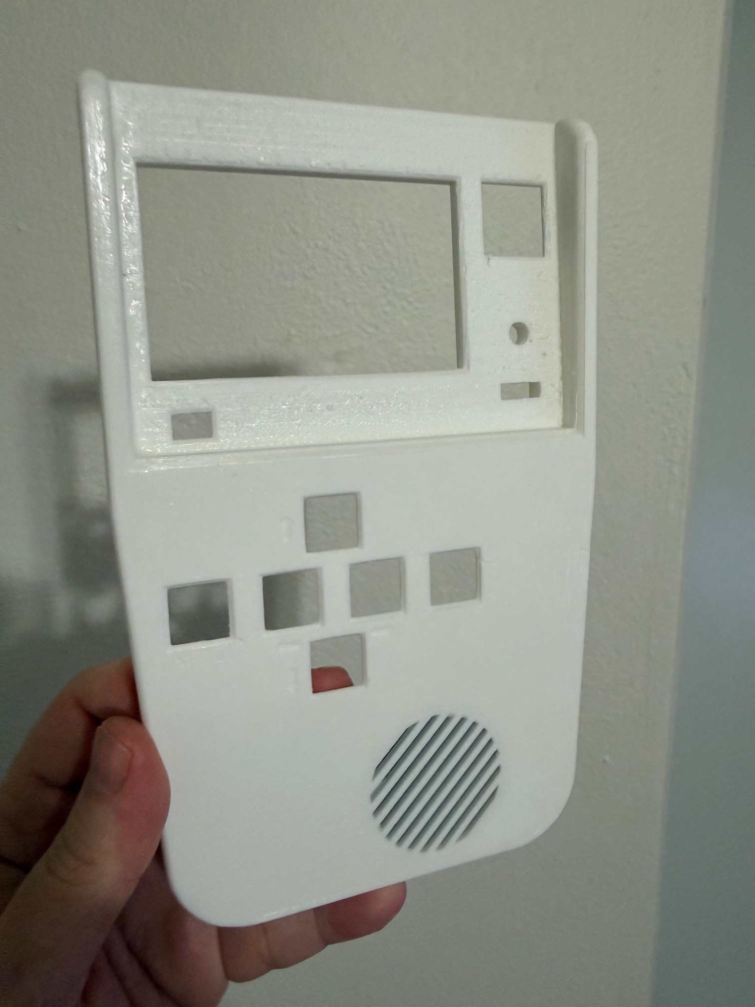

  • ATLAS v2 Prototype
    Apollo Timbers06/13/2026 at 15:28 0 comments
    The ATLAS tricorder in now deep into the second and more refined design/build version mark 2.
    It's been a long time coming but Mark 1 is now a shelf queen.
    It takes a lot of hard work to build these prototypes but each one helps further the design language and overall build quality. Below are some images of it in work.
    New features include: (not limited too)
    • A refined case design to allow for more internal volume
    • A dual super bright LED module in the back with protective rim, (glued in place with marine 2 part epoxy)
    • A speaker/grill with built in amp with a adjustable knob (amp not shown)
    • No need to trim the button holes the keys do not get stuck anymore.
    • Much nicer internal wiring and attention to detail such as gluing thins in with for mentioned marine epoxy.
    • Double the resolution screen bumped up from 128x64 to 256x128 pixels monochrome OLED
    • Case is printed in white ASA for a more durable and heat resistant plastic (I.E you can leave it in a reasonably hot car)
    Enjoy the images!

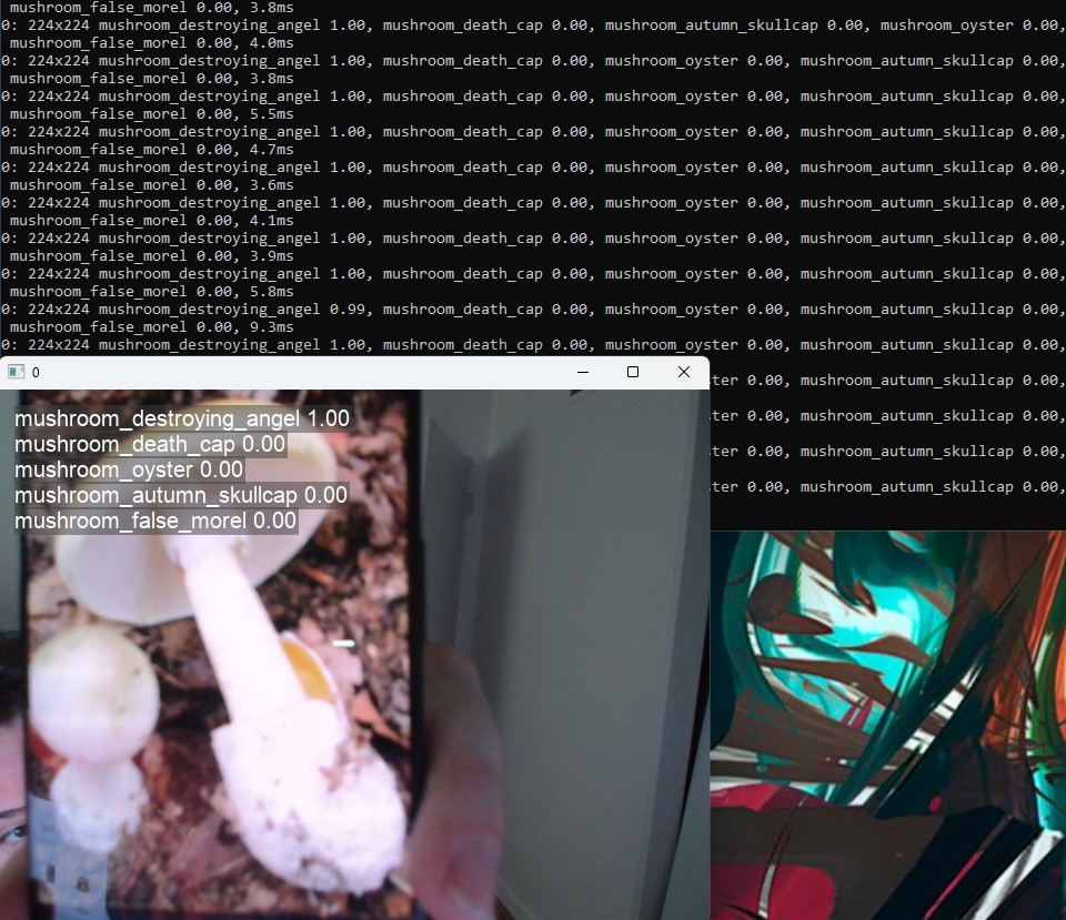

  • ATLAS Vision: Training a 50-Class Species Classifier
    Apollo Timbers02/24/2026 at 14:46 0 comments
    The Goal
    A vision model that runs on a HUSKYLENS 2 (Kendryte K230, 6 TOPS AI accelerator) and classifies species into safety tiers:
    • DEADLY — do not touch, do not eat
    • TOXIC — causes serious harm
    • EDIBLE — safe to eat, confirm ID first
    • MEDICINAL — documented medicinal use
    • INFO — identification and environmental context
    The model has to be small enough for edge deployment, fast enough for real-time use, and — critically — it has to be right about the dangerous stuff.
    The Pipeline
    1. Data Collection
    I wrote a Python scraper that pulls research-grade, expert-verified observations from the iNaturalist API. Research-grade means community consensus on identification — these aren't random smartphone photos with guessed labels.
    50 classes across 5 categories:
    • Mushrooms (18): 4 deadly, 1 toxic, 7 edible, 6 medicinal
    • Plants (18): 2 deadly, 3 toxic, 4 edible, 1 edible cooked, 8 medicinal (added in v1 final — renamed from 13 to 18)
    • Leaves (5): oak, maple, birch, fern, pine
    • Rocks (6): granite, limestone, sandstone, obsidian, quartz, basalt
    Total: 17,700 images. Dangerous species are intentionally oversampled — death cap and destroying angel get 600 images each while safe species get 300. When someone's life is on the line, false negatives on deadly species are unacceptable.
    2. Dataset Preparation
    A preparation script validates every image (corrupt file detection, minimum size check), splits into train/val/test (roughly 84/16 split plus held-out test), and generates a safety-tagged class map. Every class gets a safety label baked into the metadata so the device firmware can display appropriate warnings.
    3. Training
    YOLOv8n-cls (nano classification) on an NVIDIA RTX 2070 SUPER. 1.5 million parameters, 3.4 GFLOPs.
    • 224×224 input
    • Batch size 32
    • 100 max epochs, patience 20
    • Mixed precision (AMP)
    • RandAugment, horizontal/vertical flips, HSV jitter, rotation
    Training stopped early at epoch 85 (best model at epoch 65). Total training time: 51 minutes.
    4. Results

    88.4% top-1 means the model picks the correct species 88% of the time across all test images — including bad angles, poor lighting, and visually similar species. 98.4% top-5 means the correct answer is almost always in the model's top candidates.
    More importantly: on clean, well-lit images of distinctive species, confidence scores hit 95-99%. A photo of a destroying angel / death cap came back at 100% confidence. A baby bella mushroom (not in the training set) came back at 6% — the model knows when it doesn't know.
    Live Demo
    Exported to ONNX and ran live inference through a USB webcam using OpenCV. Point the camera at a photo on my phone, get real-time classification with confidence scores. Chanterelle: 99%. Death cap: 99%. Unknown grocery store mushroom: low confidence, no false ID. Exactly the behavior you want from a safety-critical system.

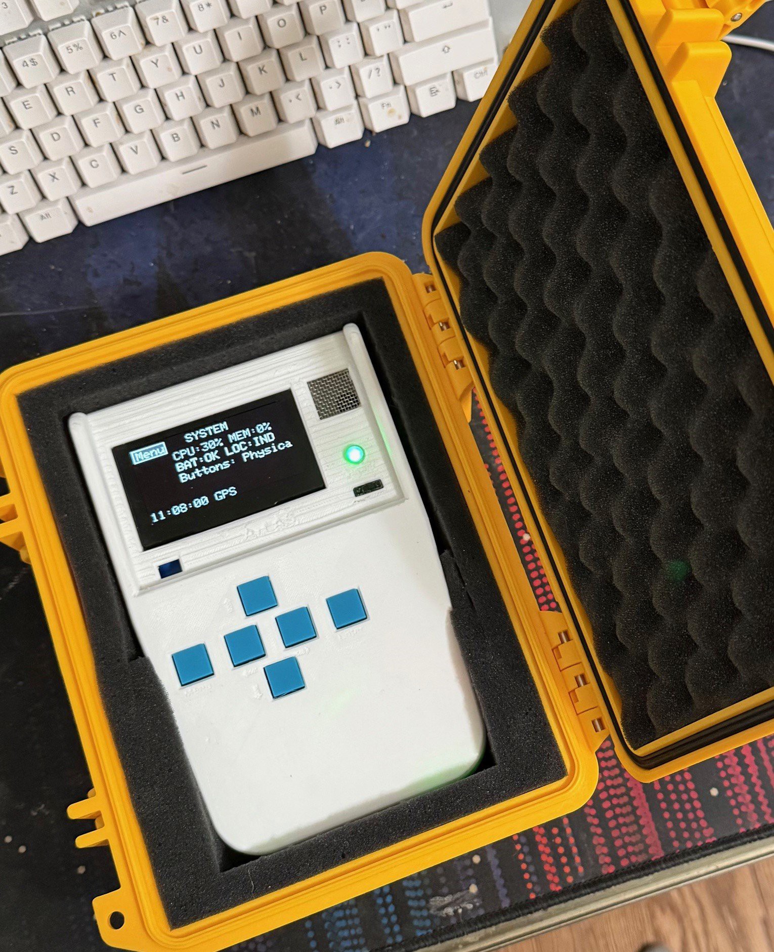

  • ATLAS Power Management — A Week in the Field on a Single Charge
    Apollo Timbers02/22/2026 at 16:02 0 comments
    Note: Everything in this post is initial research and estimated projections for ATLAS v2, which is the first version to include dedicated power monitoring hardware (INA226 voltage and current monitor, BQ25892 charge management IC). None of these power figures have been validated against real hardware yet — that testing will happen once the v2 MCU board comes back from the builder. Consider this the design intent and the math behind it. Real-world numbers will follow in a future post once I have actual bench data.
    One of the things I'm most proud of in the ATLAS tricorder firmware is the power management system. When you're building a handheld field instrument meant for serious wilderness deployment, battery life isn't a feature — it's a safety requirement. A device that dies on day two is worse than no device at all because you trusted it.
    So I designed ATLAS around three distinct power modes, each tuned for a specific use case, with some logic baked in that I think is genuinely clever.
    The Three Modes:
    Full Active — The Lab Bench and Active Survey Mode
    This is ATLAS with the hammer down. GPS running at 1Hz continuous, the BNO085 IMU screaming at 10Hz, all environmental sensors polling fast, display always on, both RP2350 cores active. This is what you run when you're actively scanning a site, doing a structured survey, or demoing the hardware.
    The cost is power — roughly 120mA continuous. On the student 5Ah pack that's about 42 hours. On the full 10Ah pack you get ~83 hours. Not a field deployment mode, but you're not meant to live here. It's full capability on demand.
    Hiker Mode — On the Move
    Hiker is the balanced field mode. GPS drops to a fix every 5 seconds, the IMU stays alive but throttles back to 1Hz, environmental sensors poll at reduced intervals, and the display auto-shuts after 30 seconds of inactivity with a button wake. The speech processor core sleeps between alerts.
    That IMU staying alive at 1Hz is intentional — ATLAS uses it for dead reckoning when GPS signal degrades under heavy canopy or in terrain. If the GPS drops out, the BNO085 keeps navigation alive using accelerometer and heading data. You don't lose your breadcrumb trail just because you walked into a ravine.
    Estimated draw is ~65mA. Runtime: ~77 hours (~3.2 days) on 5Ah, ~154 hours (~6.4 days) on 10Ah.
    Basecamp Mode — The Long Watch
    This is where ATLAS earns its keep. Display off. Speech core off. IMU off. GPS wakes every two hours, grabs a fix, and goes back to sleep. Environmental sensors poll at drastically reduced intervals. Deep processor sleep between cycles.
    Estimated draw is ~42mA. Runtime: ~119 hours (~5 days) on 5Ah, ~238 hours (~nearly 10 days) on the full 10Ah pack.
    But here's the thing — radiation and CO polling never slow down. In every mode, including deep Basecamp sleep, the ATtiny85 sub-processor is continuously counting radiation pulses and sampling the CO sensor at 500ms intervals. ATLAS is always watching for the two threats you can't see or smell. That was a non-negotiable design decision.
    The Cool Part — GPS Waking the IMU
    The piece of logic I'm most pleased with is the Basecamp displacement detection system.
    The problem it solves: someone sets Basecamp mode at their tent, then wanders off without switching to Hiker. Maybe they're groggy in the morning, maybe they forgot. In Basecamp mode the IMU is completely off to save power, so ATLAS can't detect walking directly.
    Here's how it handles it. Every two hours, the GPS wakes up and grabs a fix. That fix runs through a Haversine calculation against the stored anchor position. If you're within 200 meters of where you set camp — go back to sleep, everything is fine. But if you've drifted more than 200 meters from the anchor, ATLAS doesn't immediately assume you're hiking. It wakes the IMU and opens a 2-minute confirmation window.
    During that window, feedImuSteps() watches the BNO085 step counter. If it sees sustained walking confirmed over 60...

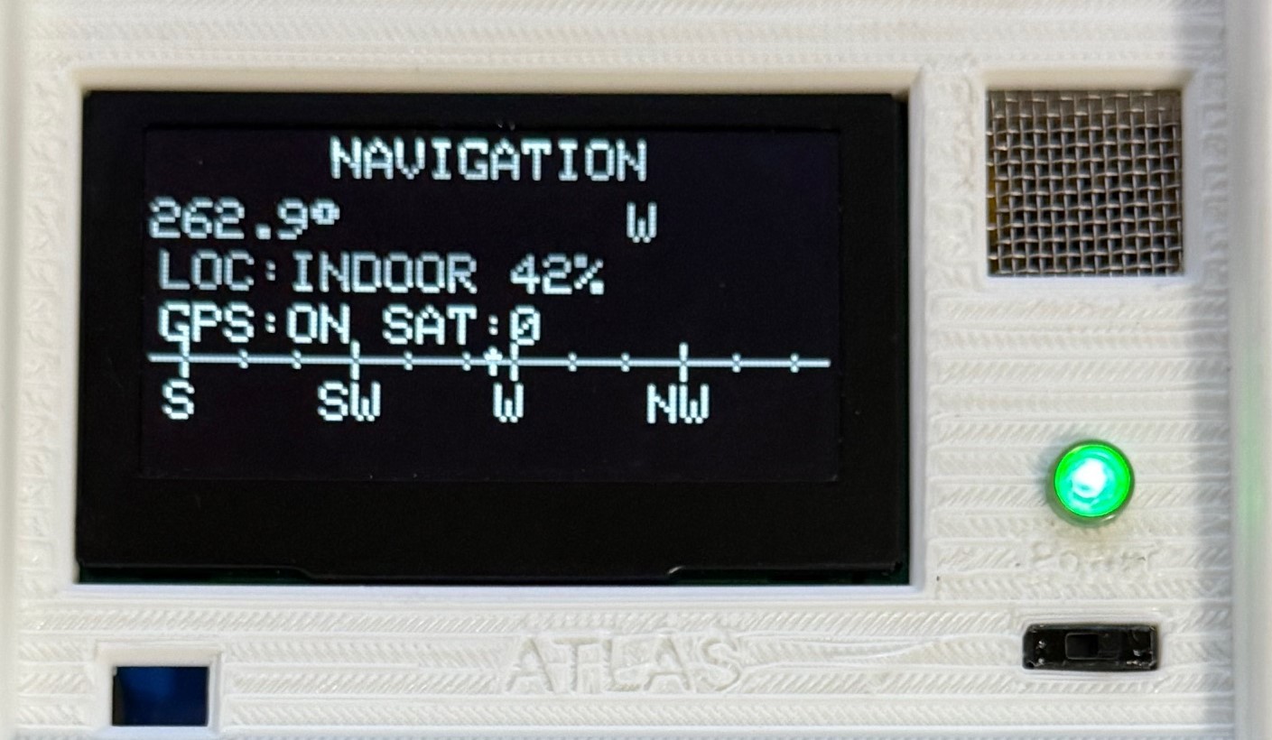

  • ATLAS Breadcrumb Navigation
    Apollo Timbers02/07/2026 at 16:48 0 comments
    You're a hundred yards into a cave and you lost GPS signal a while back. Now what?
    That's the problem I'm solving with ATLAS, a handheld environmental tricorder I've been developing that packs nine sensors, dual RP2350 processors, and now a breadcrumb navigation system that can guide you home even when satellites can't see you.
    The Compass Was Just the Start
    ATLAS already had a working compass thanks to a BNO085 IMU. I actually tried rolling my own sensor fusion first with a raw gyro and accelerometer. It worked, but not well enough to trust in the field. The BNO085 runs Hillcrest's sensor fusion on-chip with gyro bias correction and magnetic calibration. It basically doesn't care about orientation. Tilt it, flip it, shove it in your pocket. The heading stays solid. That gave me a reliable compass, but a compass alone doesn't get you un-lost.
    The concept is simple. When you activate trail recording, ATLAS starts dropping GPS waypoints at adaptive intervals, faster when you're driving, slower when you're standing still. The trail lives on the SD card so it survives a power cycle. When you want to get back, you have two options:
    Backtrack. Follow your breadcrumbs in reverse, waypoint by waypoint. The nav screen shows a compass ring with a direction arrow pointing to the next crumb. Walk that direction, arrive within 5 meters, and it advances to the next one. You retrace your exact path.
    Direct. Ignore the trail entirely. The arrow points straight back to where you started. As the crow flies. Useful when you know the terrain between you and your starting point is passable and you just need a heading.
    Dead Reckoning When GPS Drops
    Here's where it gets interesting. GPS is great until it isn't. Dense tree canopy, canyon walls, caves, urban canyons. When ATLAS loses GPS fix for more than 8 seconds, the system engages dead reckoning using the BNO085 heading and last known speed to project your position forward.
    But I didn't want some arbitrary confidence timer that just counts down and hopes for the best. I built an error-budget model based on the actual sensor characteristics:
    • BNO085 heading uncertainty: ~5° typical
    • Speed estimation error: ~±25% (using last GPS speed, no wheel encoders here)
    • Lateral drift rate: speed × sin(5°) per second
    • Along-track drift rate: speed × 0.25 per second
    At walking speed (5 km/h), that works out to about 0.37 meters of position error per second. So after 5 minutes of dead reckoning you've accumulated roughly 110 meters of uncertainty and the system reports CONF:93>. After 15 minutes, you're at about 65%. After 30 minutes, around 30%.
    At that point, yeah, you're a bit lost until GPS comes back online. But the arrow is still pointing in broadly the right direction, which is a lot better than nothing when you're trying to find the mouth of a cave.
    The moment a GPS fix returns, error resets to zero and confidence snaps back to 100%. No accumulated drift baggage.
    What's On Screen
    The nav display shows a compass ring with N/E/S/W cardinal markers rotated by your actual magnetic heading, so north always points north regardless of which way you're facing. Inside the ring, a direction arrow points toward your target. Below that: distance to target, bearing, waypoint progress (for backtrack mode), and the confidence readout.
    CONF:GPS 8s means you have a real fix with 8 satellites. CONF:87% E:35m means you're on dead reckoning with an estimated 35 meters of position error. You always know exactly how much to trust the arrow.
    Why Not Just Use Your Phone?
    Fair question. Your phone has better GPS, more processing power, and Google Maps. But your phone also has a glass screen, a battery that dies in the cold, needs cell service for most of its tricks, and isn't something you want to pull out in a downpour or drop on a rock face. ATLAS is a ruggedized tool that boots in seconds, runs all week on a single charge, and gives you environmental...

    Picked up a Pelican case for transport and storage. ATLAS fits snug in the foam with room for cables and accessories underneath. Since I'll eventually be traveling with this thing, I put together a two-page TSA security information card to keep in the case. It breaks down every component, battery specs, what it looks like on X-ray, and lists comparable commercial devices like Kestrel meters and Garmin handhelds. Did everything short of writing "PLEASE DON'T ARREST ME" on the cover. Still fully expecting a 45-minute conversation in a small room somewhere.
    Also have a new OLED display on the way - upgrading from the current 128x64 to a 256x128. Same SPI interface, double the resolution. Should make the sensor readouts and menus a lot easier on the eyes and give more room to work with in the UI.

    Finally got all the buttons wired in and working with the built in menu system, actually I did it last year. Been working a bit on a Bluetooth smart lab air filter too. Though I'm very happy with it so far. It was may intention to try to make it as rugged and useful as possible without over loading the user. I have seen a few Tricorders in the past, but they are a rare breed. I like how this came out and hope to keep on developing it.
    Some current modifications for the newest revision is:
    • A much nicer industrial style power LED
    • Lots of Internal code revisions
    • A newer power switch that is low profile, so you can't bump it on/off as easy
    • All switches wired and working
    • Cutouts on the back for better grip of the device
    • Lots of field testing on the auto environment detection feature (indoor, outdoor, and vehicle)
    When I have some additional funds I plan on at least getting a nicer professional 3D printed case for it so the symbols and names show up and no layer lines. The program is up to about 6k lines of C++ at this point.
    I'm finding out however I'm pushing the 12C bus a bit hare with traffic, so I'm looking into solutions. One is some type of I2C MUX chip or possibly moving to dual processors. A MUX chip may be the easiest as I can put some of the lower traffic sensors like light, temp and humidity on it. With GPS and the IMU on its own bus. Some PCB's for the main controller and sensor board will need to wait till I have some time to design them but they are high on the list so I can both reduce the thickness and overall size a bit.
