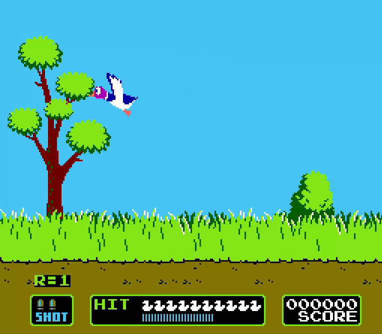

An Example from Duck Hunt
In Duck Hunt, for example, when the trigger is pulled, the screen will turn completely black for one frame:

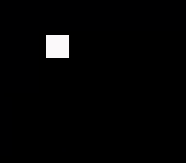

Then a white box is drawn immediately over where the duck was on the previous frame:

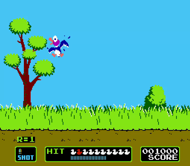

Finally gameplay resumes with either a hit or a miss being registered, depending on what the light gun saw.

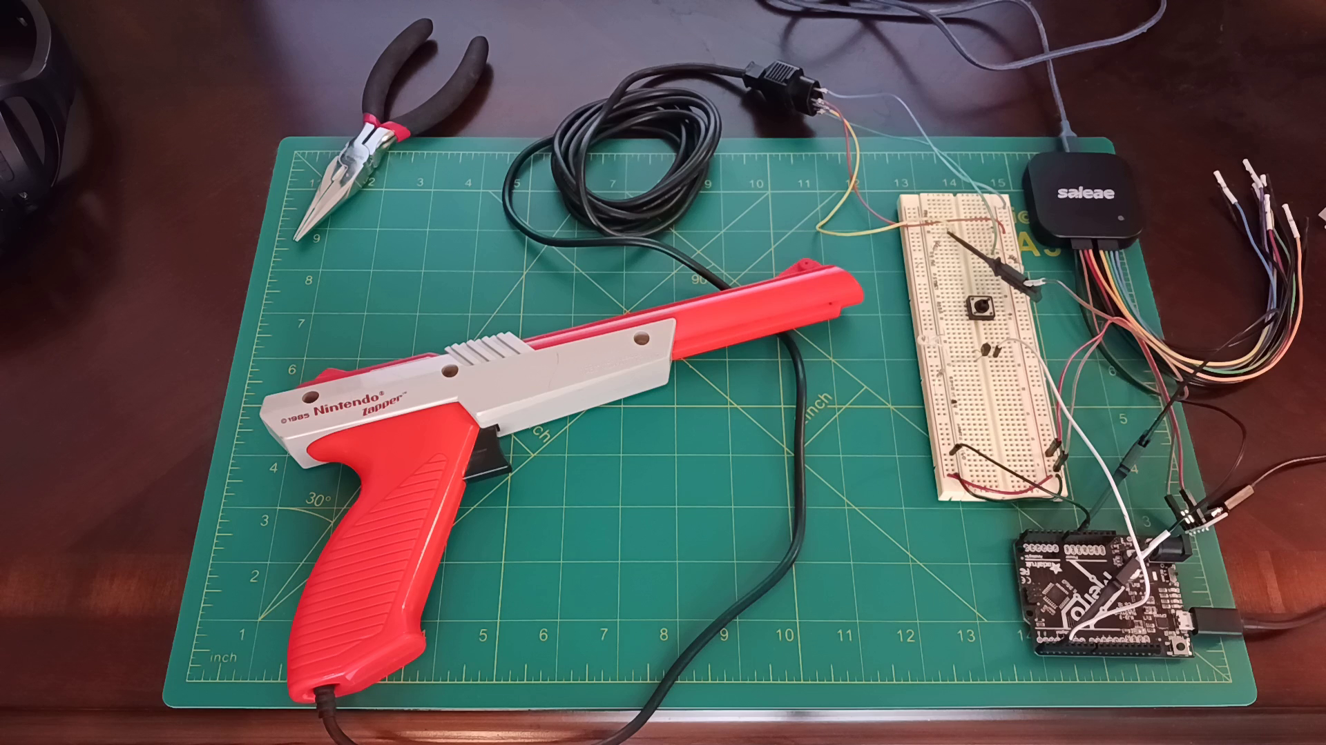

So if you want to repurpose a light gun, do you have to exactly mimic a CRT TV? That’s what I wanted to find out, so I built this test rig:

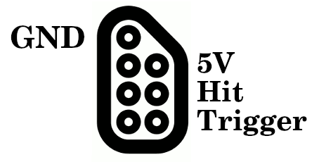

For reference, here is the pinout of the Zapper’s connector:
Both the trigger and hit lines need pull-up resistors. The trigger is super simple — pull it and it grounds the signal. It is completely independent of light sensing even though a lot of explanations out there link them. That is definitely not the case.
To find out what exactly the light sensor responds to, I have a white LED being rapidly switched on and off at varying frequencies by an Arduino clone. That light shines right at the photodiode inside the Zapper.
I have it flashing the light at frequencies above and below the expected 15.7 kilohertz triggering frequency. I am monitoring...
