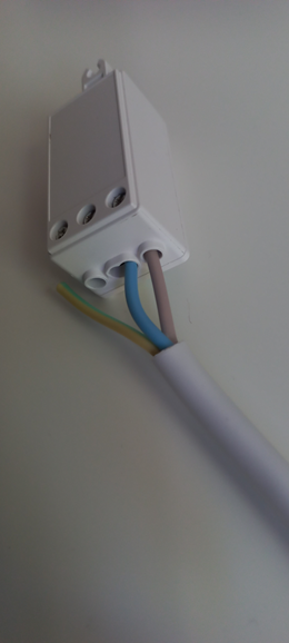

LC01 LoRaWAN relay
The Dragino LC01 is a LoRaWAN®-enabled relay controller designed for smart control of electrical appliances and lighting. Ideal for remote switching and status monitoring, the LC01 is built to deliver reliable performance in demanding environments.
Key Features:
- Wide Voltage Support: Compatible with appliances operating from 80–275V AC, with a maximum resistive load of 15A.
- Dual Terminal Design: Equipped with two input and two output terminals for easy power connection.
- LoRaWAN® Class C: Operates in Class C mode for low-latency communication and continuous listening.
Built-In Protection & Durability:
- Advanced Safety: Integrated protection against overcurrent, overvoltage, short circuits, and temperature rise, helping reduce the risk of damage from lightning strikes.
- Rugged Enclosure: Made from fireproof PC material with UV-resistant additives, ensuring long-term durability without discoloration.
Plug & Play Connectivity:
- Preloaded Credentials: Comes with a unique DevEUI, AppEUI, and AppKey, enabling fast and secure registration on any LoRaWAN network.
- Auto Join Capability: Automatically connects to the pre-registered network once powered on.
Longer Life with Zero-Crossing Trigger:
- The LC01 includes a patented zero-crossing trigger, which minimizes electrical stress and extends the device’s operational life.
