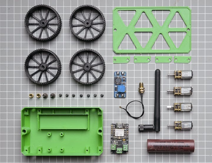

- Seeed Studio XIAO ESP32C3
- XIAO DC Motor Addon PCB
- MT3608 voltage booster
- 2.4ghz antenna
- 18650 Battery
- 4*N20 5v 300rpm motor
- 2*M4 6mm Knurled Threaded Insert
- 2*M4 10mm Bolt
- 12*M2.5 screws
- JST connectors, male and female
- 3D printed parts

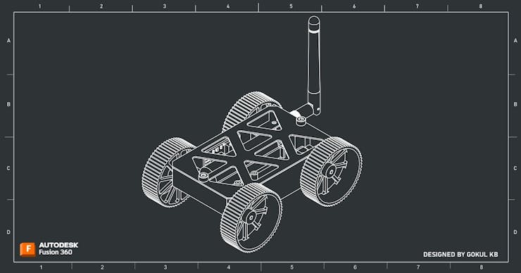

I utilised Fusion 360 to plan and design my project, which required careful space optimisation. I needed to fit all the parts into the smallest form factor possible while ensuring practicality, including sufficient space for wiring and easy assembly. First, I imported all 3d models of the parts and tried different configurations by placing the parts in various positions. Once I found the optimal configurations, I built the enclosure around them. All design files are provided below
I printed the main body in green PLA, and the wheels are printed using Black PLA

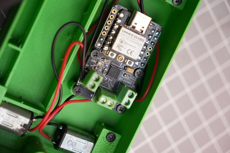

Connect all 4 motor wires to the motor controller PCB and screw in the PCB using four M2.5 Screws

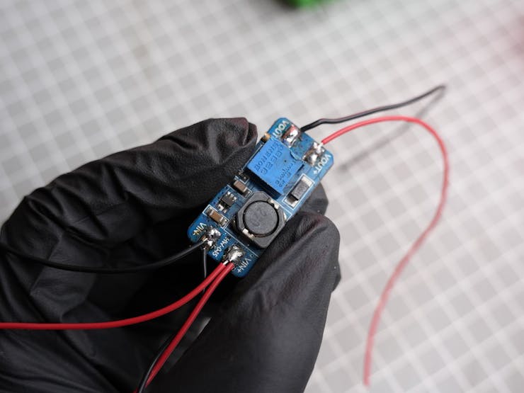

Solder a 2-pin JST connector and an additional two wires to the input pad of MT3608. Also, solder some wires to the output. The reason I am using MT3608 is that it functions as a voltage booster, allowing us to increase the 3.7V from the battery up to 10.8V for the motor driver. We will be powering the Xiao directly from the battery output. Please make sure not to connect the boosted voltage to the Xiao’s power input, as this could damage it.
Now, put the MT3608 into the 3D printed slot. Use glue if you need
Connect the motor power and Xiao power from the MT3608 input and output pads

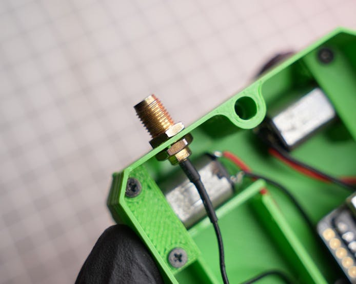

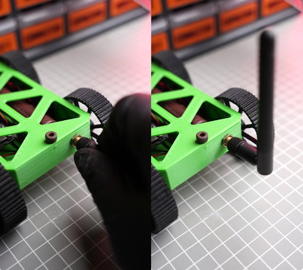

Install the antenna port to the side of the wall and connect the other end to the antenna port of the XIAO

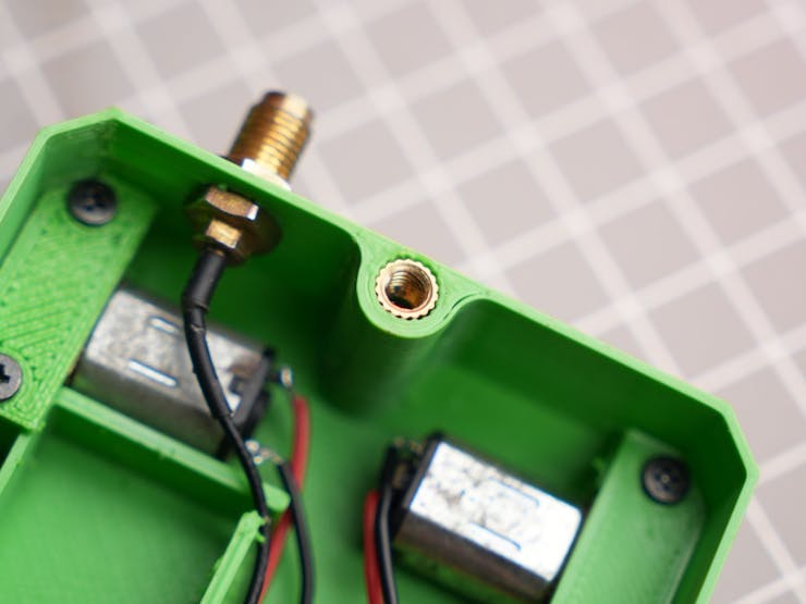

Install all 2 of the M4 thread inserts onto the 3d print using a soldering iron

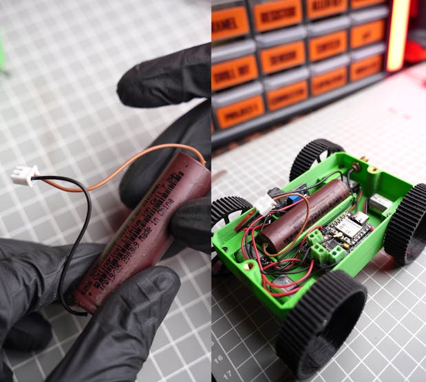

Solder the JST connector to the battery and place it in the 3d printed slot

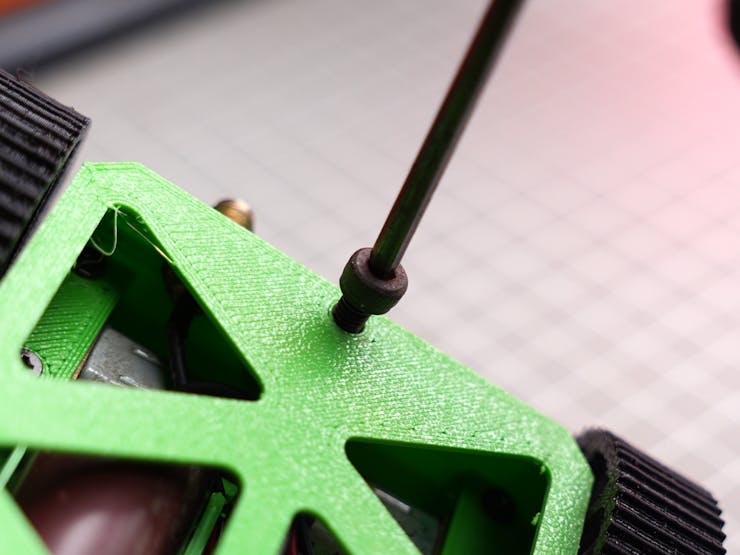

Put cap and close it of with 2 M4 screw
We can fish out the assembly by installing the antenna
