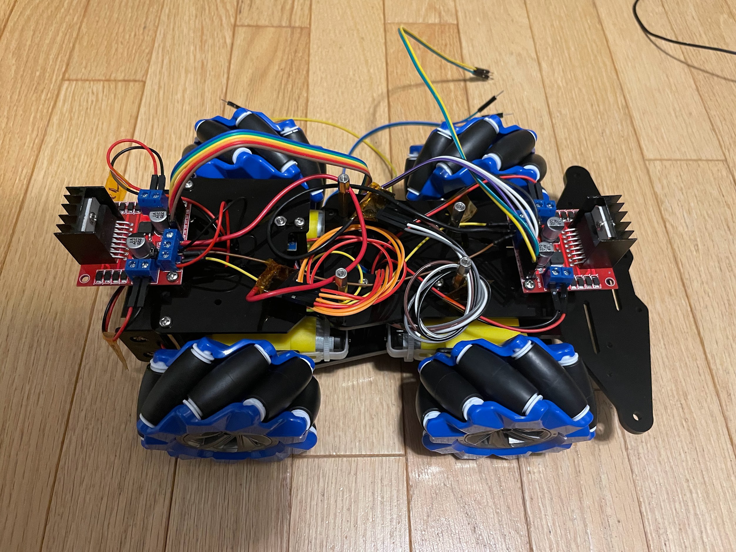

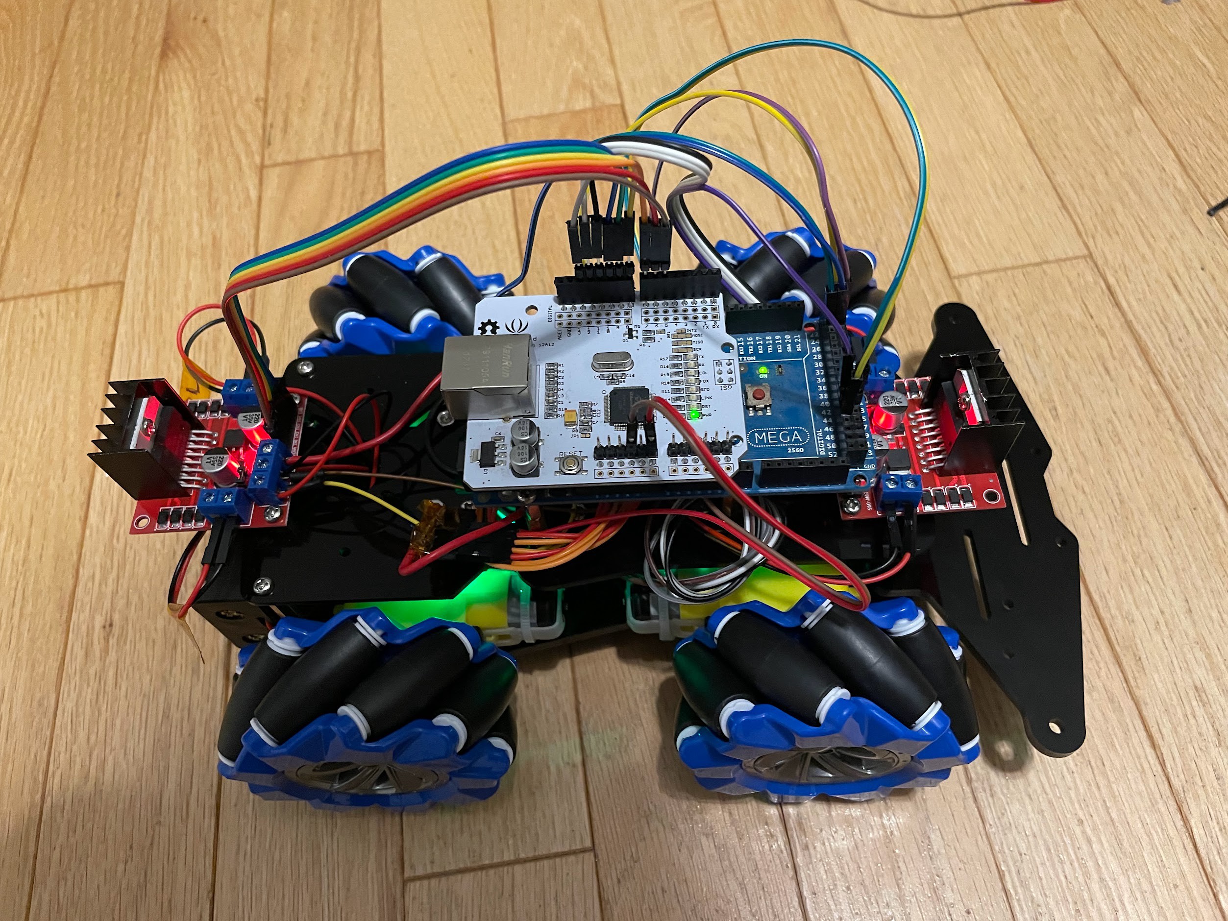

  • Robot Chassis, Encoder, and Motor Control Integration Update (06/06/2025)
    Artem Lepilov06/09/2025 at 15:56 0 comments

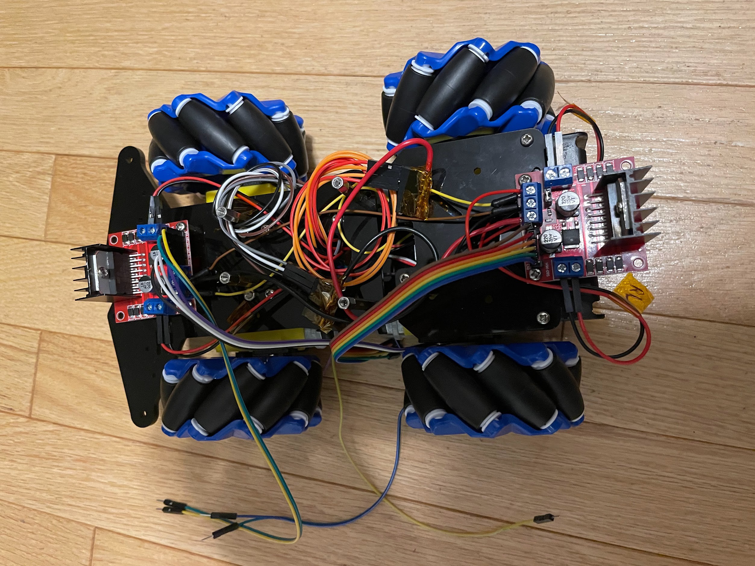

    Over the past couple weeks, I think I’ve made solid progress on getting the robot’s drivetrain and feedback control system up and running. Here's what I've tackled so far:
    🔩 Hardware Assembly

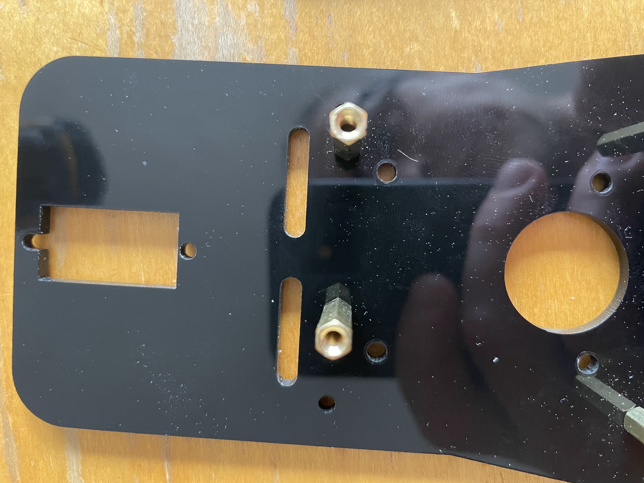

    • Assembled the robot chassis by mounting the gearboxes with motors onto the assembly components, and installed mecanum wheels on the output shafts

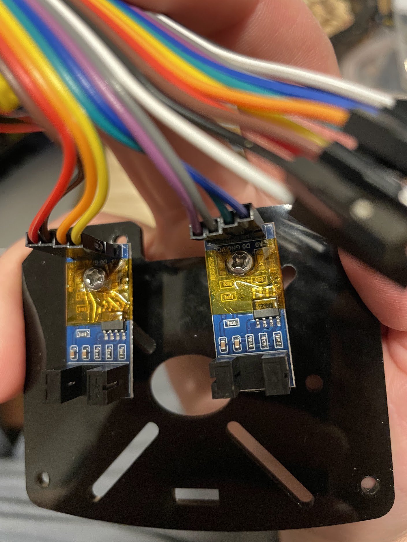

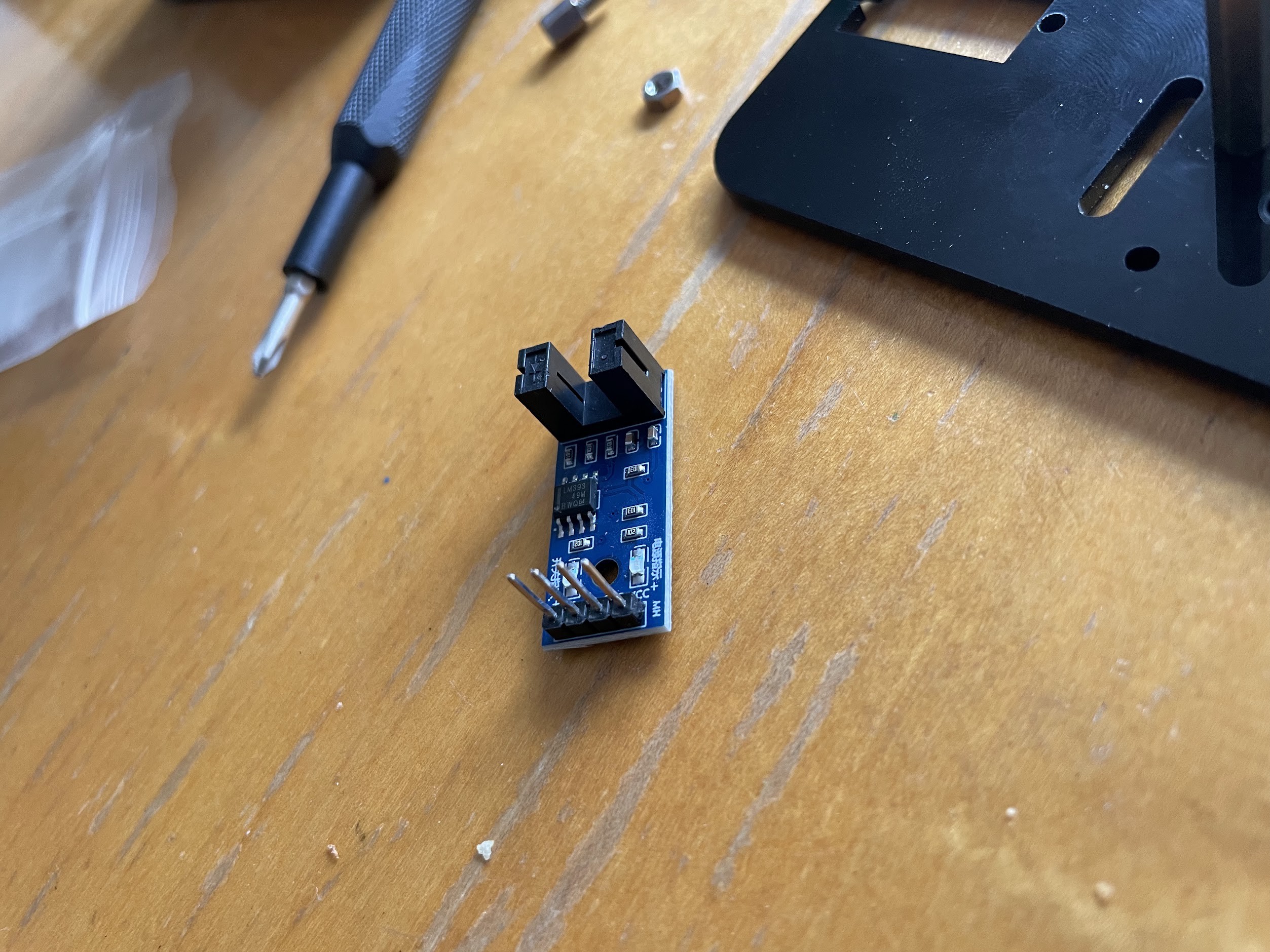

    • Custom aligned and mounted encoder sensors Unfortunately, my robot chassis didn't come with motor encoders, and as a result, I had to retrofit them on manually, along with the encoder break-beam sensors, which required putting standoffs in place and drilling holes in the chassis where they needed to be installed so they can observe the encoder slits.
    • Installed two L298N motor controllers, wired for four independent motor channels.

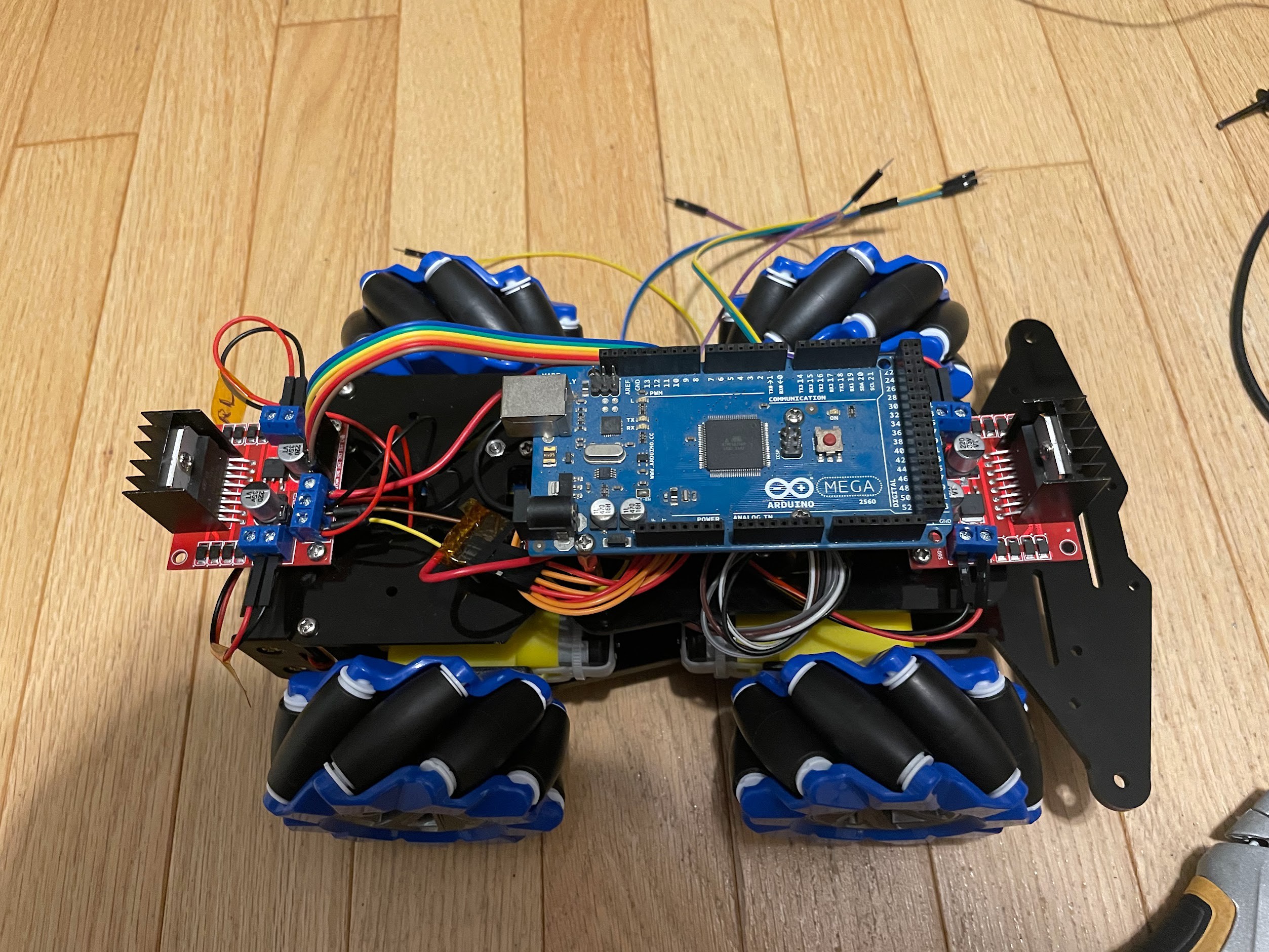

    • Connected encoder outputs, motor drivers, and Bluetooth serial to the Arduino Mega. Also wired up power and verified each motor independently.
    🧠 Embedded Code Architecture
    • Built out modular Arduino libraries:
      • MotorController: for handling PWM and direction logic.
      • EncoderReader: to poll break-beam encoder ticks at high frequency.
    • Implemented update() and getTicks() functions to reliably track motor movement over time.
    🐞 Debugging Encoder Feedback
    • Initially observed:
      • One encoder not registering ticks (turned out to be a misaligned sensor with a wire stuck in its beam).
      • Large inconsistency between wheel tick counts — differences of 20–30% between motors for the same commanded distance.
      • Sensors missing transitions or counting unevenly.
    ✅ Fixes and Improvements
    • Tried to switch to interrupt polling and add external pull-up resistors to improve signal stability. (Which didnt help much, as interrupts werent registering for some reason)
    • Switched from interrupt-based encoder reading (which had issues) to high-frequency polling using micros() — much more consistent.
    • Added a PID speed control loop per motor to dynamically adjust motor PWM based on tick feedback — this brought the error down significantly:
      • Now seeing consistency within ~5–10% across all four wheels.
    • Tuned PID and tested multiple speeds — most motors now start and stop accurately, with only slight lag on one wheel.
    🤖 Motion Control System
    • Started integrating a MotionController layer to command coordinated motion (forward, rotate, strafe).
    • Early tests show all wheels move correctly, but:
      • The robot does not stop as expected — likely due to an issue in how we’re checking for movement completion vs target distance.
      • Planning to debug that next.
    🧪 Known Challenges / To-Do
    • Motors struggle at very low speeds — they buzz but don’t turn unless nudged. Planning to implement a "kickstart burst" technique to overcome stiction.
    • Still need to:
      • Finalize the motion control logic (with distance tracking).
      • Set up communication over Ethernet or Bluetooth from the Jetson Nano to the Arduino.
      • Let the Jetson handle high-level motion planning (target heading/speed) while Arduino handles low-level control.
    Encoders Mounted Top
    Encoders Mounted - Side
    Robot Powered Up!
    Encoder Mount Trial
    Robot Chassis Encoder Base
    Sizing Up Encoder to Mount
    Arduino Installed
    Arduino Wired Up
    Sensors and Motor Drivers Connected to Power
    Sensors and Motor Drivers Connected to Power - Another View
