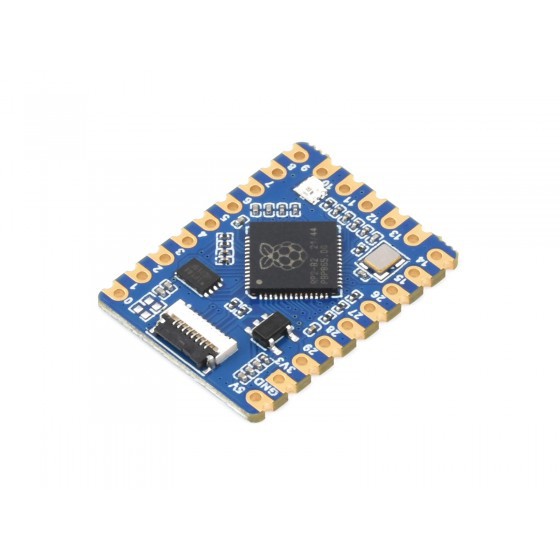

We are using the RP2040-Tiny mini development board, which is based on Raspberry Pi's RP2040 core. It includes a separate programming adapter board that keeps the type C USB port separate from the circuit, reducing overall thickness and size, making it easier for users to integrate into their projects.
In terms of technical specifications, it's essentially a Pico with an RP2040 microcontroller chip and a few modifications, such as the Onboard FPC 8PIN connector, which connects the module to the Type C adapter board, and the addition of Castellated holes or pads, which allow soldering directly to carrier boards.
We also have a WS2812B 2020 Package LED added on the board, which is connected to GPIO16.
Overall, this board shares its technical parameters with PICO 1, which includes the RP2040 Dual-core Arm Cortex M0+ processor, flexible clock running up to 133 MHz, 264KB of SRAM, and 2MB of onboard Flash memory.

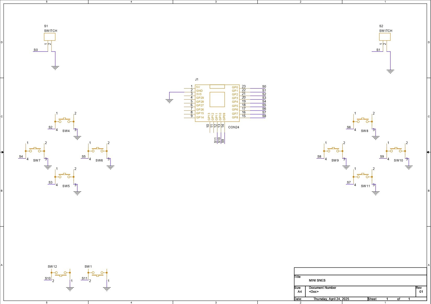

As previously stated, the PCB design for the Game Controller was truly simple; it is essentially an RP2040 Tiny Dev Board connected to 12 SMD Push buttons, each of which is attached to an RP2040 GPIO Pin. All SMD Button Terminals are linked to GND. When a button is...

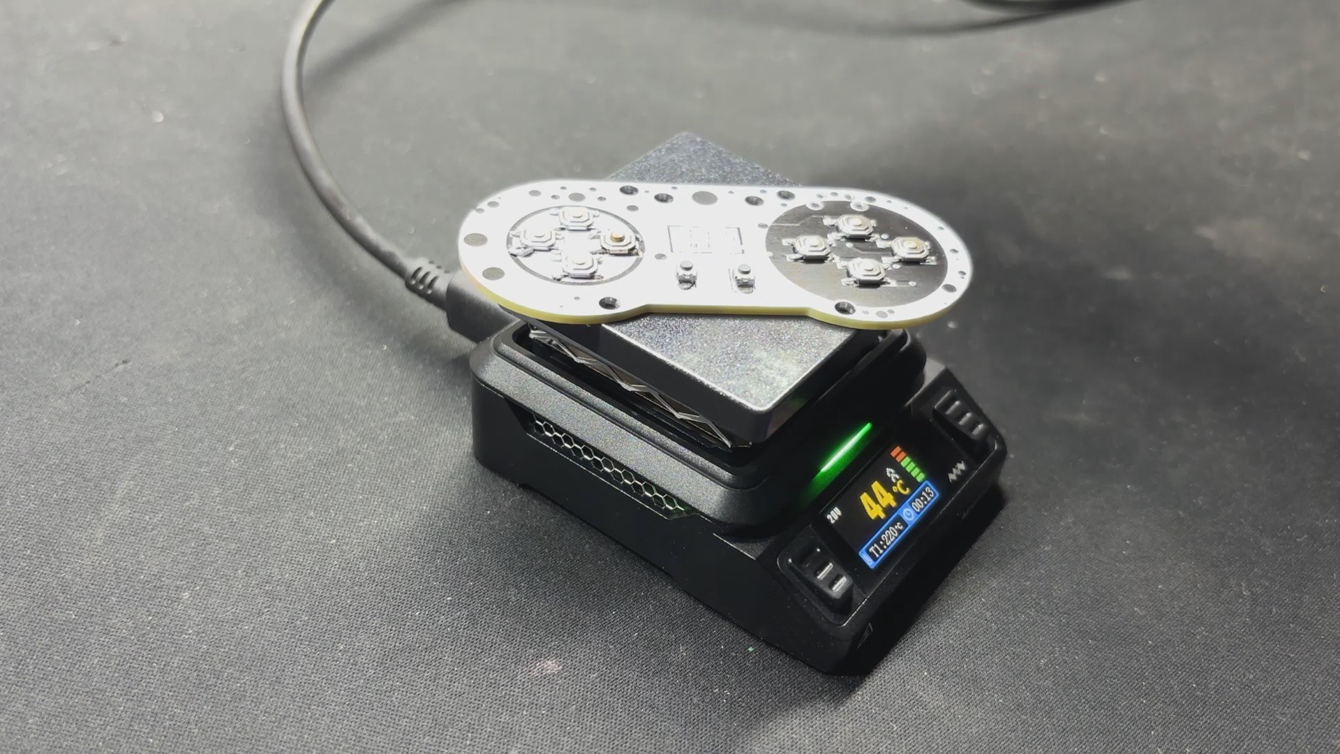

    • We begin the PCB Assembly process by placing SMD switches on the top layer of the PCB. This is carried out by applying solder paste to each component pad one by one with a solder paste dispensing needle, in this case using normal  Sn/PB 63/37 Solder paste.
    • We use an ESD Tweezer to pick and install all SMD tactile switches.
    • We next pick up the circuit and place it on our Miniware Reflow hotplate, which heats the PCB from below up to the solder paste melting temperature, allowing us to solder all of the components in their proper locations.
