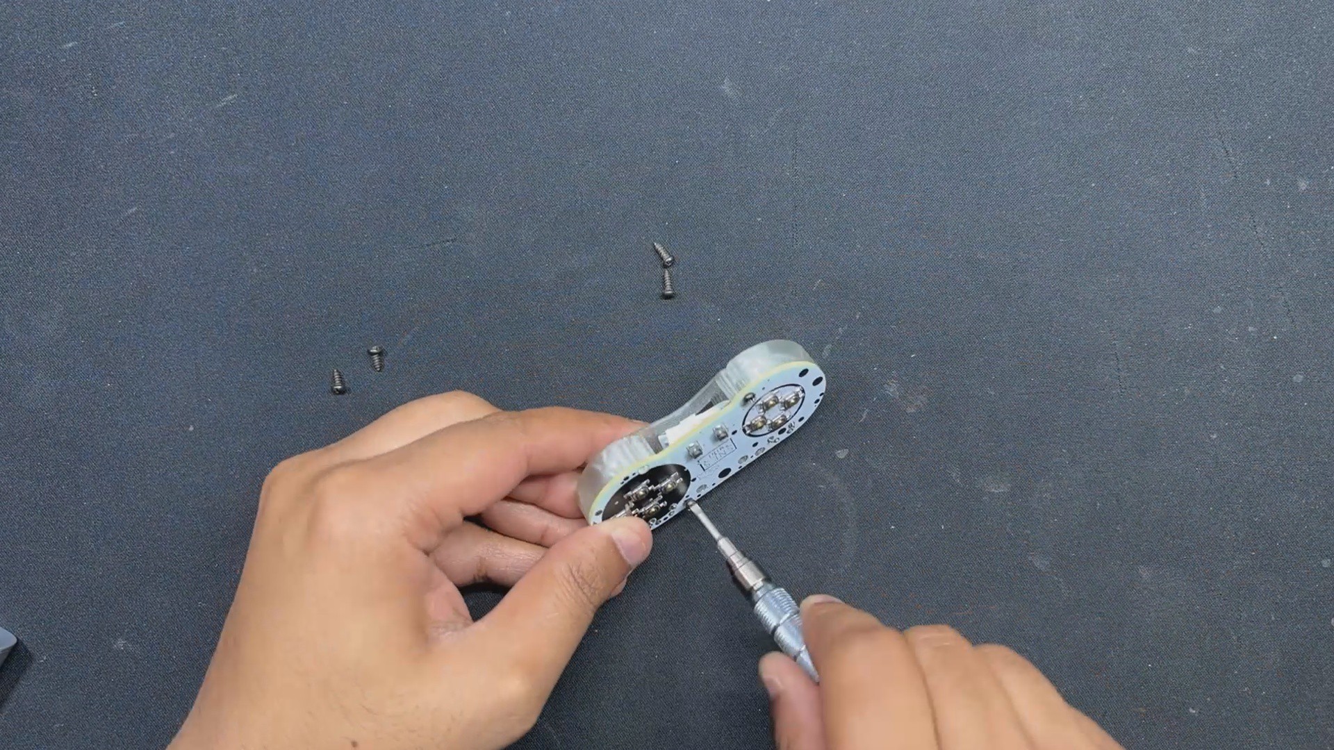

FRAME ASSEMBLY
The frame assembly process begins with passing the USB Adapter board through the Frame part, followed by aligning the circuit's mounting holes with the Frame part's.
We then use four M2 screws to secure the frame part to the circuit.
Next, place the adaptor board over the screw bosses added to the back side of the frame and fasten it in place with two M2 screws.

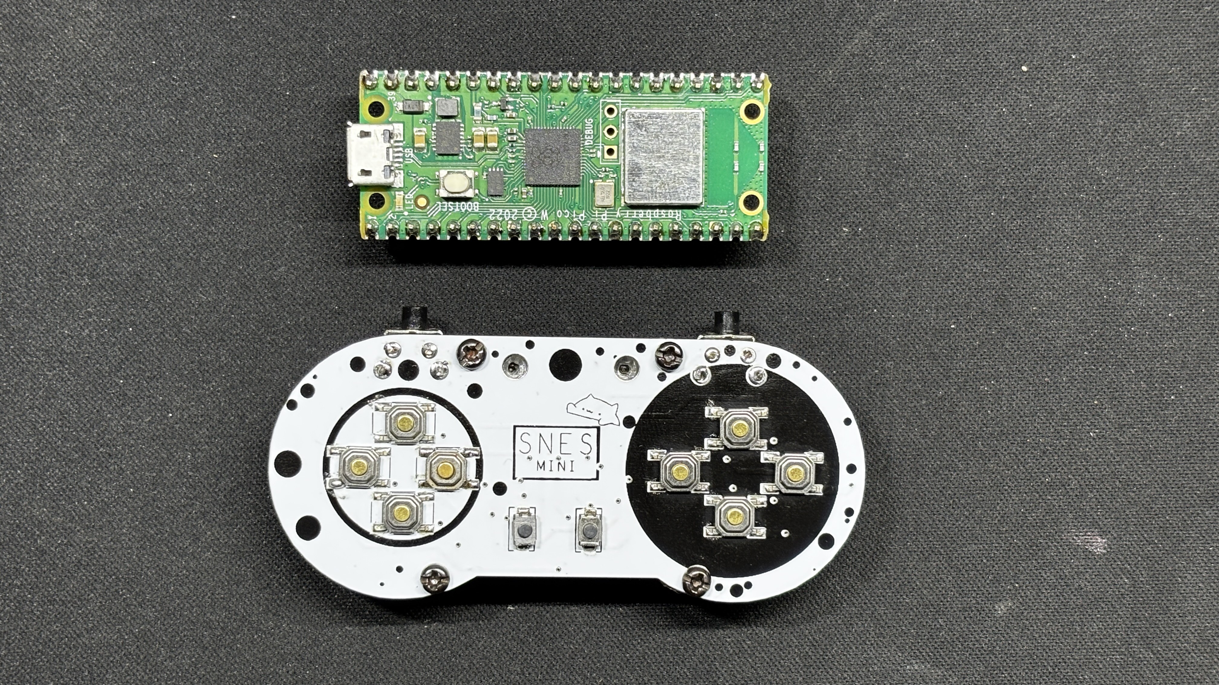

WHAT'S NEXT
The one thing I'd like to change in the next version is to replace the RP2040 Tiny with the Raspberry Pi PICO W or 2W, due to the WiFi/Bluetooth connectivity, which eliminates the need for a USB cable entirely. This will allow the device to be truly portable.
For the time being, this project has been completed, and all of the necessary details, including PCB files, code, and other information, are all attached.
