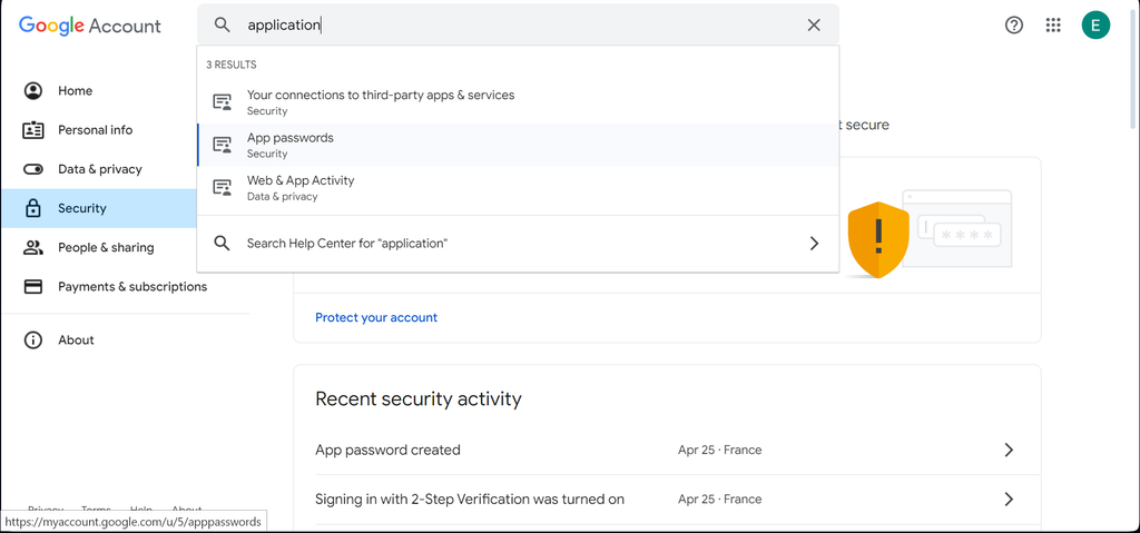

6Create a New Gmail Account for ESP32
To be on the safe side, I advise you to create a new gmail address. Then, to make access to your account more secure, we're going to create an application that will generate a 16-character code for you to copy into the program.
