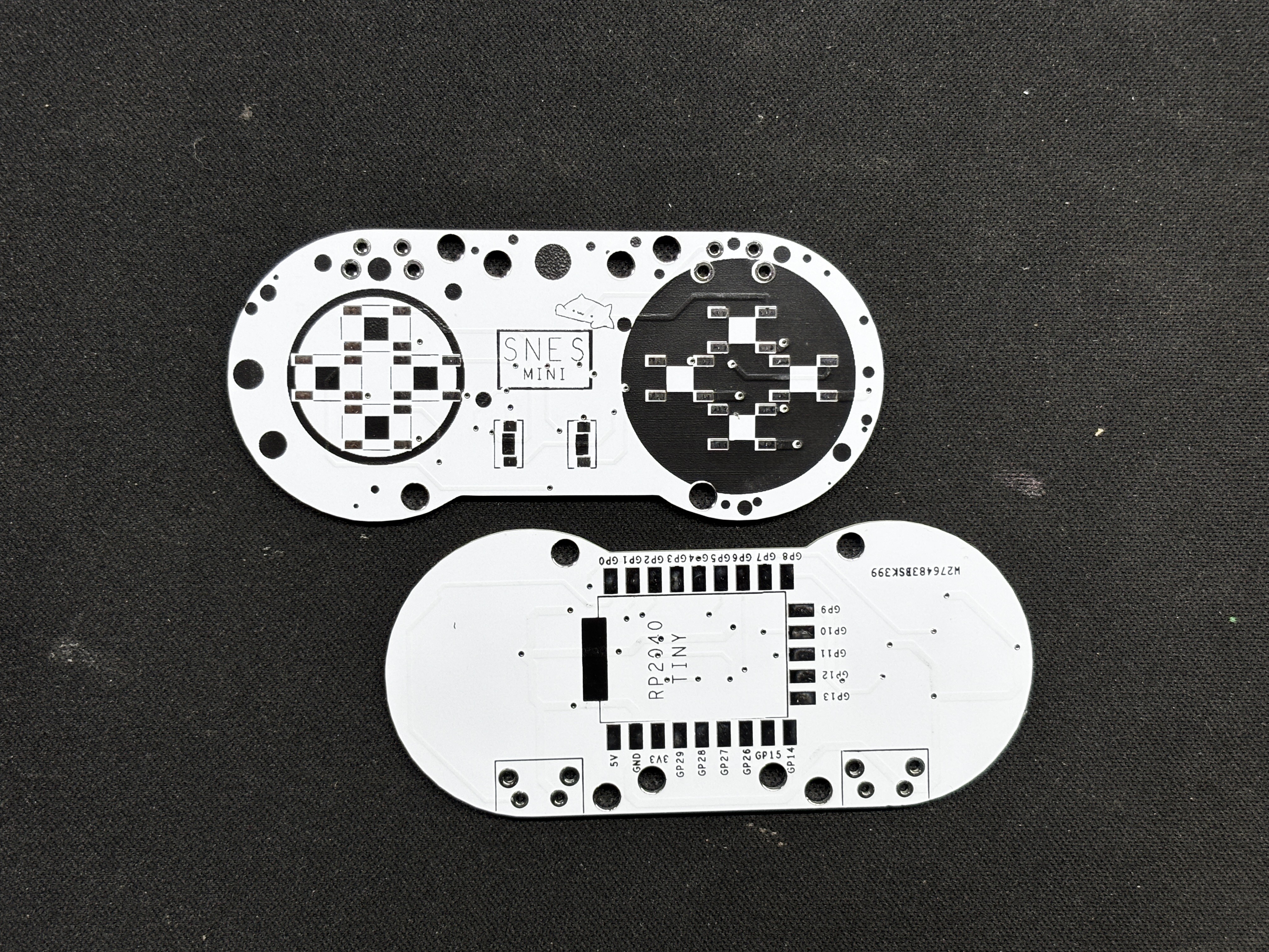

PCBWAY SERVICE
For this project, we are reusing the SNES Mini PCBs provided by PCBWAY. The order was placed for a white solder mask with a black silkscreen PCB.
PCBs were received within a week, and the PCB quality was outstanding. Here, we added a few design elements on the board's silkscreen layer to increase the aesthetic appeal of the project. PCBWAY made the custom layer properly, which shows their great PCB manufacturing capabilities.

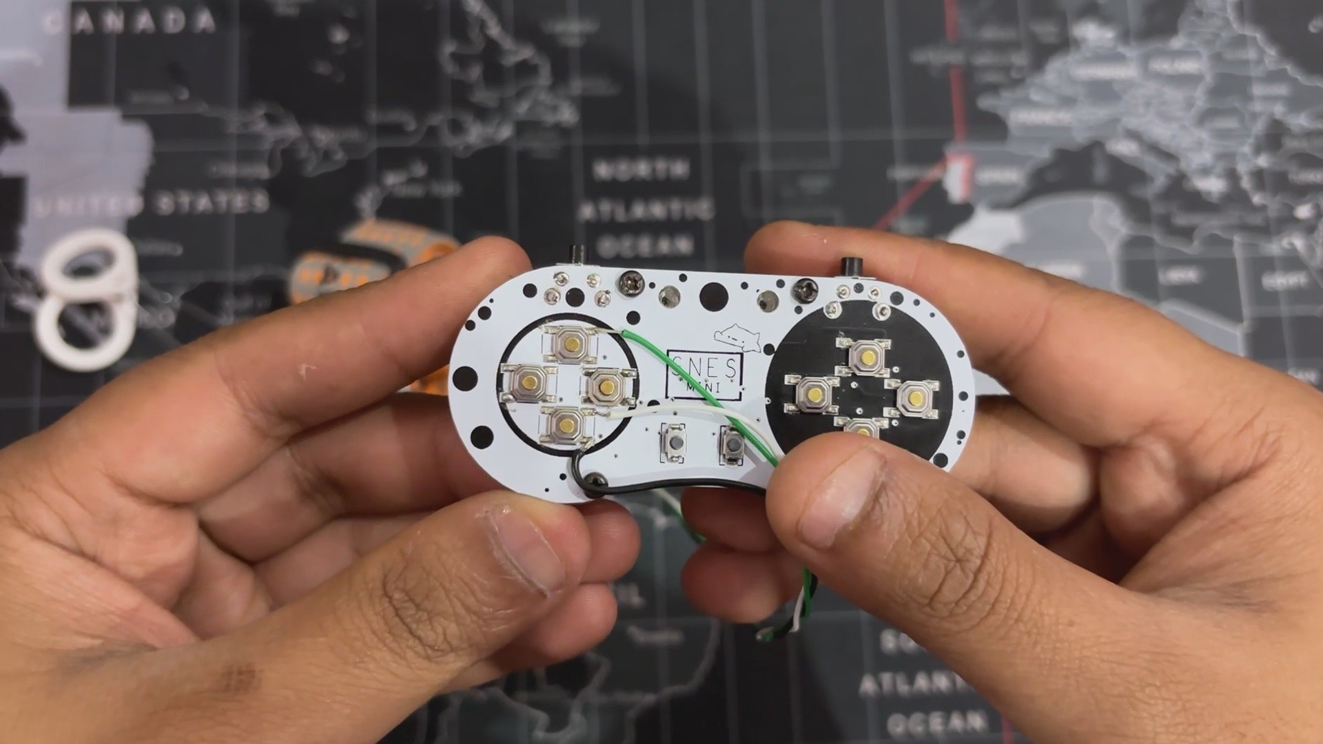

    PAIRING WITH SNES CONTROLLER
    This is the main section of the project, which involves connecting the limit switches to the SNES controller.
    • We begin by soldering connecting wire to the first Limit switch's COM and NC terminals. We then route the wire through the opening on the back side of the holder and install the limit switch in its place.
    • We then repeated the process with the second Limit switch, connecting one wire to the COM terminal and then to NC, but this time we added a single short black wire to the COM terminal, which will be connected to the first Limit switch's COM terminal. This will link both limit switch COM terminals in parallel, allowing us to connect this wire to the GND of the SNES controller.
    • The three wires from the limit switches (COM, First Limit Switch NC, and Second Limit Switch NC) are connected to the SNES controller buttons. We connected a COM wire to the GND terminal of the SNES Controller. The first limit switch NC wire is attached to the left button, while the second switch NC wire is connected to the right button.
    After attaching the wires, our setup is complete; now we'll add the new code to the SNES Controller and test it.

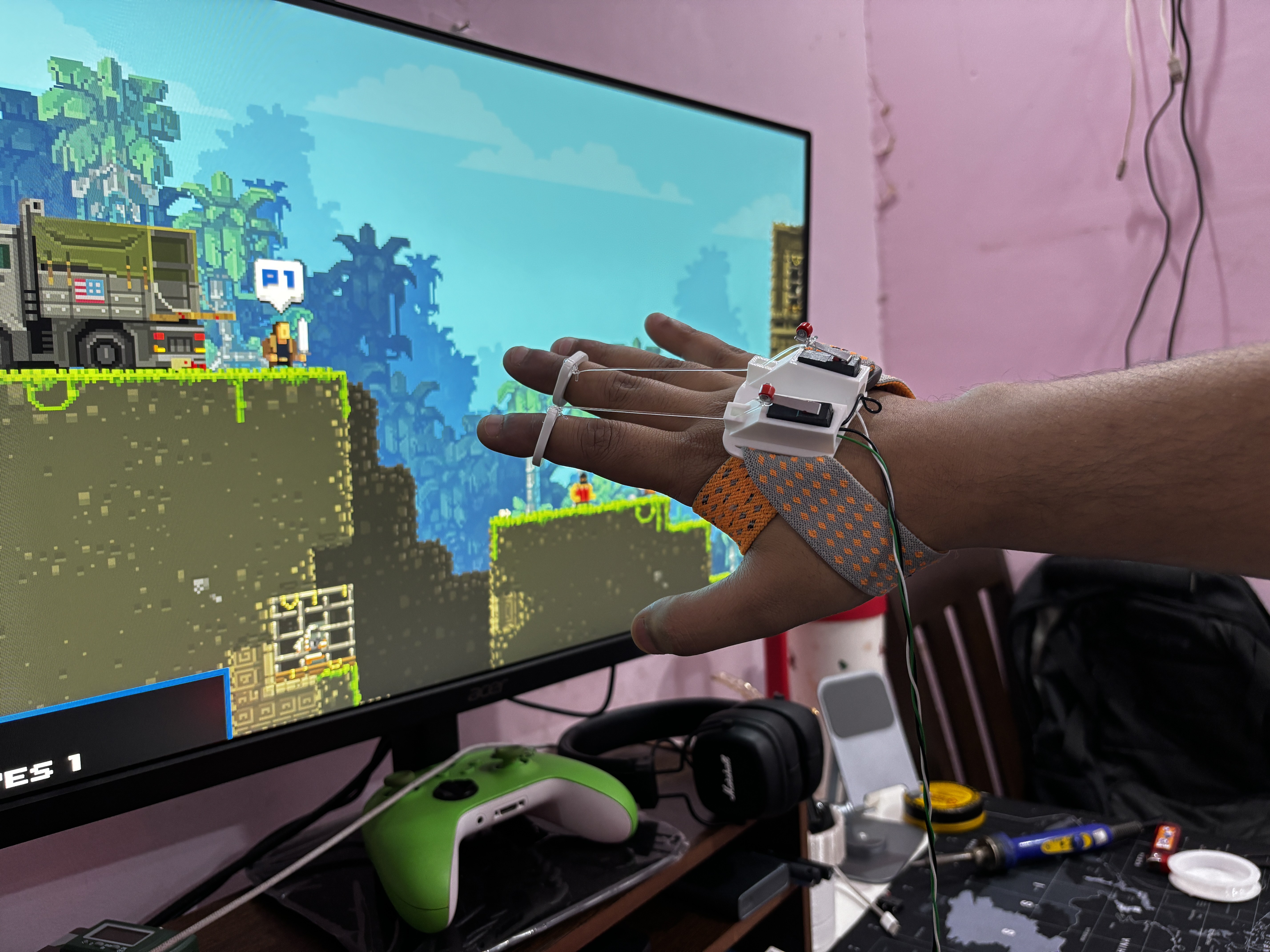

    After uploading the code into our SNES Controller setup, we utilize a website called game pad tester to test that our button input functions correctly. Using this site, we were able to confirm that our device was functioning.
  • 3
    RESULT

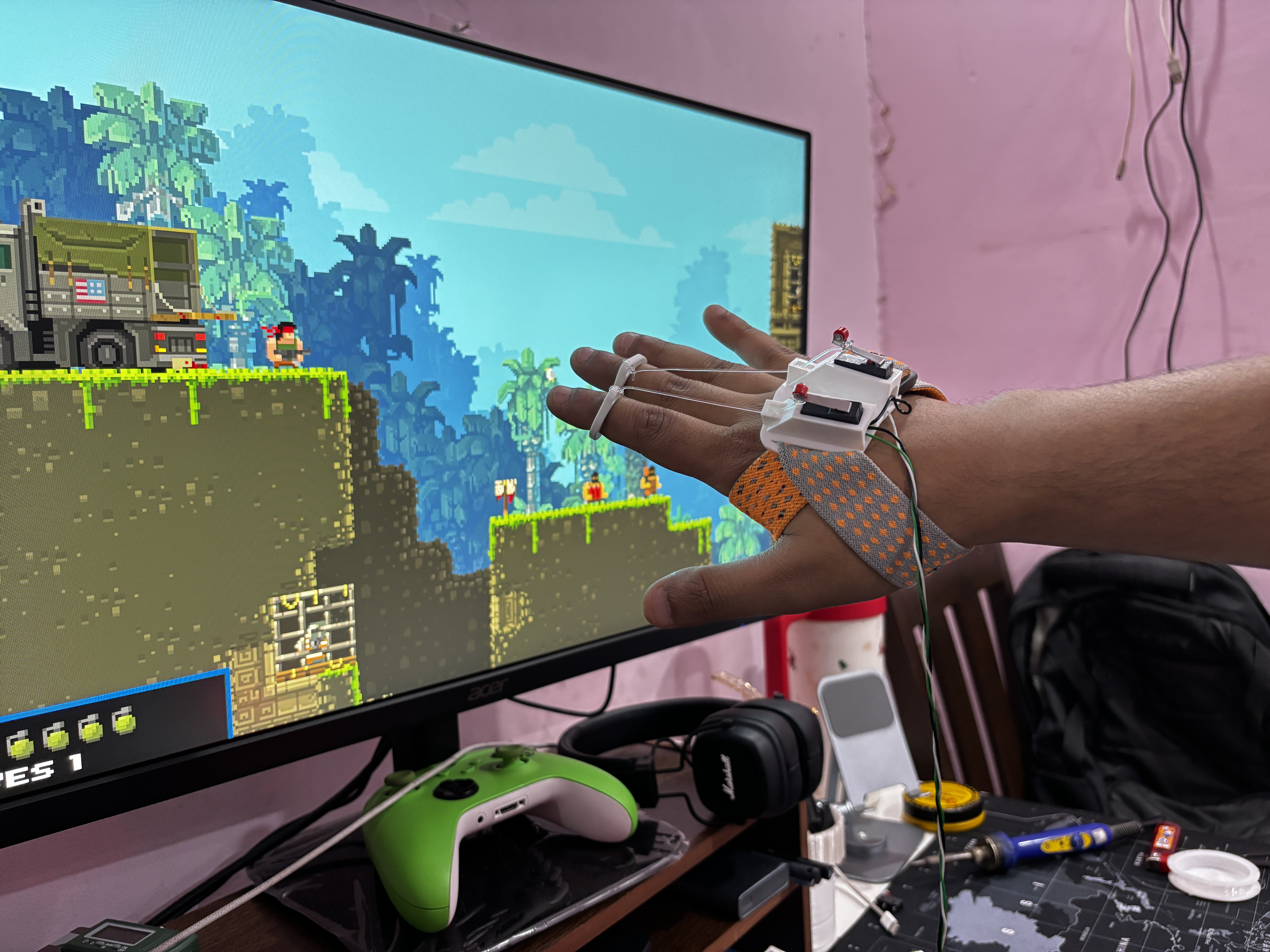

    The end result of this experimental project is a wearable game controller that operates exactly like a standard one. What's the key difference? Instead of pressing buttons, movement is controlled using finger movements.
    This was achieved through a simple string-based approach in which a limit switch is linked to a string. When the string is pulled downward, the switch triggers, pulling a GPIO pin to GND, which is detected by the Raspberry Pi Pico. This clever contraption allows intuitive movement control with only finger motions!
    To put this to the test, we opened Broforce and mapped our controller in the Controller Mapping option. We set the first limit switch to move backwards and the second to move forwards.
    We could control our character's movement with both fingertips, effortlessly moving it forward and backward. We couldn't use all of the features because the setup only had two buttons, but for an experimental project, this demonstration was ideal.
    This Project was a success!
