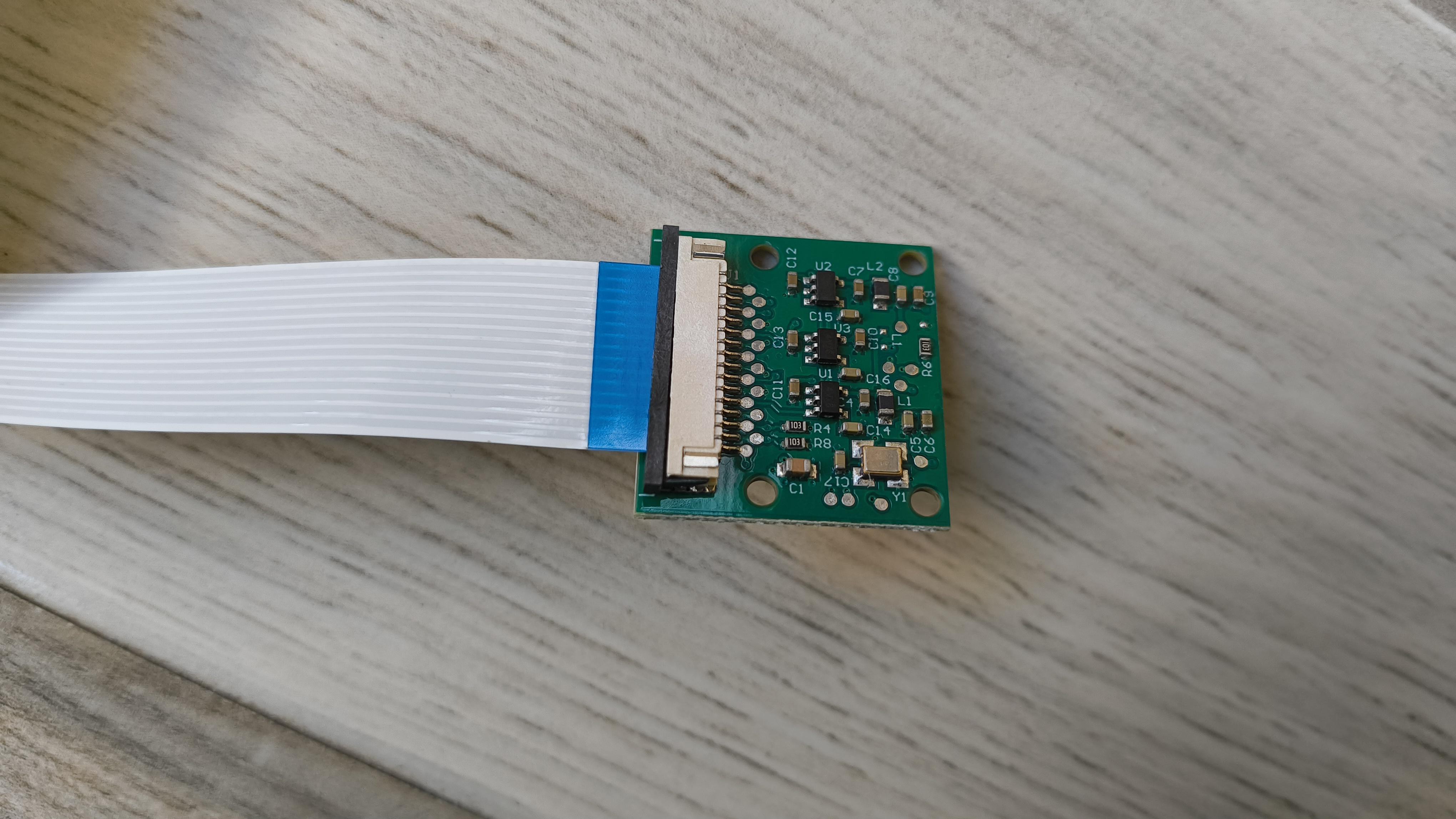

    To get started, I connected the cable to the AI module as shown here.
    Next, I plugged the other end of the cable into the Raspberry Pi camera, as shown here.
    Now we’re ready to start uploading the model.

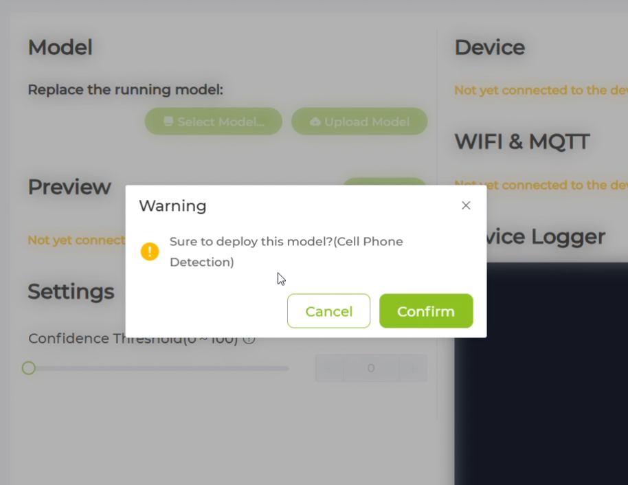

    Upload the AI model

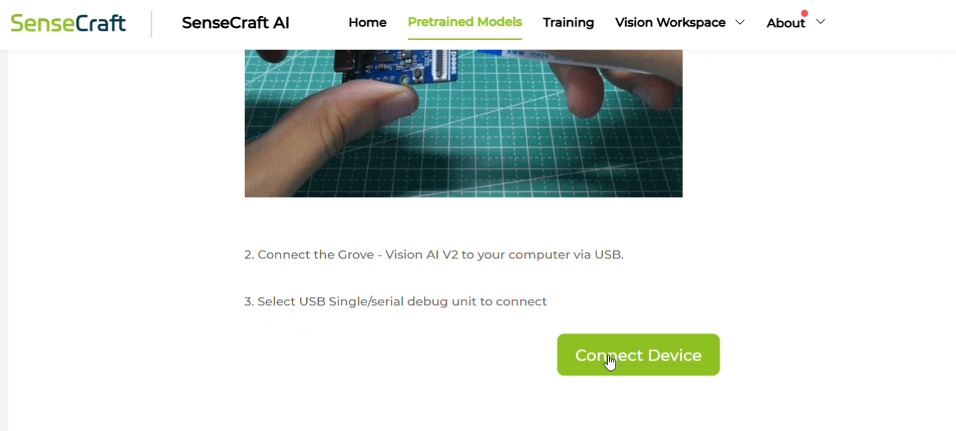

    I went to the Sensecraft AI models page and searched for "cell phone detection."
    This website contains pre-trained models that can be uploaded to the Grove AI module. If you don’t find the model you’re looking for, you can even train your own by uploading images of specific categories. However, for this use case, I found a suitable model already available on the site.
    If you’re following along, make sure to use only the models designed for the Grove Vision AI Module v2!
    Next, connect the AI module to your PC using a USB-C cable, and click "Connect Device."
    Your browser may prompt you to choose a device—select the correct port (there should only be one) and confirm.
