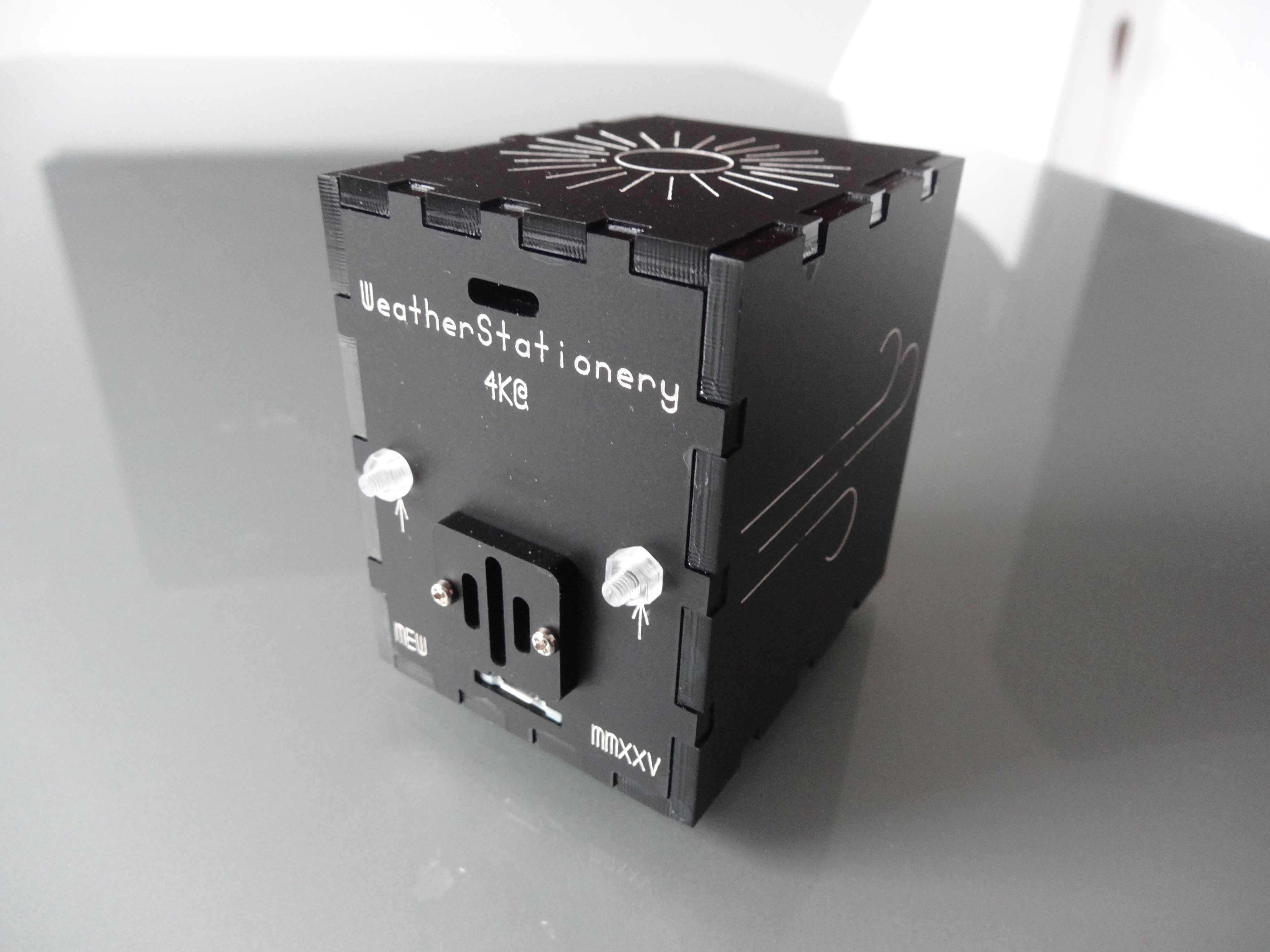

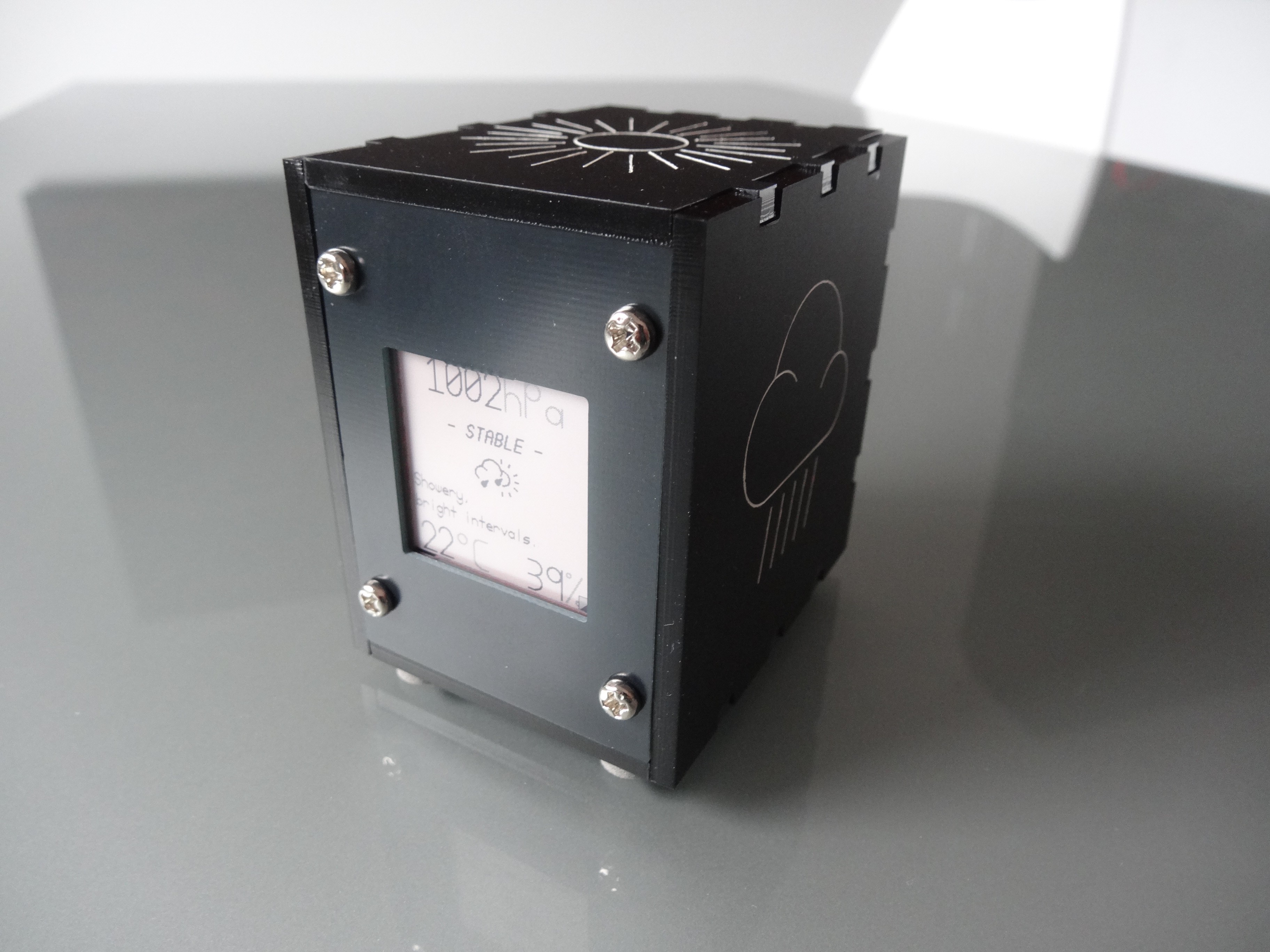

The enclosure is a laser-cut acrylic cuboid.

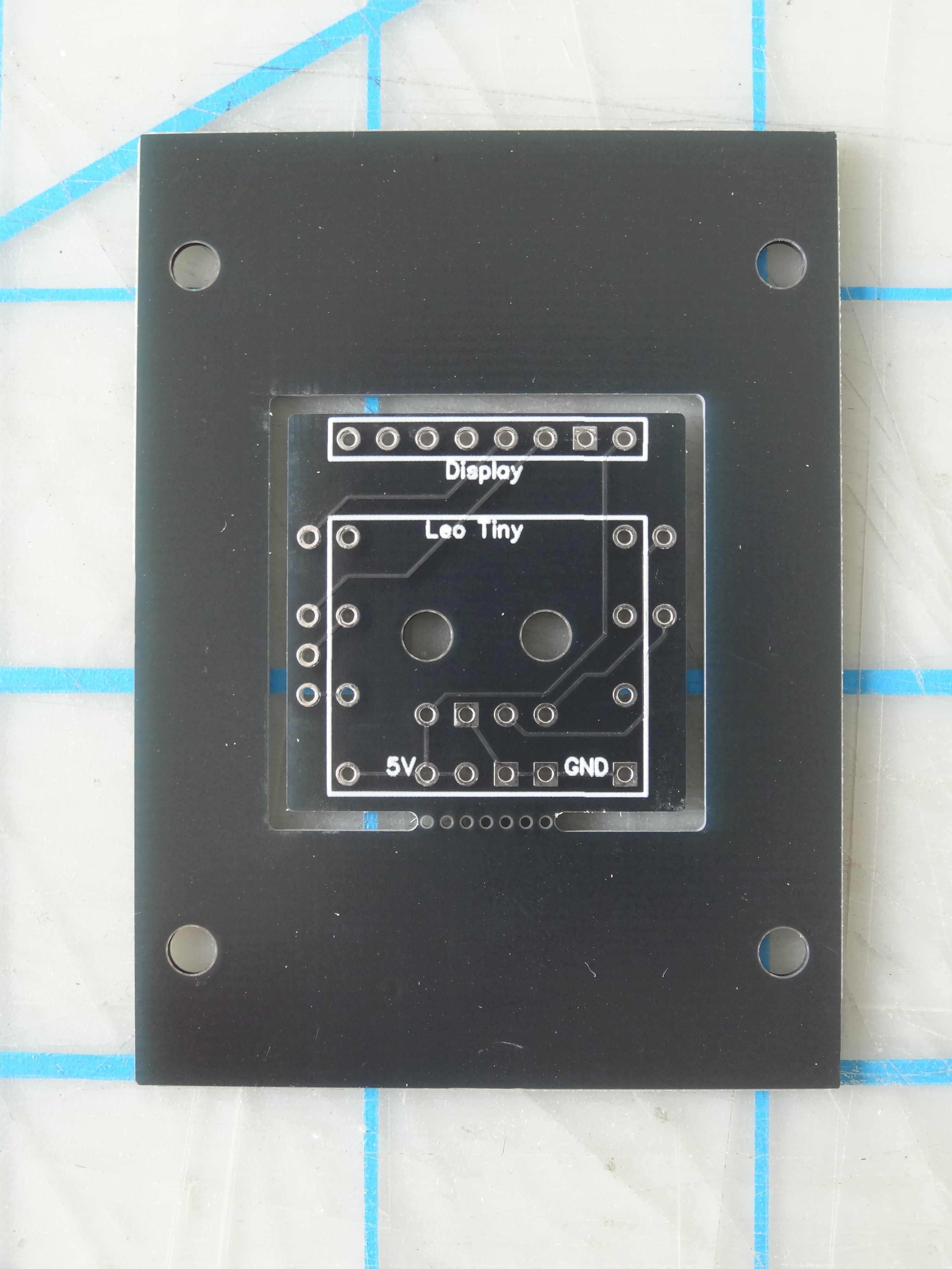

The front face is a PCB with a window in it. The space occupied by the window is a tiny board to hold the components. Using the PCB meant the display was less recessed into the enclosure (the acrylic is ~3mm)
Starting from the top of the display:
- The current pressure is shown in hPa (or inHg)
- The pressure trend (rising/falling/steady) is show, or N/A.
The current pressure, optionally reduced to sea level, and the pressure trend are used to infer a "forecast" by emulating the Zambretti Forecaster. This reuses code from my Chrondrian project.
The result is a forecast letter from 'A' ("Settled fine.") to 'Z' (Stormy, much rain."). This range is mapped to an icon in (Sun, Cloud/Sun, Cloud, Cloud/Sun/Rain, Cloud/Rain, Cloud/Lightning).
- The icon is shown.
- The descriptive text corresponding to the forecast letter is shown.
- Finally, the temperature (C or F) and the humidity (%) are shown together.
A sensor reading (from a BME/BMP280 or an SPL06/BME) is taken every half hour and the display updated. The pressure trend is over 3 hours (6 readings). Prior to having a trend, it and the forecast are shown blank or N/A, but optionally, a random forecast, greyed out, can be shown, for entertainment.
In general, the forecast should NOT be taken seriously!
The display is XC3747. NOTE it only works with display variants that work with the epd1in54b sample. See "Manual" and "Software" on the Jaycar site.
The sensor is, for example, XC3702

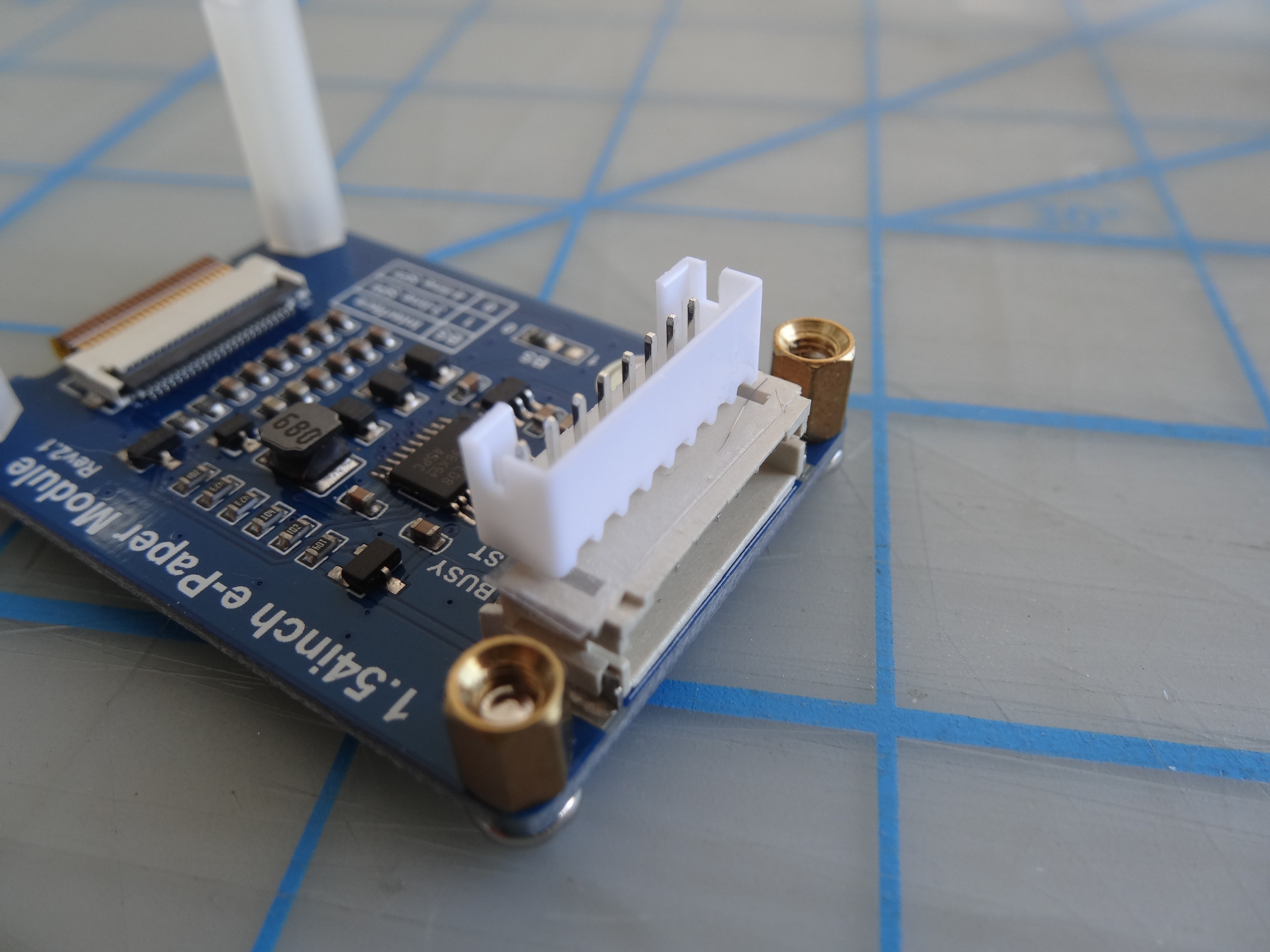

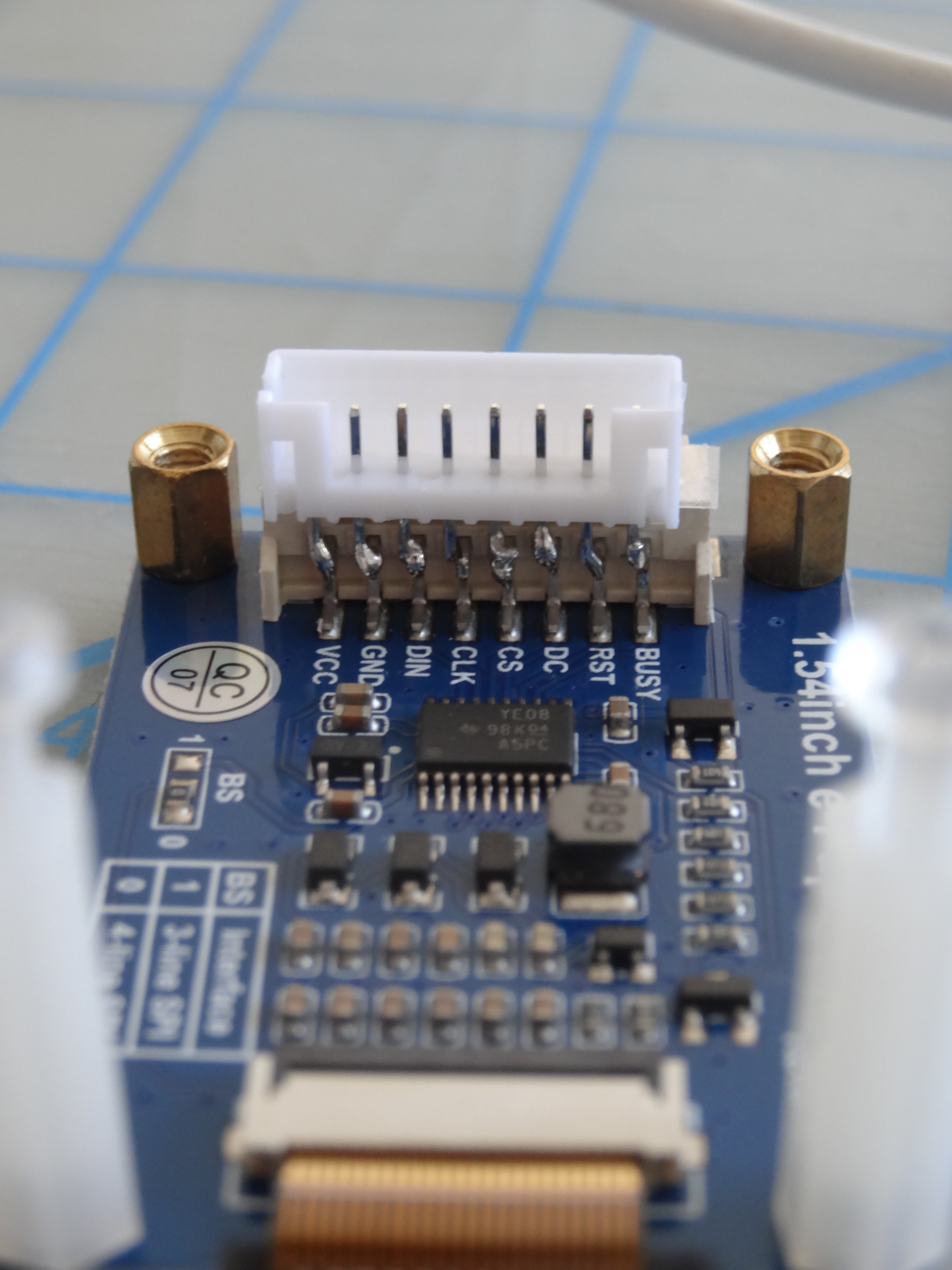

The display came with an awkwardly placed connector -- pointing straight up (beige). I wanted to make something compact so I soldered another connector pointing backward (white):
A tricky job, and it shows in the quality of the soldering:

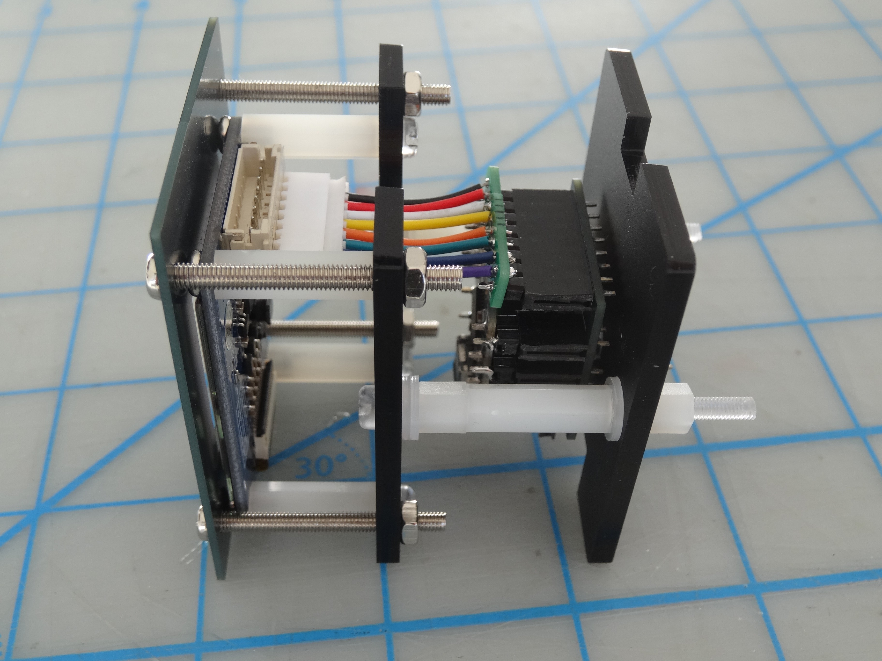

But it worked and I build a stack to go inside the enclosure with a cut-down cable between boards:
From the left is the PCB front-face, the display, an intermediary laser-cut acrylic support, the main circuit and another support.

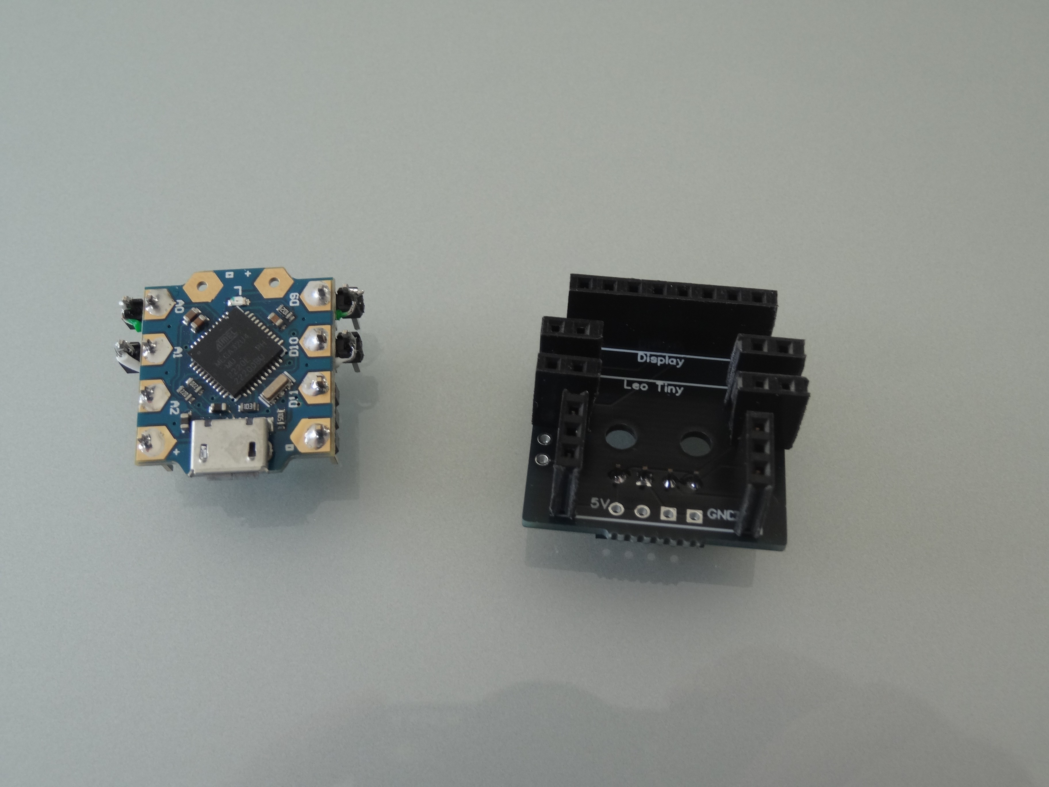

The main circuit is a "Leo Tiny" Atmega32U4 with the I2C SDA/SCL and ICSP MOSI/SCK pads on the underside soldered to wires going to protruding pins which are socket-ed on the board:
The enclosure is quite complex, written in Python using...
