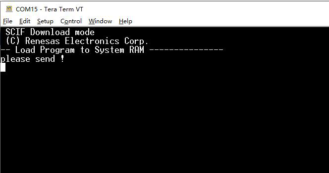

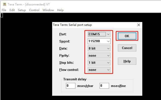

Switch the dip switches to the USB Download mode (OFF/OFF/ON/OFF), connect the devkit using the USB-TTL cable to J15 interface of the development board to the USB of you PC.
Setup Teraterm like that:
And a message like that will be shown:
We need to send this file from build directory : Flash_Writer_SCIF1_RZG2L_SMARC_PMIC_1GB_DDR4_1GB_1PCS.mot

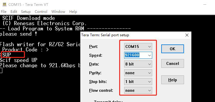

When it's done you will see a prompt waiting for command.
Type SUP to speed up the serial's baud rate and set the speed accordingly.

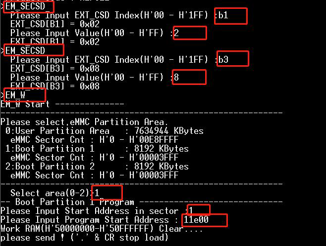

Now, it's time to configure some registers for eMMC in order to set it as the default boot device.
Type the following commands and values when asked:
With command EM_W we will start the write process on eMMC, Type the above values and when asked send the file bl2_bp-myir-remi-1g_pmic.srec
Next, we should do the same for fip image/u-boot/BL31.
Send the fip-myir-remi-1g_pmic.srec when asked.
After wiping the bootloader to the qspi, power OFF, reset the dip switch to start eMMC(OFF/OFF/OFF/OFF), set the baud rate back to 115200, power on and start to the uboot.
