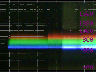

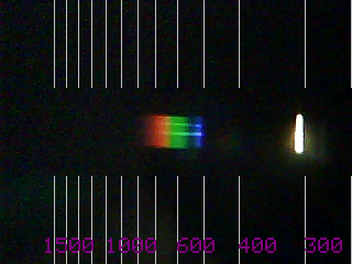

    With the addition of calibration it is possible to have a graticule, and now those have been added to 3 views.  A crude level of image processing has been added to help merge images and metrics together.  A proper system menu now exists,  You can now set the the time and date.  A change has been implemented to better handle power-off detection for the RTC.  Added the concept of a "UICard" to combine screen-to-screen navigation and other facilities in a common base class, reducing code.  "close" function for the views seems to work stably, providing another means to reduce code requirements a little.

    Many pieces of UI later we now have the ability for the user to manually calibrate the spectroscope.  Calibration was performed with  LEDs, the spectroscope, and a DVM.  The voltage across the LEDs provides an approximate value for the energy of the generated photons.  Converting from volts of nm of wavelength provides the ability to perform a basic level of calibration.  The calibration process deserves a separate writeup given the UI-intensive nature of this feature.

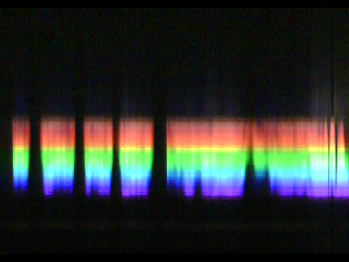

    Added a waterfall view of the spectrum data.  This image is the morning light coming in through the window as I move the device around.  Writing these different image views is getting easier as the framework layers (system/UI/application) develop and mature.  The screen shot is captured by doing a long press on the screen.  Original attempts to save images to SD cards ran into some issues, resulting in two bricked uSD cards.  The ESP32 sample code for a web server allowing file access went in fairly easily.  I can now not only capture screen shots, but also access them from a web browser.  Since that last round of code went in via an ad hoc fashion there is a bit of code re-work to be performed, and UI needs to be added to allow configurability of the network settings.  I did find out the hard way SSID is case sensitive, which feels like a potential security vulnerability as that leaves open avenues for spoofing and confusion.
    After this round of changes I may pivot towards calibration configurability so the spectroscope can graduate into being a spectrometer.

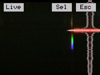

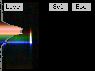

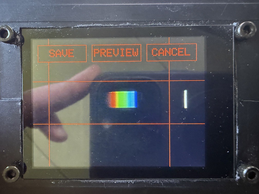

    Added a tool to configure which portion of the camera feed to pull the spectrum image from.  The spectrum is sampled from the horizontal center line (not depicted).  This bit of functionality took longer than expected due to running into some heap corruption issues.  Non-obvious is the impact on the framework code underlying the application.  So far there is no serialization for the settings, hopefully this will change soon enough.  The current code has been committed to github
