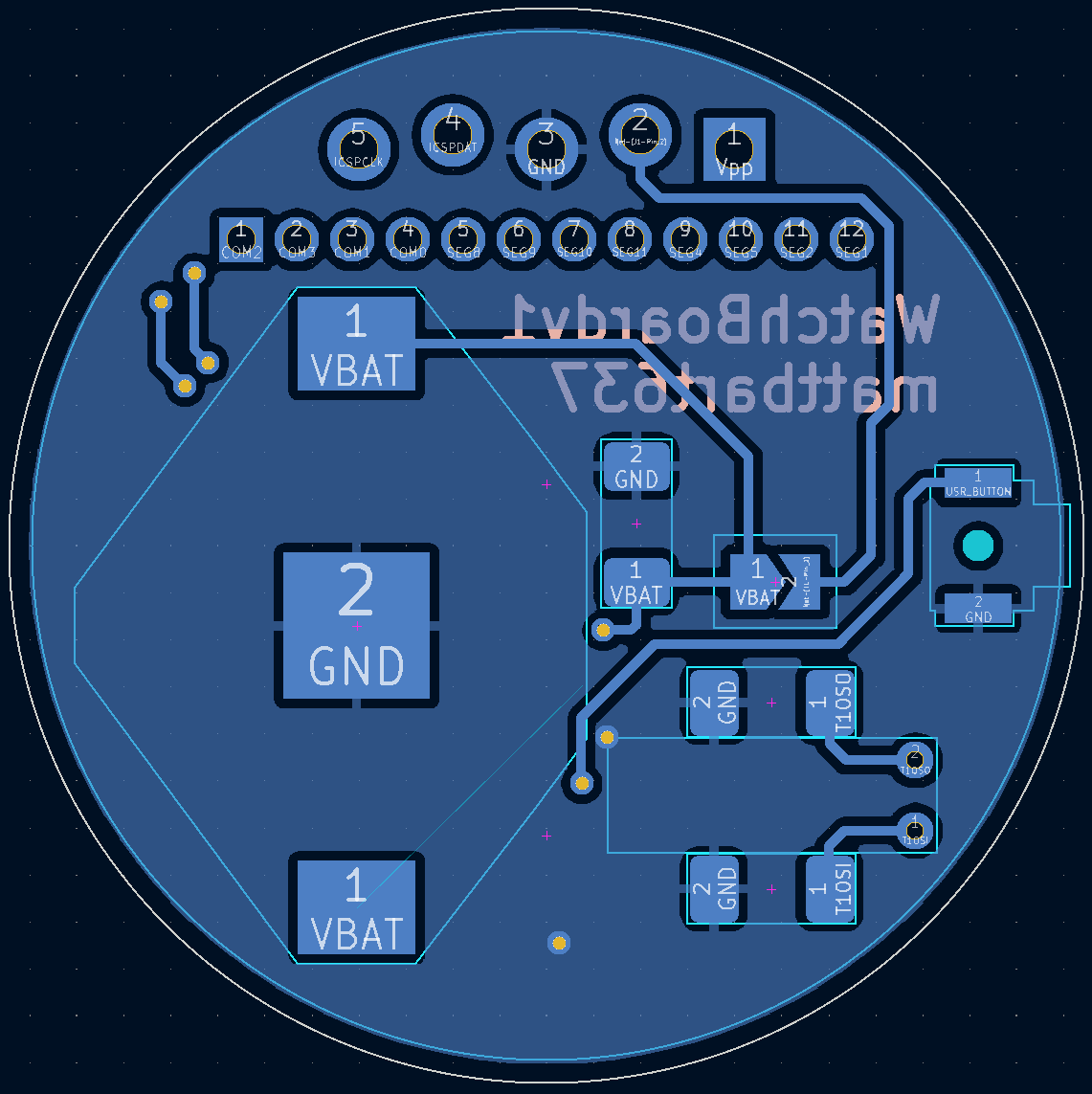

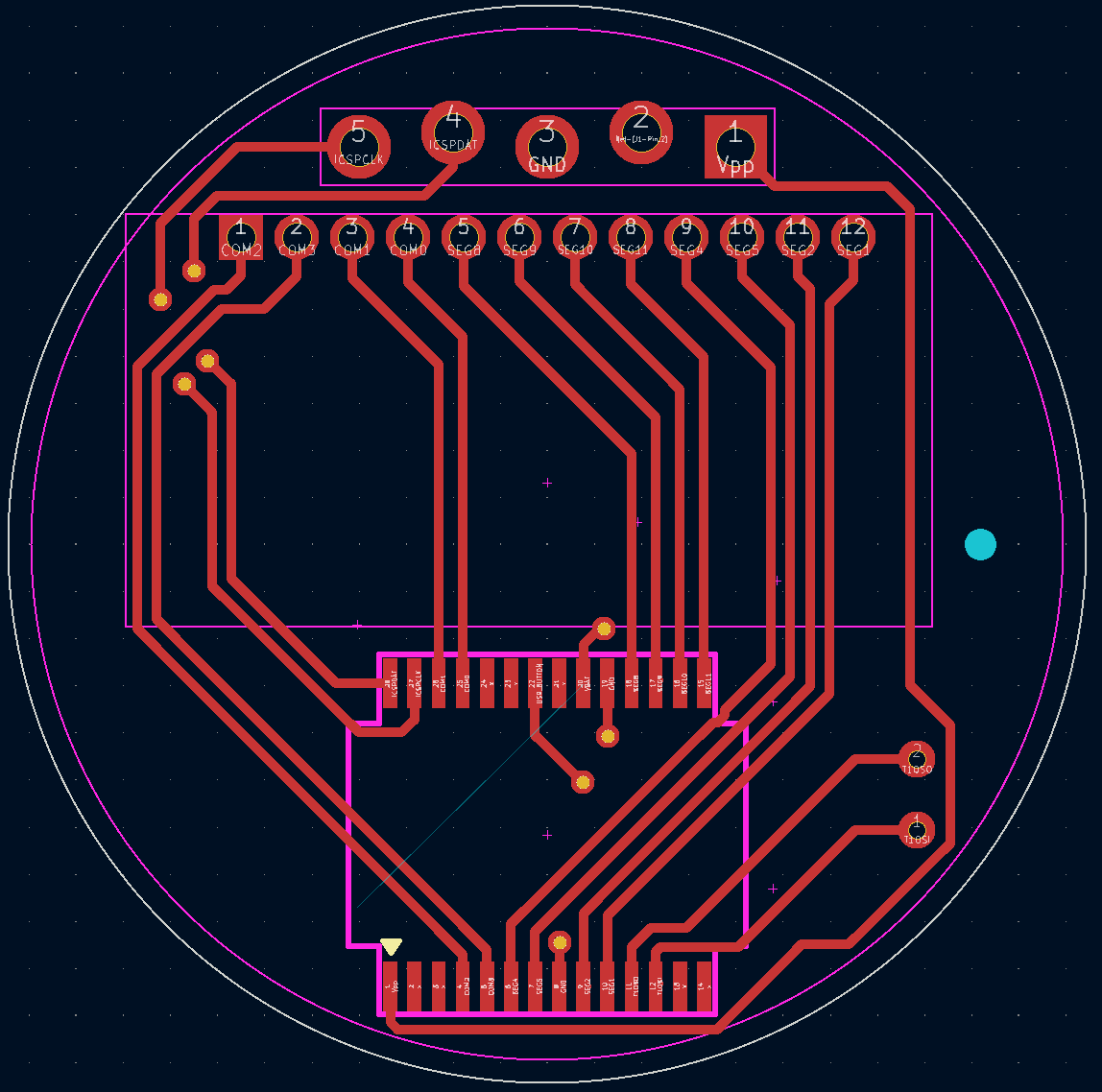

Board Layout
Since this is a watch, component placement was primarily driven by what I thought looked nice. That means only the PIC16 and LCD on the visible front side, and centered of course.
One tip I picked up from the Microchip dev board: the through holes for the programming header are staggered. It creates enough friction to hold a 0.1” pitch header in place for programming without having to add any extra features.
I designed some quick 3D-printed spacers to hold everything in the watch case at (mostly) the correct height. These were easily my least favorite part of the build. I hadn't built any anti-rotation features into the PCB, so the spacers have tiny features that register in the through holes for the programming header. I knew I'd have access to the DLP printer at my workplace to get myself out of trouble (and it did) but wish I had better planned this.
If I order more of these boards in the future I would include a keying notch to make the prints easier,...
