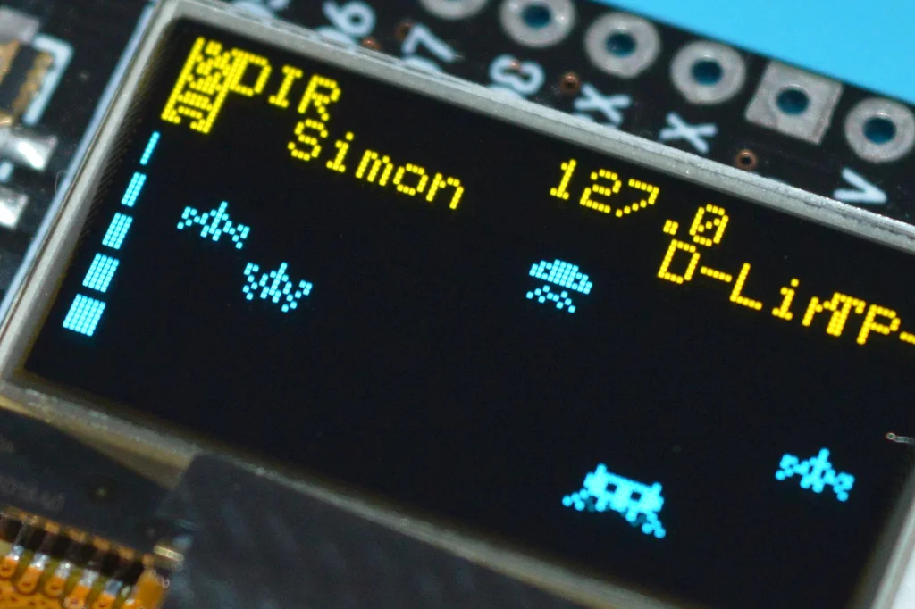

I used a board with an embedded OLED display. Various versions of such boards are sold everywhere under different brands.
⚠️ The two boards I tested were marked HW-364A and HW-630. They had slightly different hardware; in particular, they used different pins for the OLED display, so check that carefully.

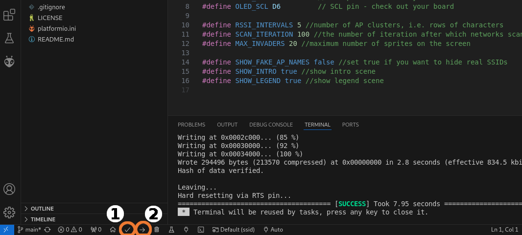

3Tuning the Code
Open the config.h file and set up the settings if needed. In particular, you should change OLED_SDA and OLED_SCL according to your board. I have provided detailed comments on the other options you might want to tune.
4Building and Uploading the Firmware
Press Platformio:Build and then Platformio:Upload button to upload the code.
