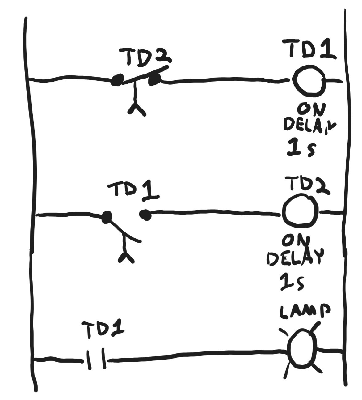

But remember, you’re just a lowly controls engineer. You don’t have time to design a 555 circuit, and your boss don’t care ’bout no nanoseconds. You have access to industrial control parts from the likes of Rockwell Automation, Siemens, and Square D. McMaster Carr, Grainger, and Automation Direct are also great places to look.

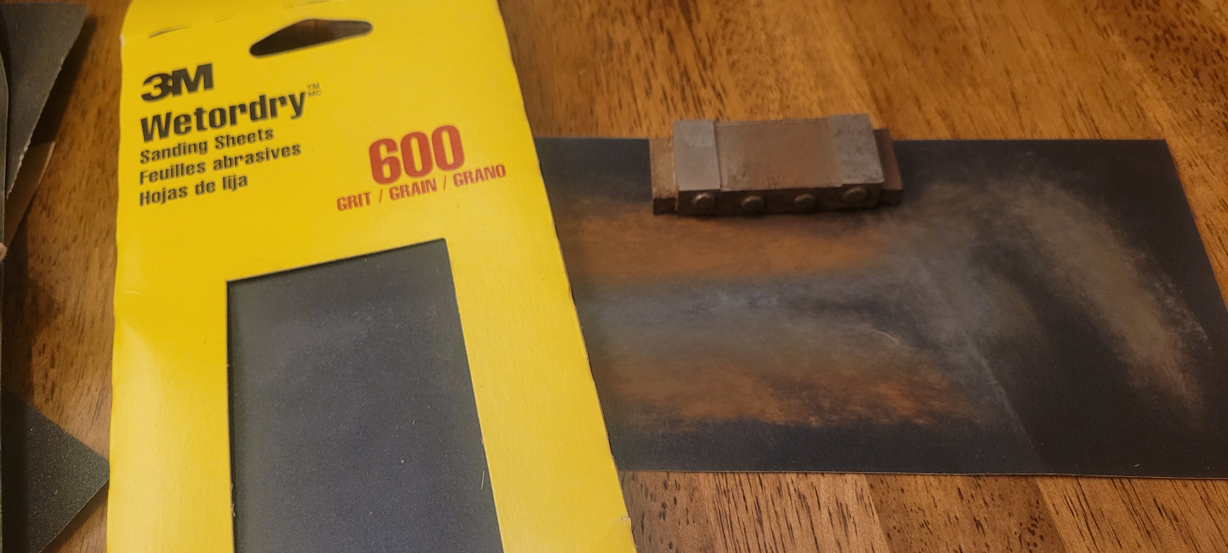

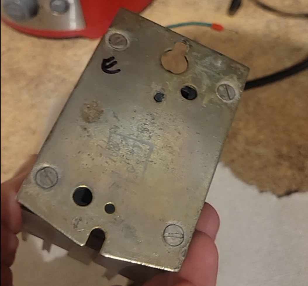

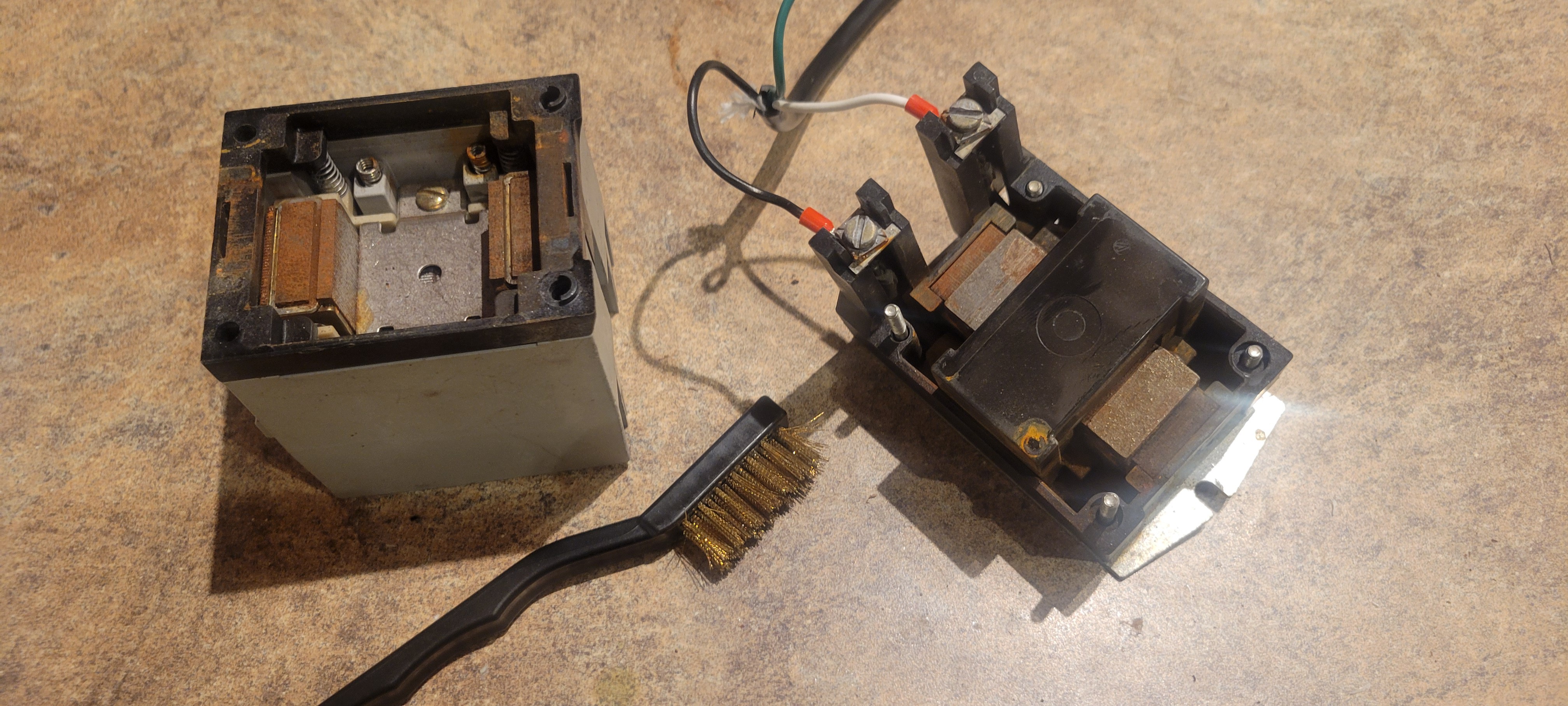

Your basic building block is a relay.
We can use two on-delay timers to make a light flash.
